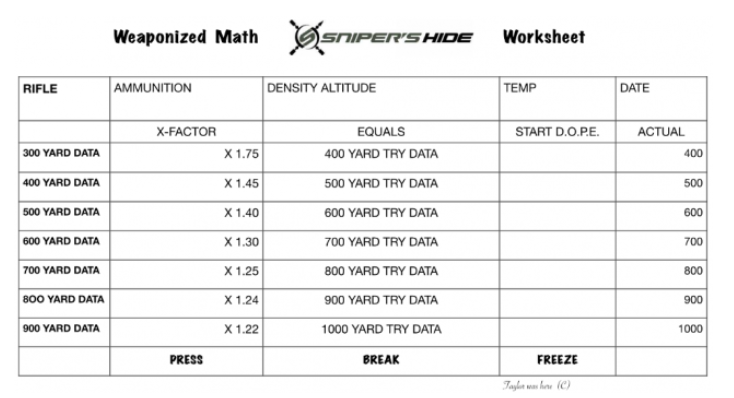

Since you will likely have none of that info you can try and work your way out to distance with the weaponized math system that takes prior known info and applies a factor to try and let you time the bullets fall to gravity so you at least have some good assumptions of where to go based on where you hit previously.
It may not get you centered up on target but it should at least get you on the berm enough to see your misses to make a small corrections instead of blindly hoping.

Since you will likely have none of that info you can try and work your way out to distance with the weaponized match system that times your bullets fall to gravity and apply a factor to try and let you at least have some good assumptions based on where you hit previously.
