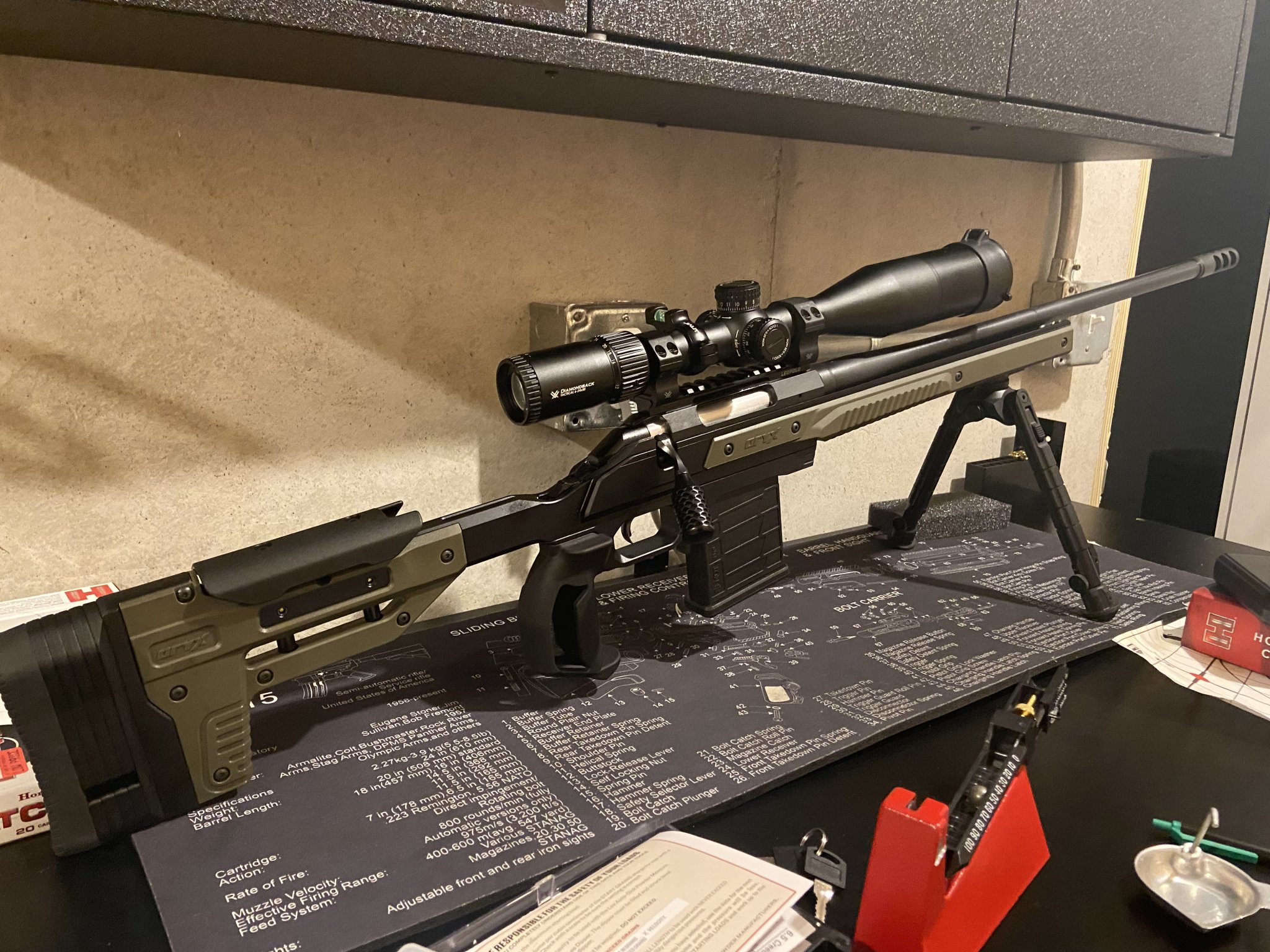

Currently in an oryx chassis. As for trigger and I’ll probably be lit on fire for this but I like the factor trigger. I got a spring off eBay and put it and according to wheeler digital trigger puller I’m getting 1lb 12oz pulls consistently. Plus or minus an oz. I’m used to running cheap junk annd have no experience with expensive stuff. Attached is a photo of my setup. Only difference is I built my own rear bag rider, got knobs for the cheek riser, and I ditched that muzzle brake and got an APA little bastard. My setup isn’t nothing compared to most folks on here but it’s what I can afford. Waited for a lot of it to go on clearance or big sales.

If you put a Timney centerfire trigger in it, and adjusted it all the way down, as light as it goes, you’ll hate the factory trigger, and you can get one under $150…
This is a huge improvement that you don’t even realize you need. It’s not all about the pull weight…Creep, overtravel, break, etc… will all play a part in consistency with your groups.

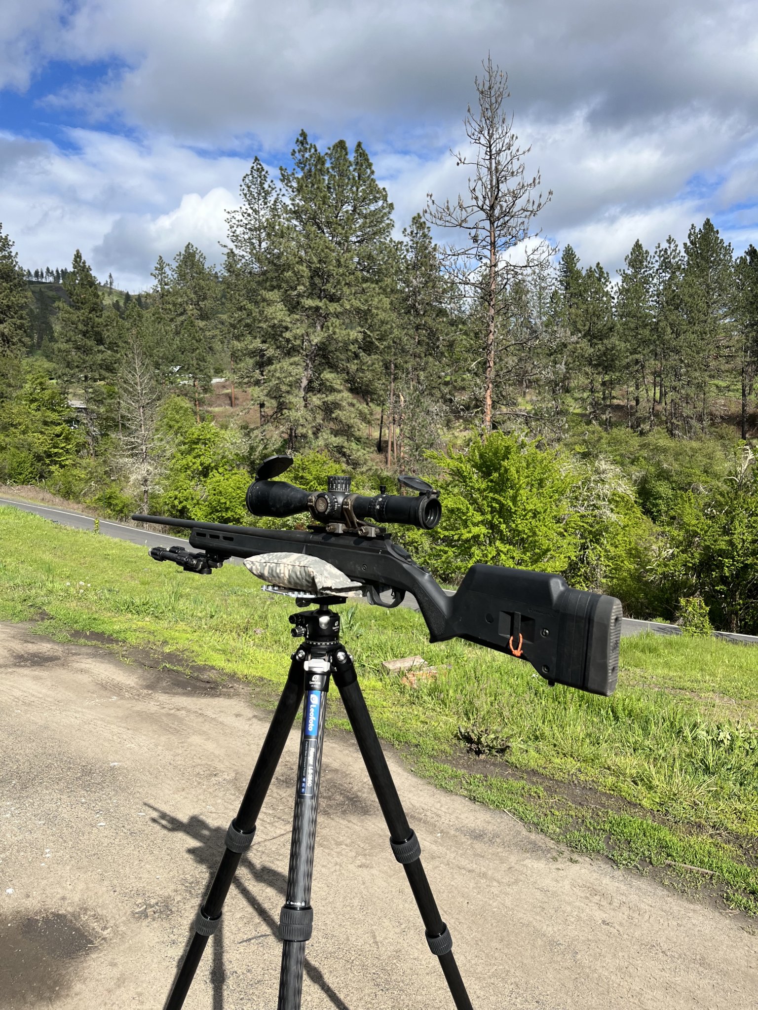

Don’t bash on the ruger American. It’s not a bad rifle. This is mine is a 308 on a magpul stock. It’s a good rifle. Shoots good and has a good trigger. Mine has a 5-25 atacr on it. I’ve done the gravity ballistics out to 700 with great results. My advice-save the money or spend it on ammo and go shoot more. I used to have a ruger m77 in 270 that I was easily getting sub moa mostly due to the fact that I shot that thing ALL the time.
