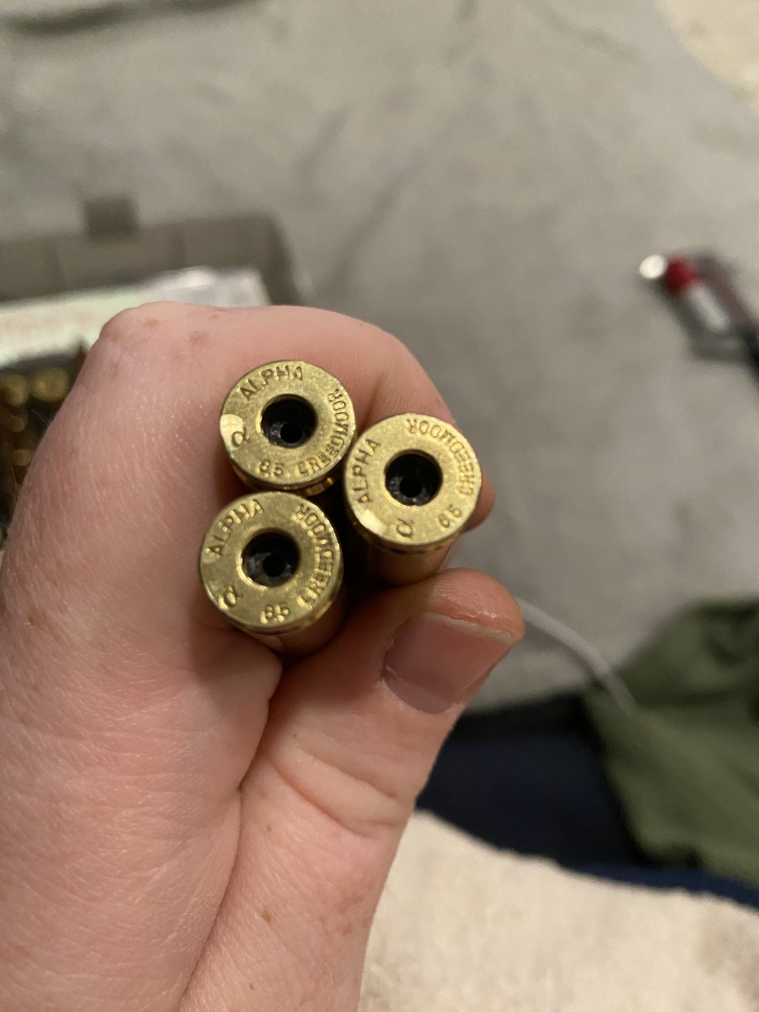

So my Ruger American gen 2 is leaving ejector marks on what I would think are mild loads. The ejector seems to stick up higher than my other bolt guns (including gen 1 American) and seems pretty stiff too. I got these marks on
UPDATE WITH VELOCITY:
20” Odin Works Both 123gr hpbt:
IMR 4895 (38.8gr 2775, 39.2gr 2828)
Staball Match (39.5gr 2813, 40gr 2841, 40.5gr 2879)
I took a couple coils off the ejector spring and ran this test again. No ejector smears, although I know I am too hot with the top Staball load, which is .2gr under Hodgdon max.
Both 123gr hpbt:
38.8gr IMR 4895
39.5gr Staball Match
I did put the barrel on myself but headspace seems to be fine. With Hornady headspace comparator: new alpha brass: 1.533”
Fired brass: 1.536”
So it’s expanding three thou from factory alpha
Could something be up with my ejector? Or does my barrel just run hot?

What about loaded neck dia before and after?
I am suspicious about how you set your headspace on the barrel. IF you used an unfired case ( and tape) to set your headspace then you really don't know if you have set it correctly.
I used a fired case
If it’s expanding forward 3thou on the shoulder it’s fine.
Were your velocities in line?
going to test same loads tomorrow and chrono them.

2900 with a 20” is certainly up there
So . . . velocity looks to be just about right, therefore I don't see any issue regarding pressure due to the amount of powder being use. Though the amount you're using for IMR 4895 looks like a low case fill (like maybe something like around 90% or less 🤷‍♂️), which normally is not a big deal at 90%, but a bit far from ideal. StallBall being a spherical powder, low case fill can have the same issue.
I'm kinda leaning toward there being a headspace issue using virgin Alpha brass with a newly installed barrel. And that low case fill with a hot primer might add to it. I'd try loading up a couple of the same loads with some other brass to see what the result is. . .
. . . but I wouldn't try factory Hornady cartridges as I've heard reports that they tend to be a little hot to start with.🤷‍♂️

I checked headspace. The issue was the extractor was a little proud and spring too stiff, as well as moisture on the cases last time out. I shot same loads again today after modifying spring and didn’t get any marks.
2900 from a 20” barrel seems to be a bit extreme to me though, but I’ve never shot the 123’s before so idk.
