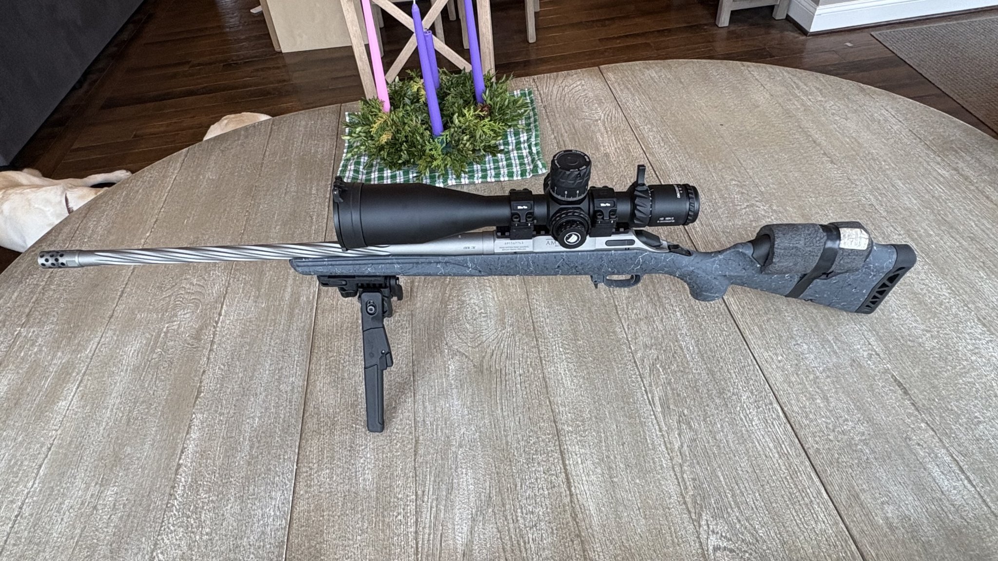

I didn't get any range photos, so here it is in the "as shoot"configuration with the piece of foam they guys gave me which helped a lot.
Here is the gun porn you all love 😆
