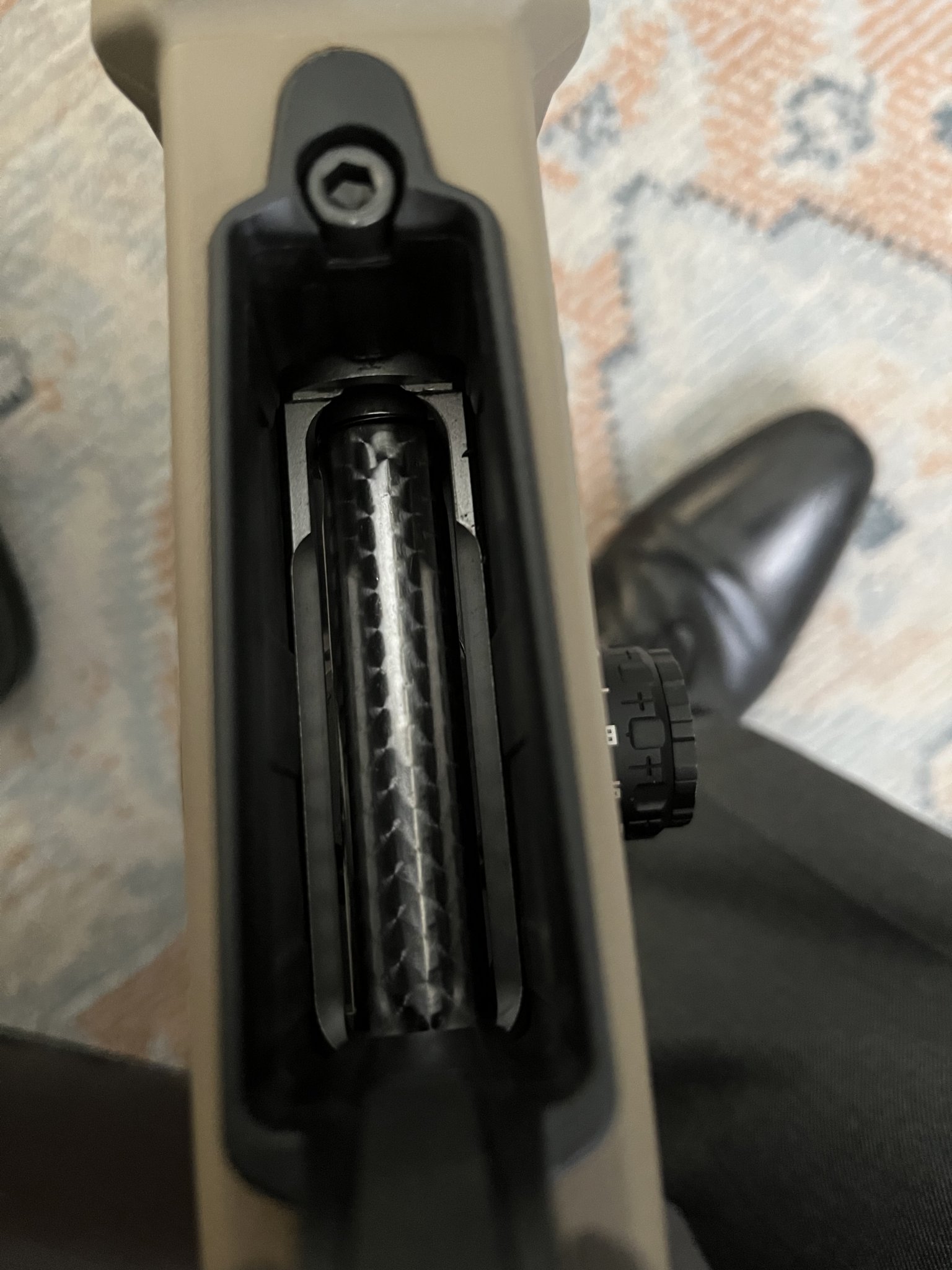

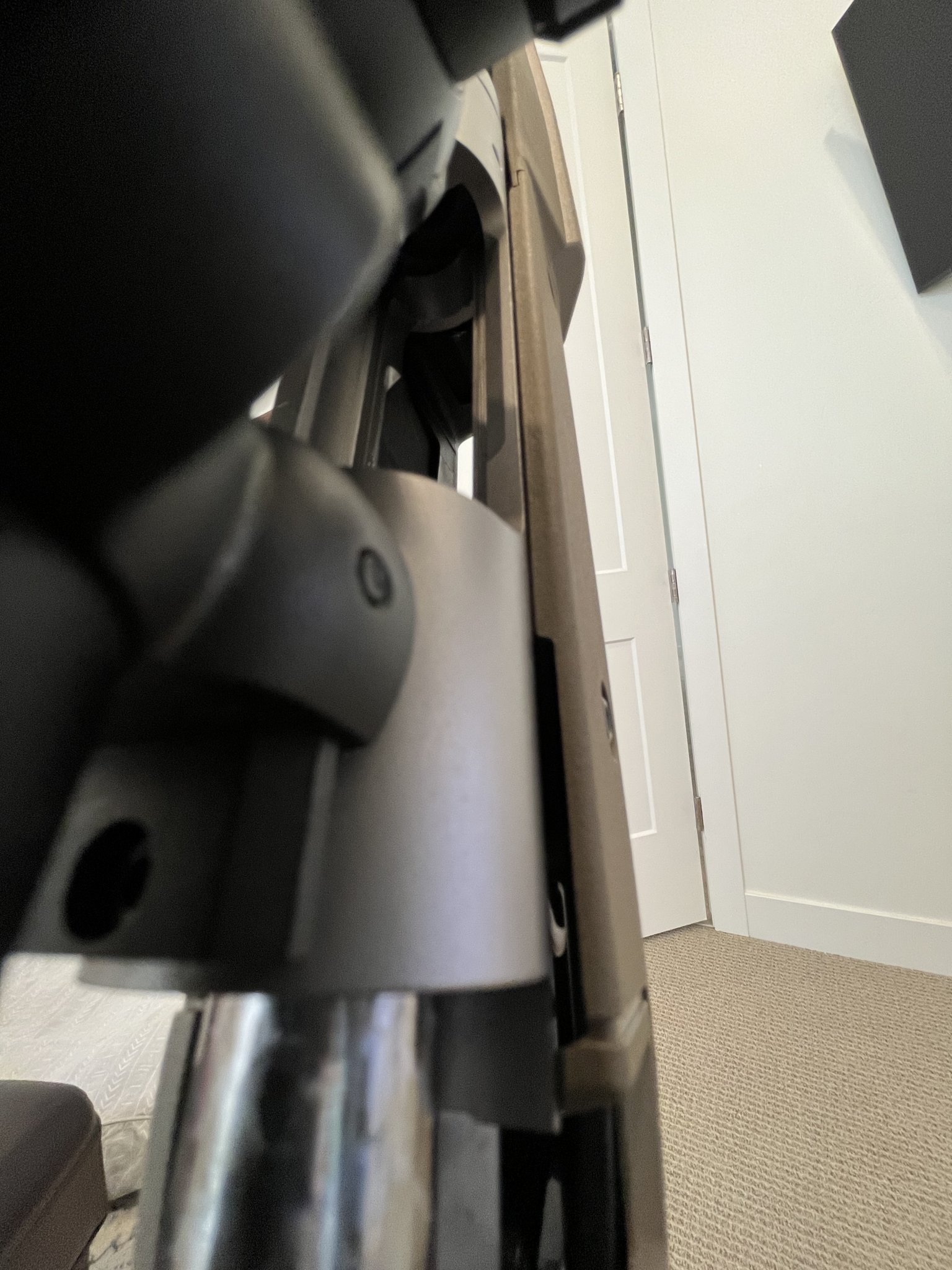

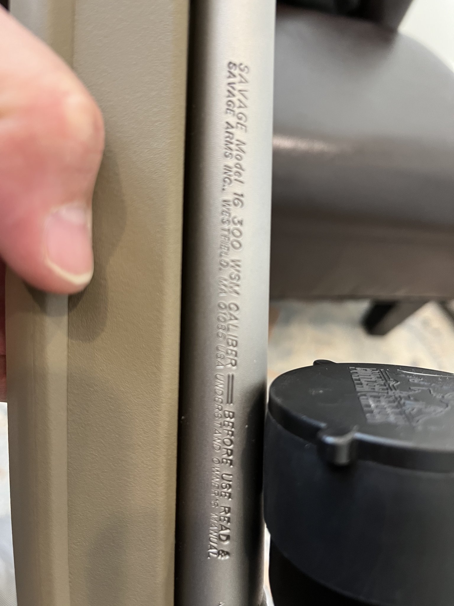

I’m wondering the same thing for my new Magpul Hunter Stock. From what I’ve been reading 700’s and Savage 110 300 WSM and 6.5 PRC are also SOP for needing ramp work down with binderless ACIS mags. My deal is the 110 300 WSM fits like a glove in the Magpul Hunter stock, but I didn’t know the PMags didn’t work for the 300 WSM or PRC magnum rounds. The angle of the mag ribs don’t allow the round to have the correct angle or height for the bolt to pick up without the casing edge catching on top edge of the PMag, then of course there is a small overhang from the feed ramp. Maybe 1/8 inch. So I’m hoping to learn that using a binderless ACIS mag will work. Anyone try this or have an inkling?
