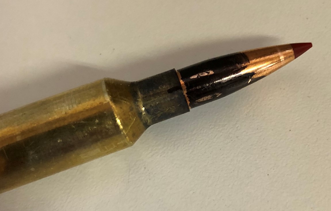

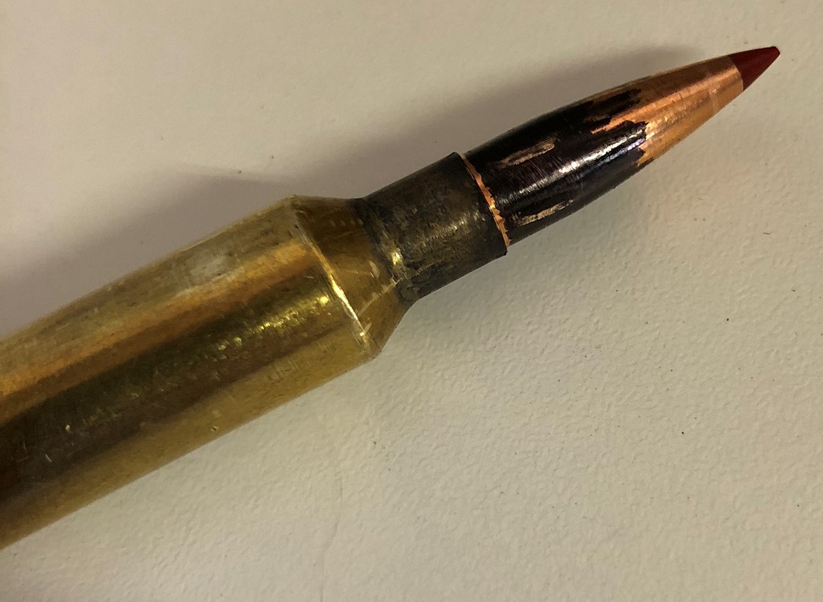

Here's what happened with a round loaded to 2.800". Any thoughts?

You’re not hitting the lands in the sense that you’re pressing against the leade. Maybe the chamber reamer was worn and cut the throat too tight in the sense it did not cut off all of the rifling down to the walls. But what you have will wear in after a few hundred rounds.
Can you elaborate more? Am I jamming into the lands at this length? Should I seat at 2.800 and just go to the range or should I try to seat deeper according to what the OAL gauge says, which is more like 2.550 - 2.650" ?
Your pics shows that you have a quarter inch of rifling marks on the bullet. I can tell you with absolute certainty that there is no way in hell you can jam a bullet that much into the lands.

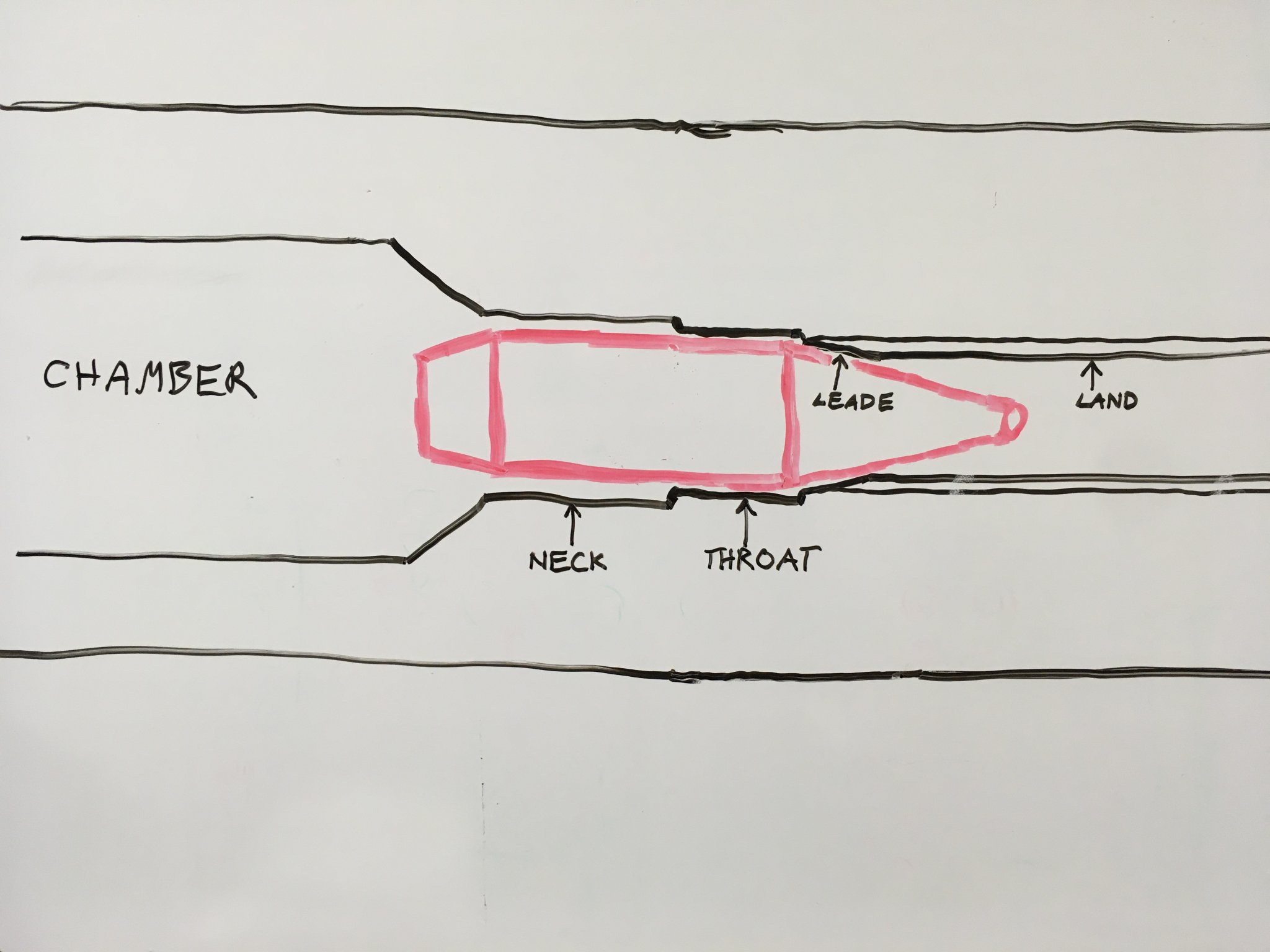

When they cut your chamber the reamer failed to remove all of the rifling from the throat. It left a faint remnant of the rifling to scratch your bullet. A throat is normally .0005” to .0020” bigger in diameter than the bullet and this causes all of the rifling lands to be removed. In your case it wasn’t, but it’s not like there is no throat at all. You do have a throat, but it’s too tight. But it will also wear in as you’re shooting the gun. After a few hundred rounds you won’t see those marks anymore. The powder will smooth them out.
I’m not going to tell you what COAL to use until you find the COAL where you are making hard contact with the rifling, hard as when you can’t close the bolt.
Start with something like 2.950” and seat that bullet deeper in small increments until you can close the bolt. That will be your max COAL. Then get back to us.

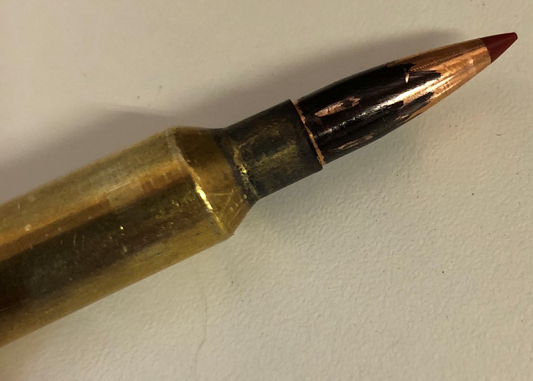

So, based on this, the 2.80" neighborhood seems to be okay, but I was still getting those long markings that I posted before.

You will get those marks for a while but they will go away eventually. The crude picture I drew is exaggerated. Notice the throat is much bigger than the bullet. Now imagine the throat being a lot tighter and some remnants of the rifling still there. These 6.5’s have long bullets. Half the bullet is in the throat and half in the neck. It’s bound to get scraped if everything isn’t perfectly aligned.

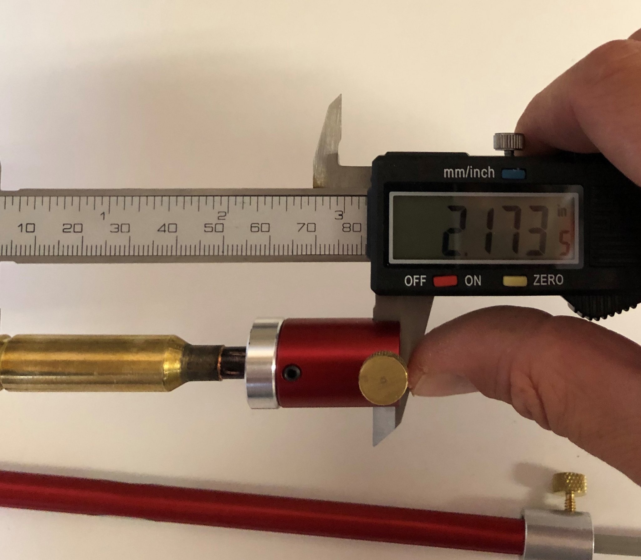

Now that I understand it based on what you said, I took the Hornady OAL gauge and really seated the bullet in the chamber with confidence (some "umph") and got a measurement that was consistent and repeatable with any bullet I tried from the box. So, I think I am now correctly pushing it past the rifling that isn't cut all the way and hitting the actual rifling after the leade based on your diagram? I was getting around 2.200" CBTO with this method. This was about 2.820 - 2.830" COAL roughly. So with that, I took it down to 2.180" CBTO on my actual bullet seating for my reloads which puts it at 2.800". I'll experiment with seating .01 and .02" off this 2.220" CBTO I was getting on the gauge.
