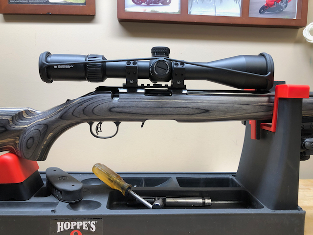

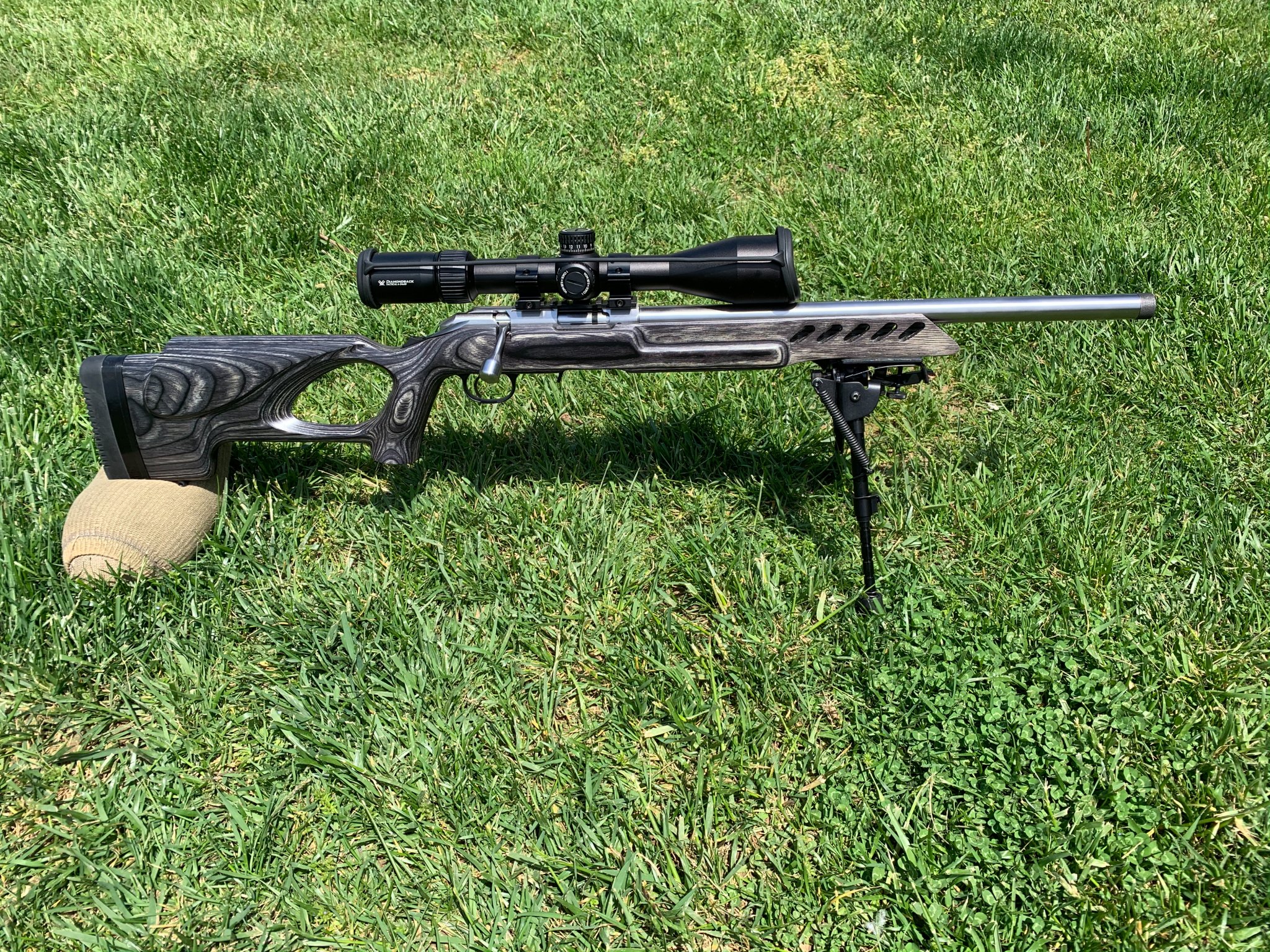

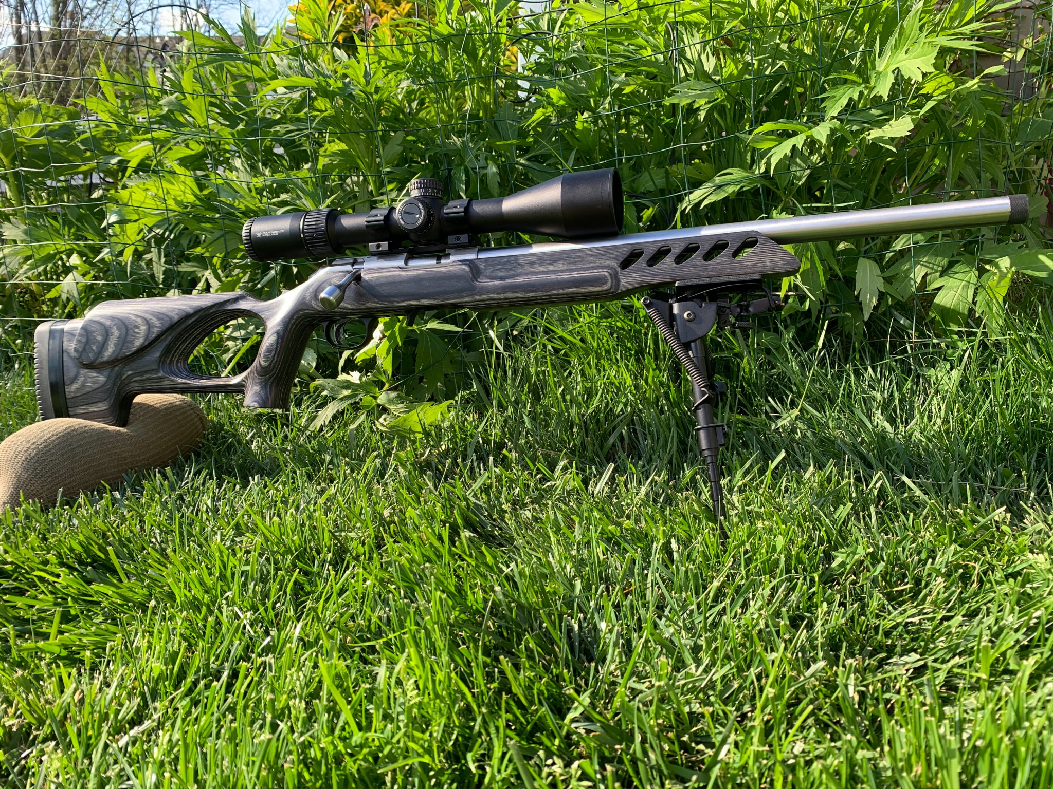

I'm running Leupold Rifleman 30mm medium rings with a Vortex Diamondback Tactical 6-24x50 on mine. The scope just clears the barrel, not by much but I can see light between the bell and the barrel.
I should have gotten "high" rings, they are only .2" taller, and would allow for flip up covers on the scope.

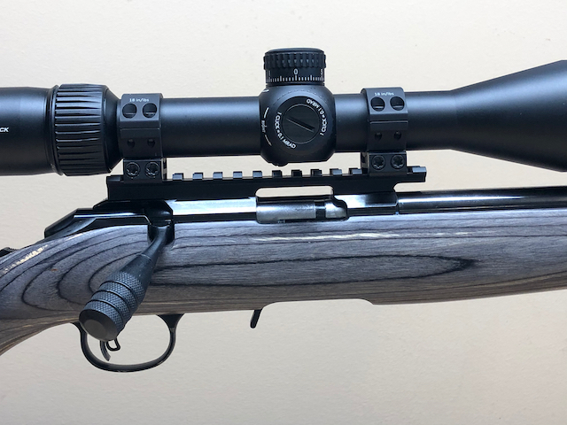

Will this one piece mount work on the factory installed picatinny rail?
Thanks.
I could be wrong, but it doesn't appear from the photos that the factory rail is cut to picatinny specs, especially the solid center section of the rail. Your one piece mount with that center cross bolt doesn't look like it will fit. However it does look like Ruger sells an actual picatinny rail for the American Rimfire rifle https://shopruger.com/Ruger-American-Rimfire-Picatinny-Scope-Base-Rail-22-LR/productinfo/90674/ .

Hi
I knew the center bolt would not fit but I am interested in getting the ends to fit properly, the groove for the center bolt can be machined later.

I have the Ruger American Rimfire Standard in 22WMR. I have Weaver two piece mounts. But measuring between the front and rear mounting holes, I came up with only 80mm. Your mount requires 120mm of spacing.

Absolutely stunningly beautiful rifle/scope combo. I have the same rifle but my scope will be an inexpensive (cheap) athlon.
