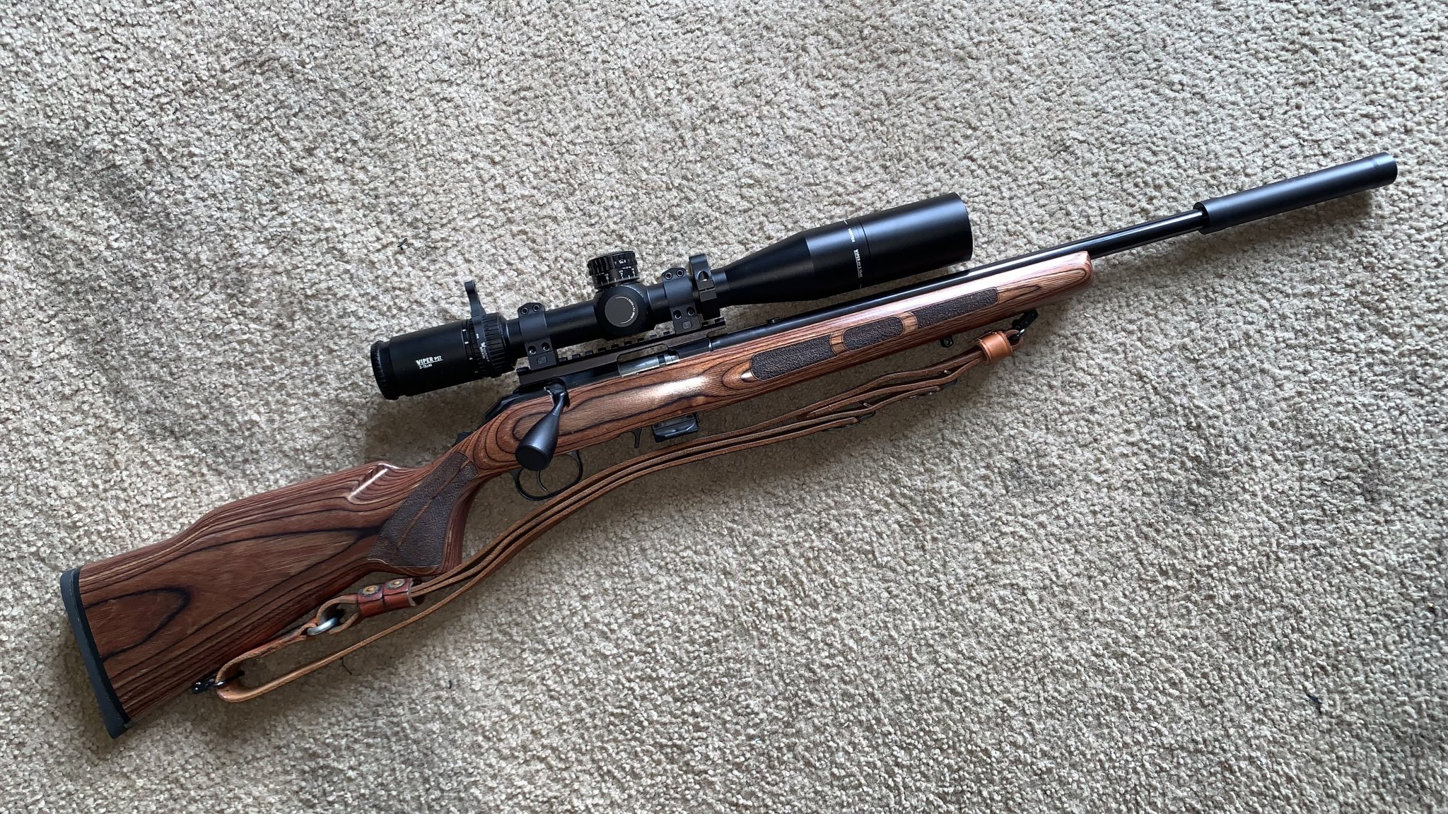

It is never a good idea to use a spreadsheet to keep track of the costs of a rifle make-over.
ItemCost
Ruger American Rimfire Rifle$ 214.49
Boyd's Rifle Stock$ 224.75
Galdes Armory Extended Bolt Handle and Knob$ 96.98
Vortex Viper PST Gen II 3-15X$ 1,016.00
Vortex Switchview Scope Lever$ 60.00
Vortex Rings$ 80.00
Vortex Scope Level$ 37.61
EGW 60 MOA Scope Base$ 90.71
Timney Trigger$ 148.64
Leather Sling and Swivels (Estimated)$ 80.00
14 each Extra 10-round Magazines$ 236.81
Tandemkross Magazine Bumpers$ 179.65
Williams dovetail blank$ 8.96
Cut down and thread barrel$ 75.00
SIG 22LR Suppressor$ 600.00
Total$ 3,149.60
Call me an idiot for spending that much on the rifle but I really like it now.

Thanks. I’ve only shot CCI SV Suppressor 45 grain*, through it. The groups are about 1/2-/34 inches at 50 yards.
*EDIT: I was typing too fast and should have said that I shot the 45 grain stuff through the rifle.
It’s a nice rifle to carry through the woods. The two biggest improvements for accuracy are the Boyd’s stock and the Timney trigger.
Cutting down the barrel did not affect the muzzle velocity much.
When someone buys an RAR they are getting a barreled action. Everything else is trash.
I’ve done makeovers on three other RARs. Including mine, the plastic stock’s magazine well was molded incorrectly. I could only chamber the first round. The bolt pushing the first round in the chamber also pushed the magazine causing it to tilt forward.
So when chambering the 2nd round the bullet would jam up against the breech face of the barrel - EVERYTIME!
So if anyone buys a cheap RAR, that’s only the initial expense.
Yes; I know, I should have bought a Vudoo. However, note in my list of expenses that the scope and suppressor were the most expensive items.

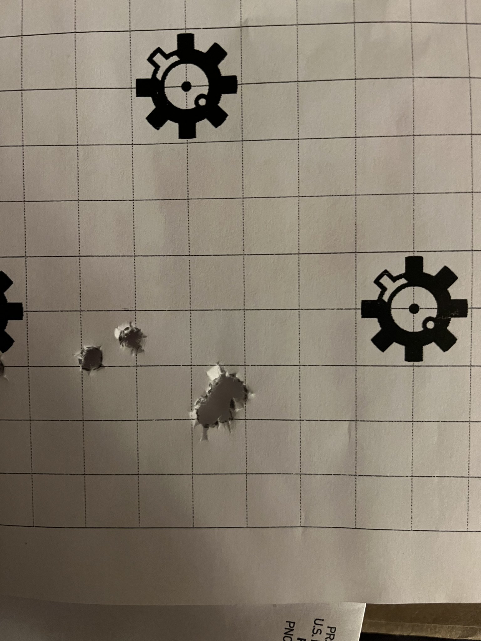

That center group is 10rds of CCI SV at 25 yards. This was shot with gusty winds in fading light and done rather hastily. Needless to say, I’m super impressed!
