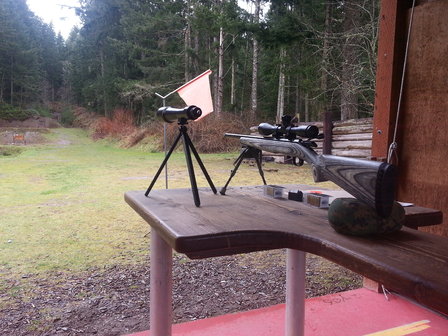

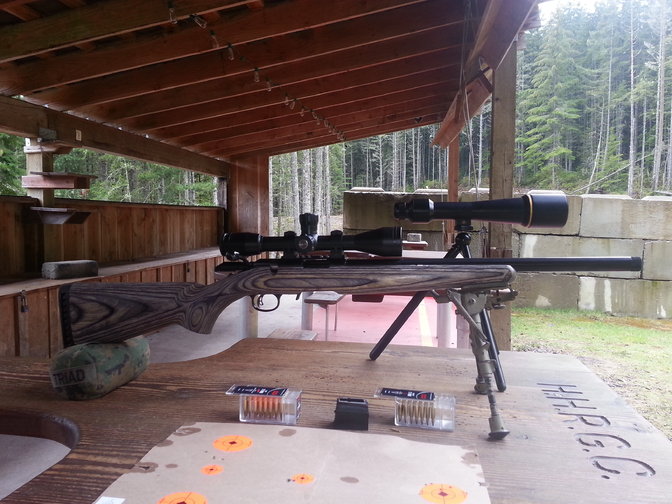

    Test scope was a simple Bushnell fixed 10x with mildot reticle in Vortex low rings.
    Conditions were less than ideal with 35* and snowing but there was no wind so I went for it.

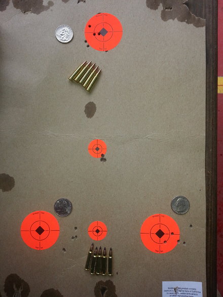

    @100yds 5 shot groups of cci 17 vmax were 1.25" bottom right. And 1.5" top right.
    @100 yds 5 shot group of Cci 17gr TNT HP did a little better at 1" exactly, left center target.
    Just for fun I shot a 5 shot group with the TNT HP @ 200yds and was surprised to see a group size of only 2.1" and only 1.2 mills low.

    I just restocked and built up an older Savage 93r17. Went out with about a half dozen+ different loads and did the same. The CCI A17 and the CCI 20gr Gamepoints worked the best for me. Just a bit under MOA. I was surprised how much fun I was having shooting this thing...
    images upload
    They are a hoot. What optics are you using? I have a Sav 93r17 also. Mine seemed to prefer the HP ammo for precision tgt groups. 0.600-0.800" at 100y in perfect conditions off of a bench was about all it could do. They are great fun for plinking at long ranges. 200y or even longer. It is a MOA or slightly better rifle most of the time. That is not that great by benchrest 22 stds but it comes into its own out past 100y.
    Irish
    Im just running the same fixed 10x Bushnell the OP is using. It was sitting on the shelf collecting dust so... Tossed a Triad pack on it to raise the comb a bit. Its perfect now. 200yds was a snooze. Got it to about 325 so far, all using steel. Its just a fungun and basics trainer for me. I was looking for a project and it called at me from the rear of the safe. Total investment was about $200 plus my time and some Norrells MolyResin. Made up some dope cards off the initial data and AE. Will shoot it more next week and see how far I can stretch it. I think Im prolly pretty close now, maybe another 75yds.
