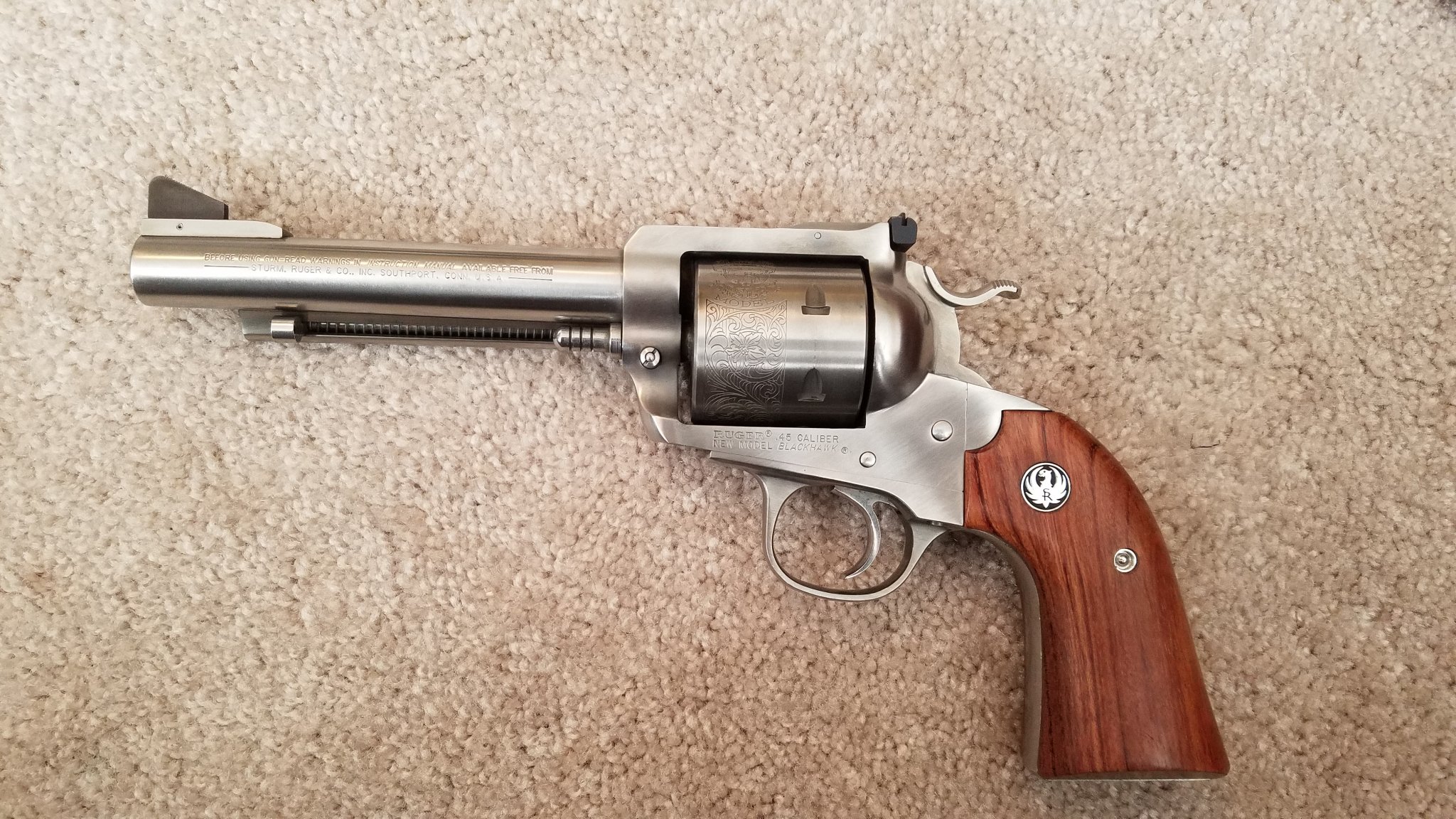

Most Bisleys come in 7.5".
Twenty years ago, they sold a stainless 5.5" 45 LC Bisley. I have one.

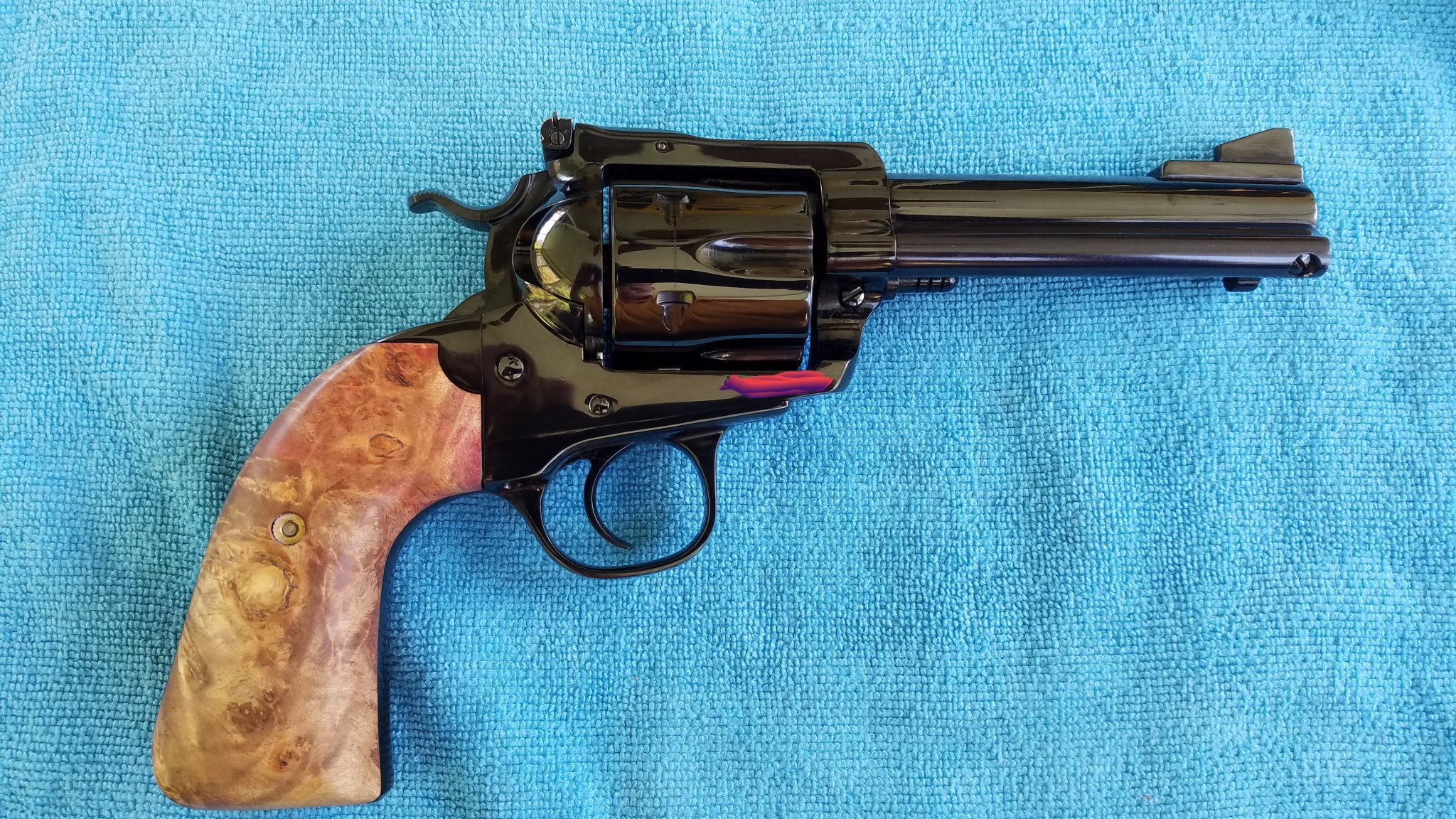

I also took a 4-5/8 41 mag Blackhawk and had Gary Reeder fit a Bisley Grip frame, add new grips, action job and refinish.
It's my favorite Ruger.
