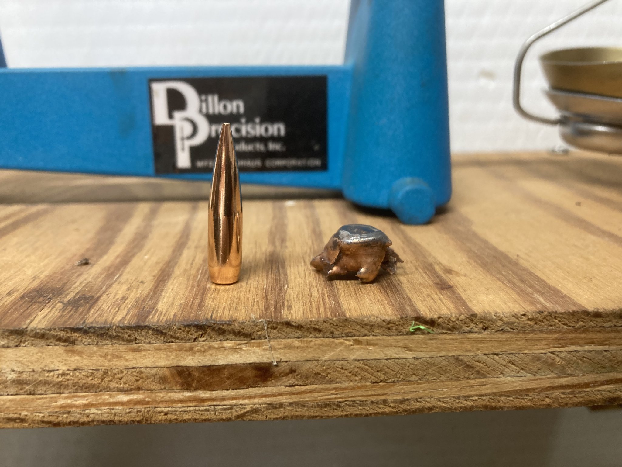

Try different powders, different primers and Especially different bullets. Sierra 117 Spitzer Boat Tails are excellent bullets for accuracy as are the 115 Bergers. But with the Bergers, you have to drive the Bergers pretty hard to get them to stabilize in a typical 1-10 barrel. (They work great in my .25-06, but I ma pushing it pretty darned hard.)
As far as hunting, the Bergers will do the job but often you will find the what’s left of the bullet just under the far skin. Blood trail won’t exist, but trust me, hit where you’re supposed to with the Berger and the boiler room is going to be a mess.
51.5 grains left out of 115 but that deer didn’t travel 30 yards.
