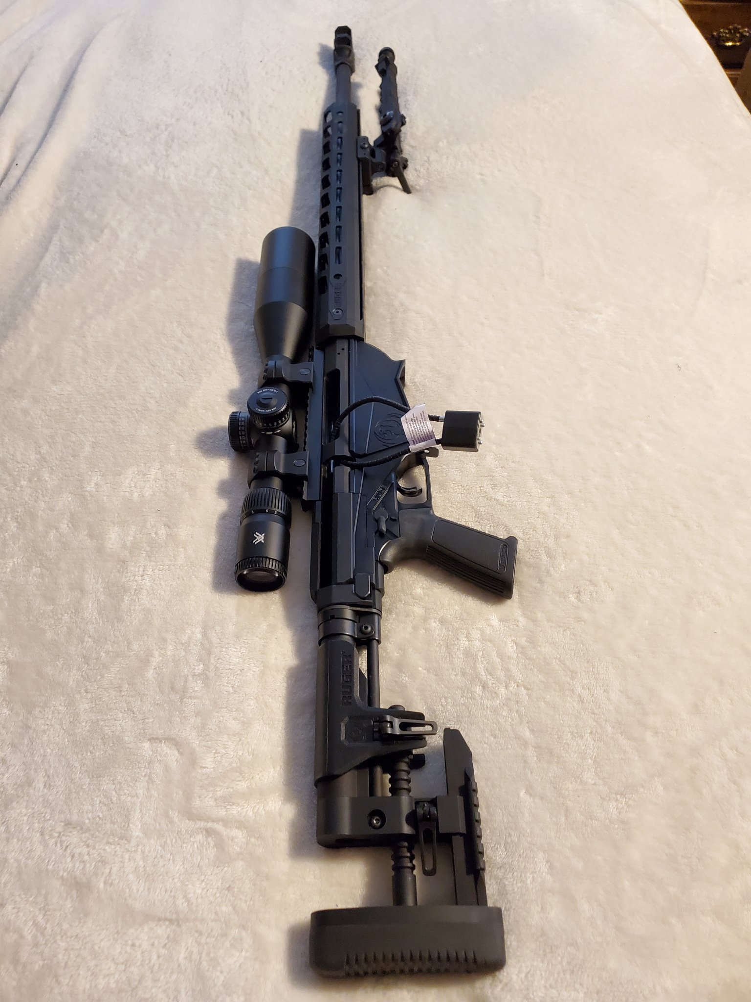

We got a Ruger Precision in 300 Win Mag and are taking it to the 100 yard range shortly.
Vortex Venom 5-25x56mm scope, Accu-Tec Bipod.

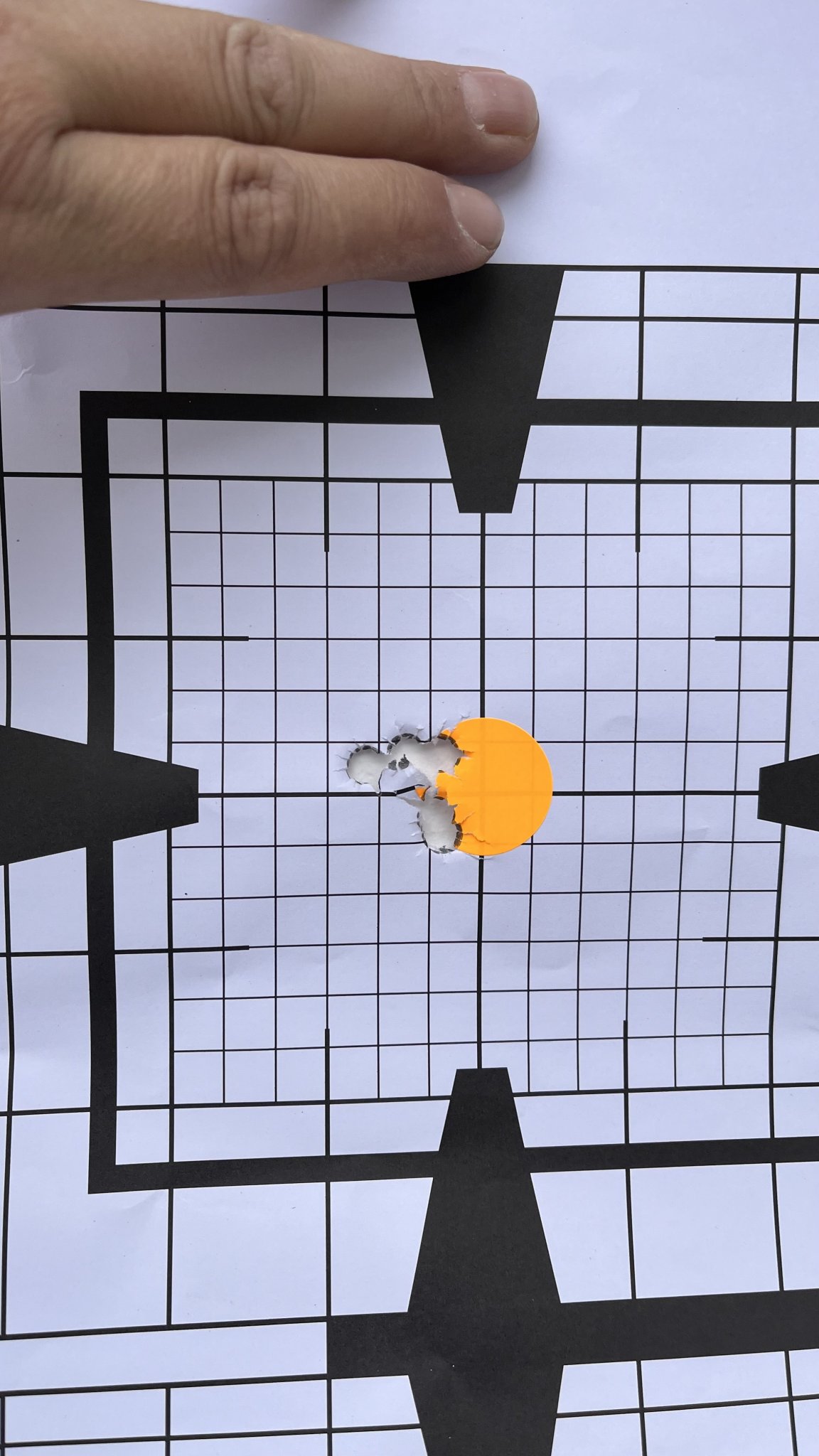

I shot it at 25 yds yesterday and it's same hole with the Winchester Power Point 150gr.
Thanks for any ideas.
