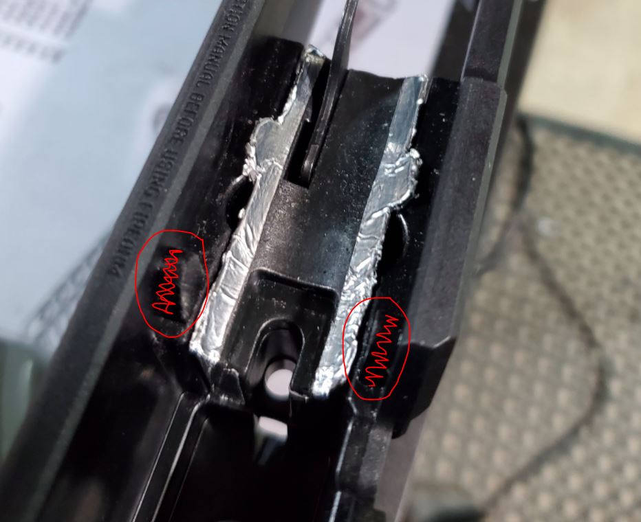

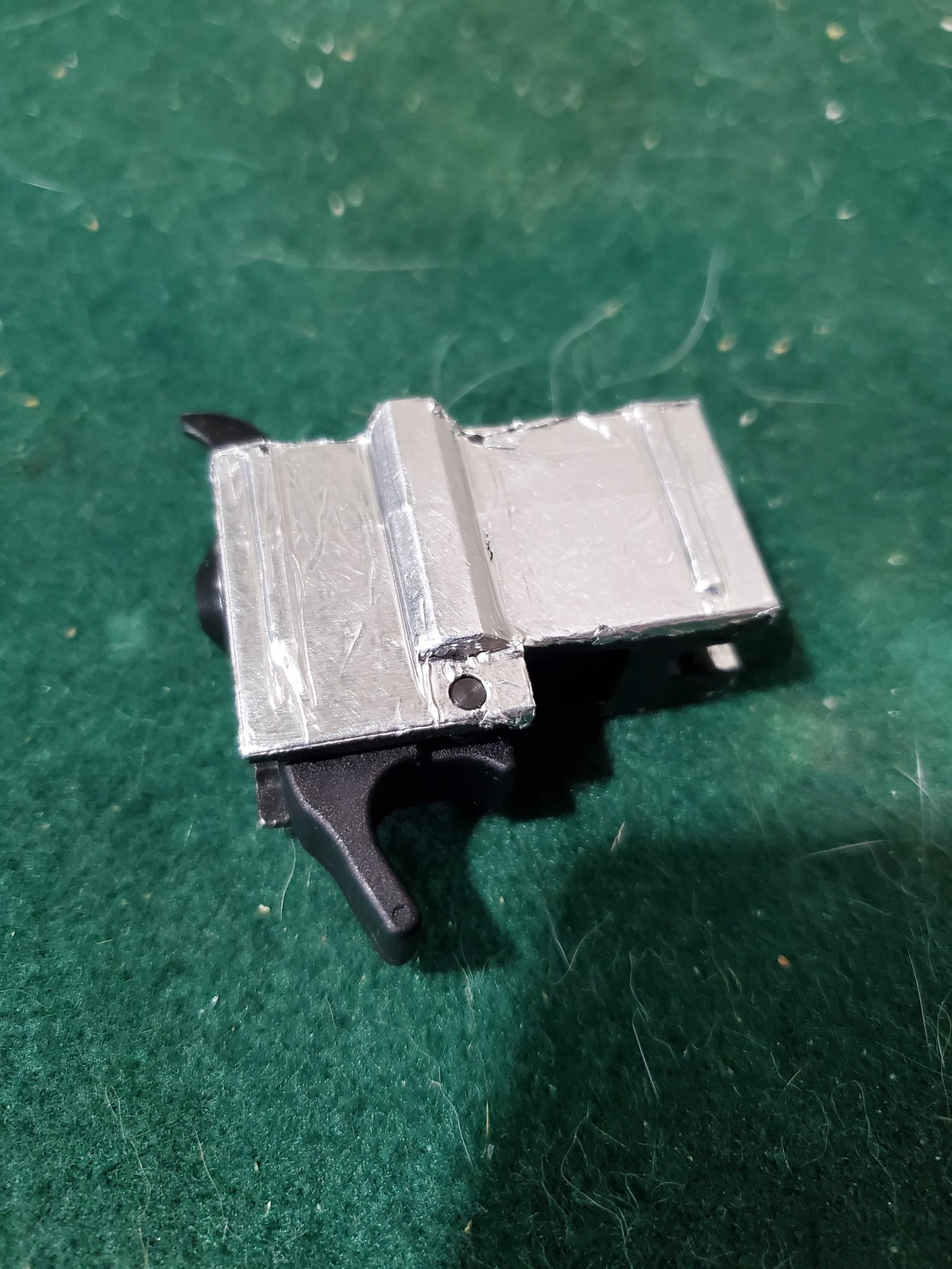

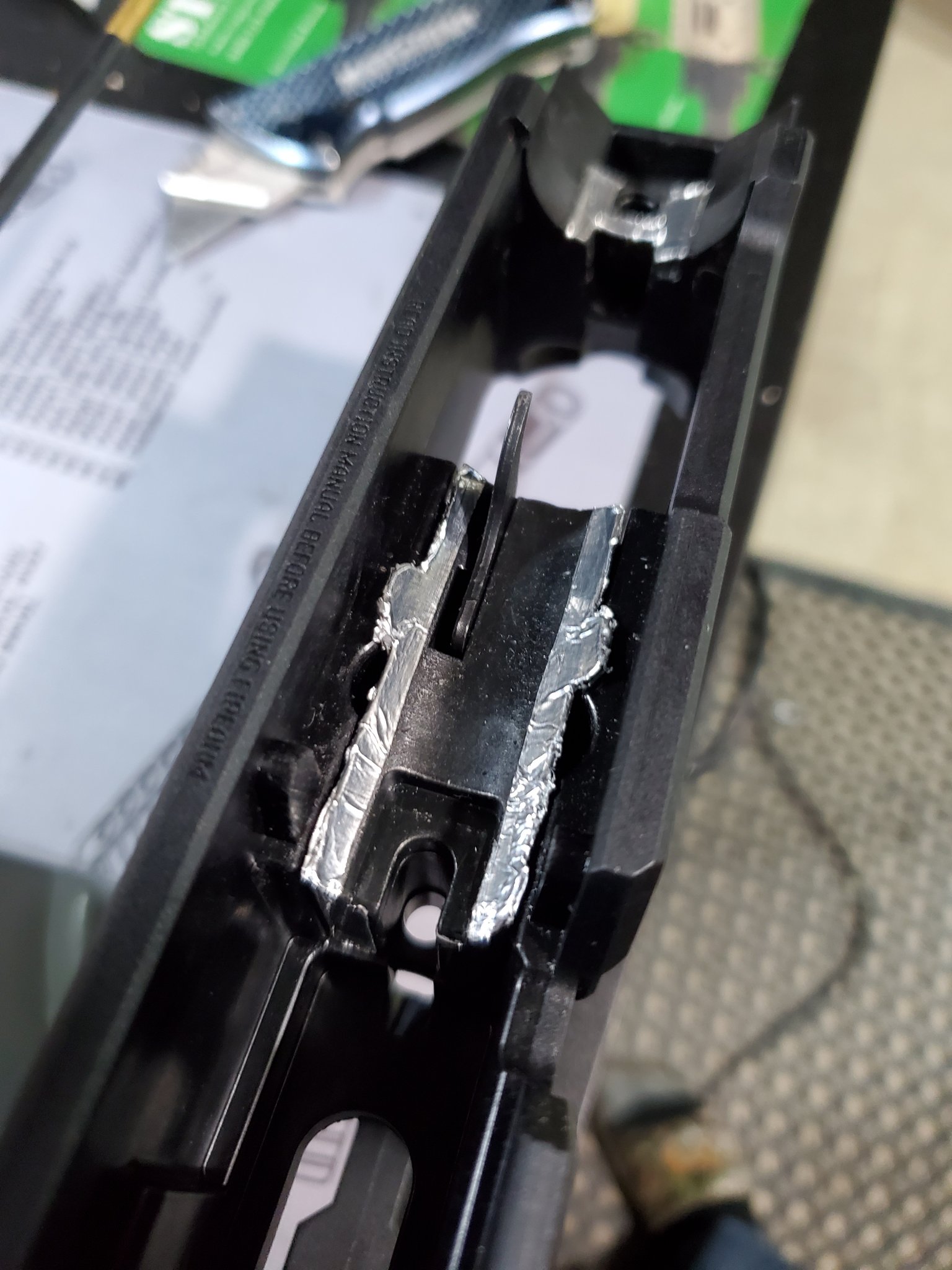

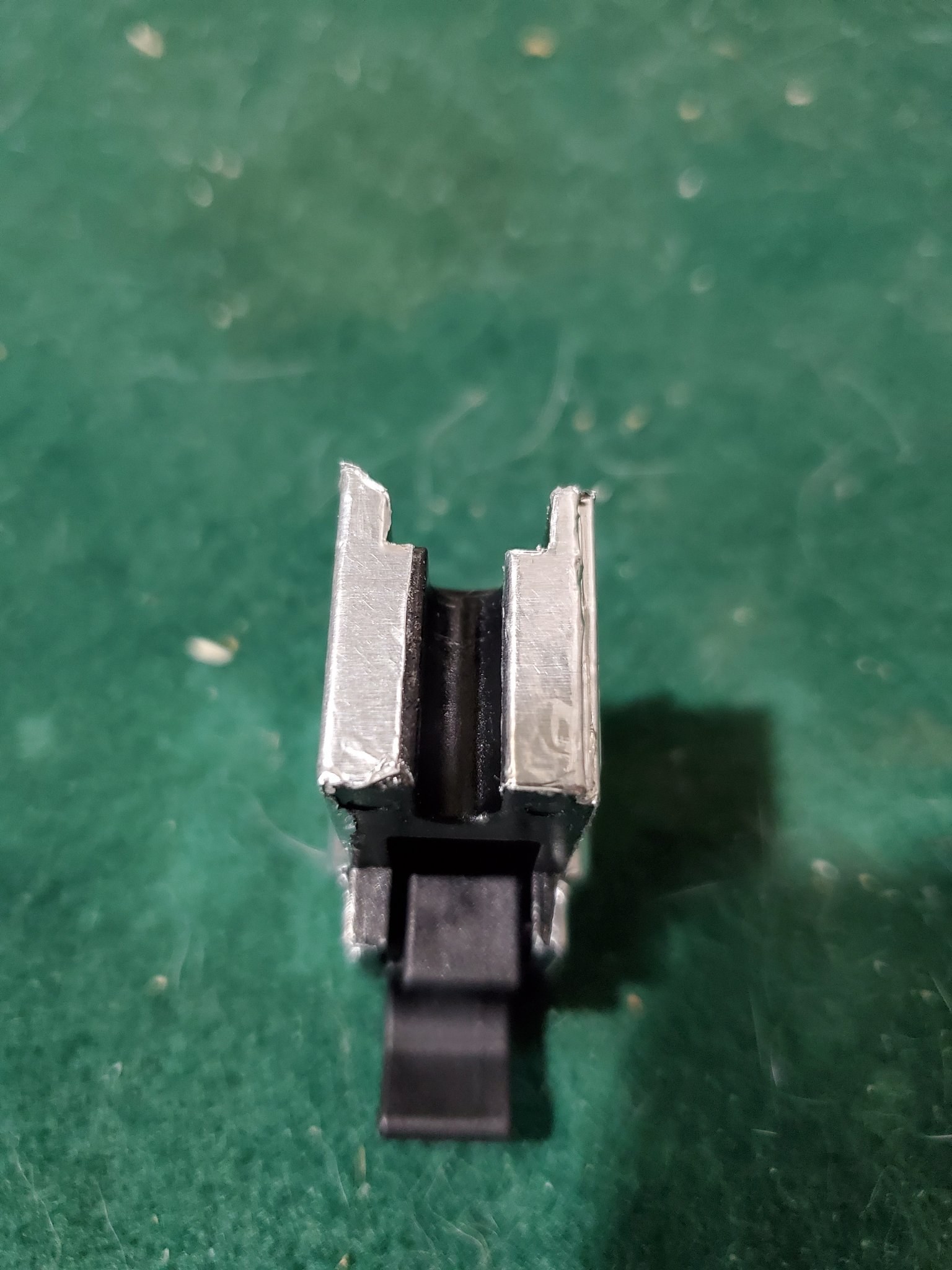

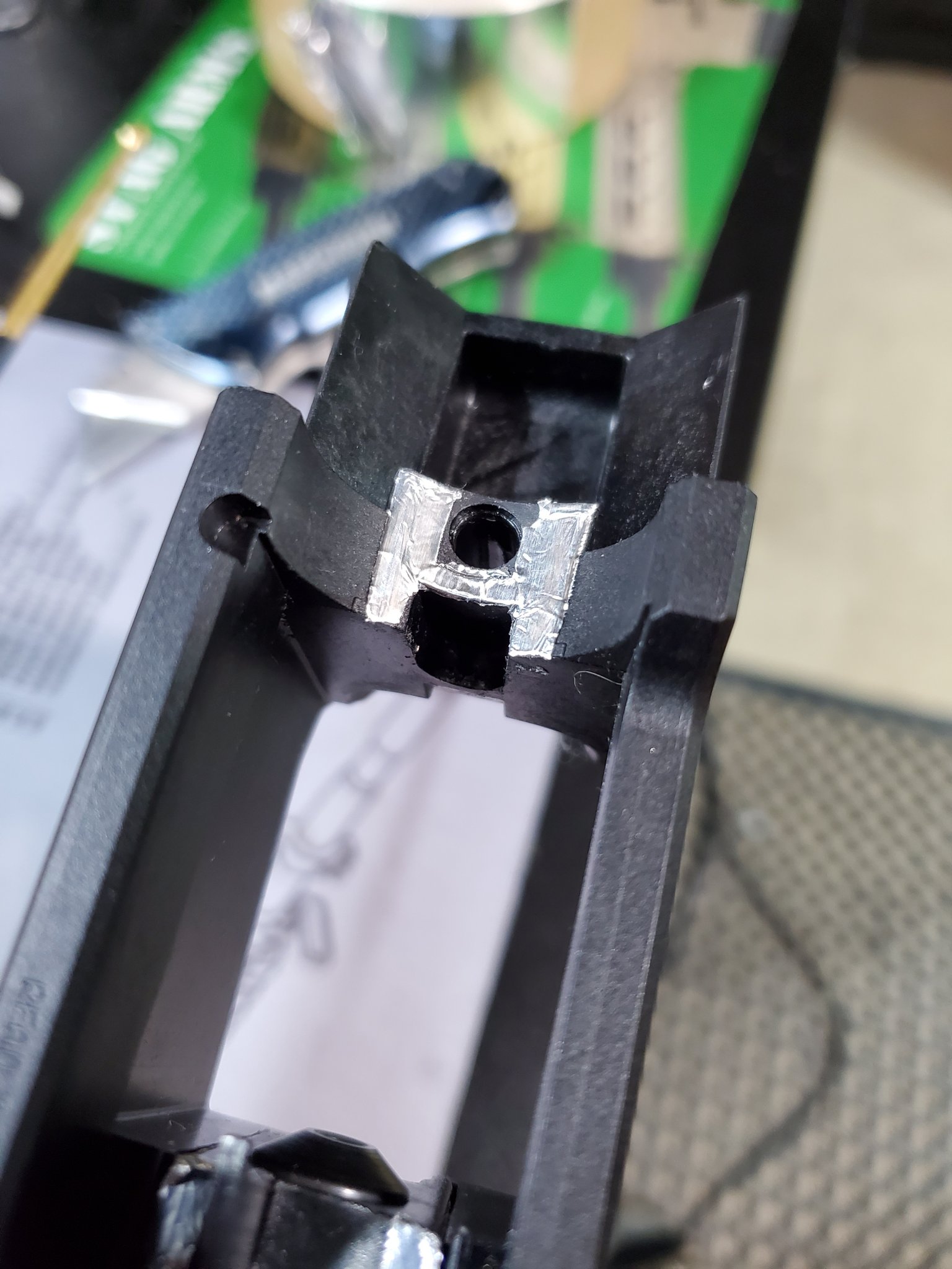

I also did the foil bedding. Ill shoot this weekend with just the foil bedding and maybe playing with torque settings. At least that will give me a baseline of before and after bedding and allow me to compare once I get the new barrel.
How did I do?
How did I do?

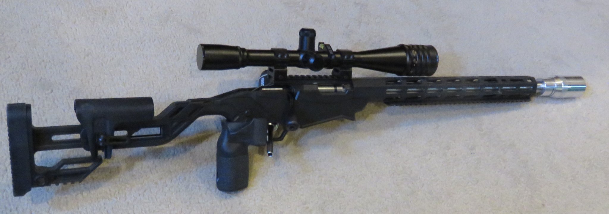

In your second picture, do you see those two "tabs" on either side of the chassis opposite of where the rear action bolt hole is? Cut some thin shims of tape and put them on the outside edge of those tabs. The tabs fit into recesses that are milled into the rear of the barrel and are the closest thing your going to find to a recoil lug on the rifle.
So you mean these things and put the shims where the squiggly lines are?
Exactly!
You'll notice that those two "tabs" fit into some slots on the back of the barreled action. Put some tape on the edges of the tabs where you have put your squiggly lines so the fit between the tabs and their corresponding slots are semi-tight. The tabs and slots are for aligning the barrel in the chassis, but I thought they sort of act as recoil lugs.

I installed a Shaw match barrel on my RPRR quite some time ago now and have been very satisfied with the improved results. Recently fitted a tuner onto it to see what kind of improvement that might make. Last month after doing a little centerfire load tweaking, the day was very nice and calm; perfect for getting a tuner dialed in. Once I got it dialed in, this is what I was able to do trying to get head shots at 50 yds with a Weaver T-36 using Eley Club and shooting from a bench rest (the big hole being 20 shots I took in getting the scope and tuner dialed in):

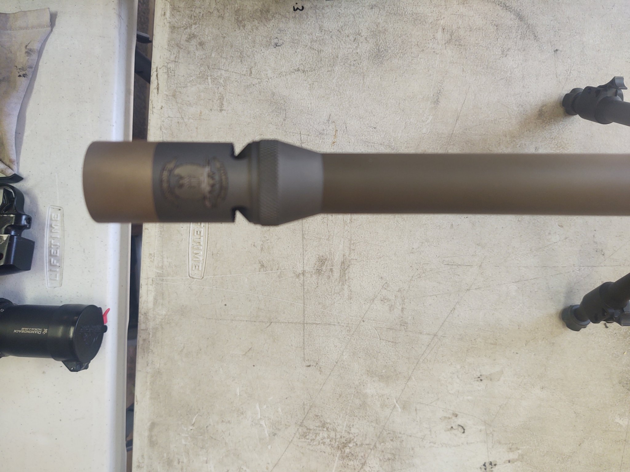

I put a a.t.s. tuner in my vudoo to see how it would do at distance it was shooting 1.5-2 in groups at 240 yrds... But didnt help up close but then i put a t-rec muzzle brake on and it now shoots consistently 1in at 240 yrds. Made by k.d.e. customs he is a buddy of mine we spun one up for a rimfire wow what a difference.... Its self timing and made out of titanium but on the end its bronze,very dense and heavy its a tuner brake in one,,,NOT THAT YOU NEED A BRAKE ON A 22 also increased velocities by about 17 fps which i didnt care,never been a velocity whore....

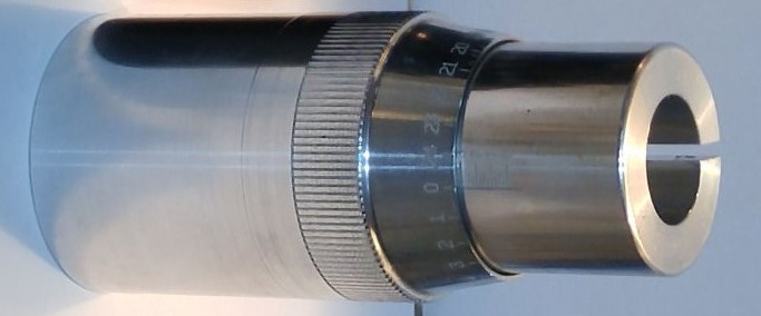

I have the Harrel Rimfire Tuner. When I got it, It's actually larger than I expected (big and heavy and so I refer to my rig as my Blunderbuss ;) , but it's nice that I can easily mount a can to it.
