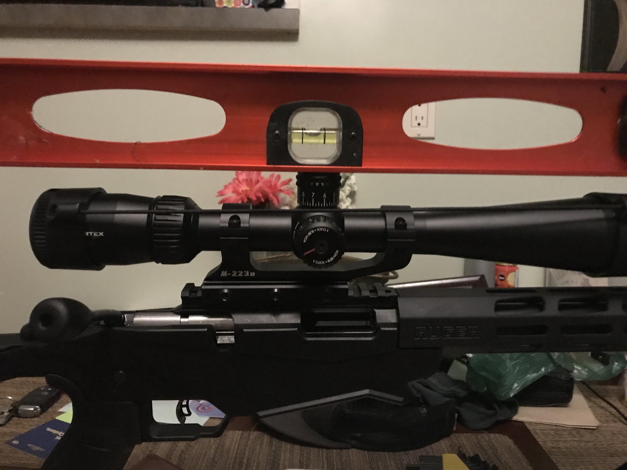

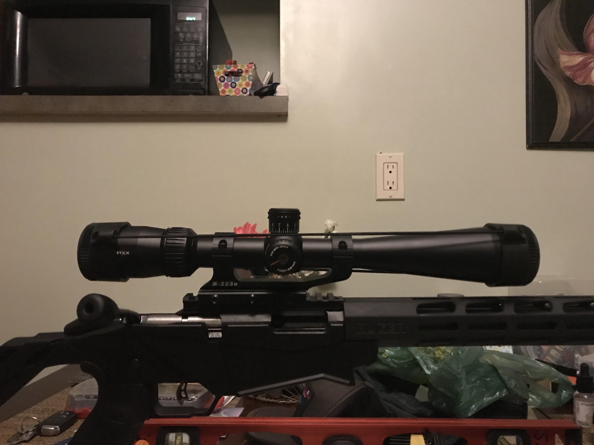

Hello,
I bought a Ruger Precision Rimfire about a week ago and got a Vortex Tactical 4-12x scope with a one-piece $100 ring set. It is my first rifle with a scope, my only other Rifle is an AR-15 with a reddot.
Anyway, I got tried to mount the scope myself through youtube videos. It didn't go well. Went to the range and it was about 2.5 feet above paper. No worries, I chalked it up as a learning lesson and took it to Cabelas to have them re-mount it and laser boresight it. They told me they had the same issue, and even put a different scope on it they had around and couldnt get it on paper?!?!
Is it something to potentially do with the 30 MoA rail? The scope and rings I have are brand name good items.
The rifle just didn't have the screw for the hand guard when I got it also, is this rifle just a lemon?
Reactions: skinnj1
Sounds like it might be an issue for the combination of the 30 MOA rail and the one-piece ring set . . . .if it's mounting high.
I assume you're talking about the Vortex Diamondback Tactical. . .??? 70 MOA adjustment is plenty (35 in each direction from center).
How high is the scope when mounted (center of scope to center of bore)???
And, like kl3309 asksed, it'd be nice to know if that one-piece ring set has any elevation.
The good news is . . . if it's a problem with the scope, Vortex will replace it for you at no cost (except your shipping to them).
Rings have a 20 MOA slope... So I am out $100?
Better to replace the 20 MOA slope ring, or to get a 0 MOA replacement rail?
The scope is level though? Shouldn't it still be on paper?
I feel dumb.. thank you.

With that mount you have 50 MOA total. The scope may be level but your barrel is angled up 50 MOA. ;)

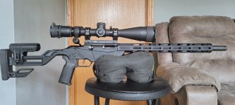

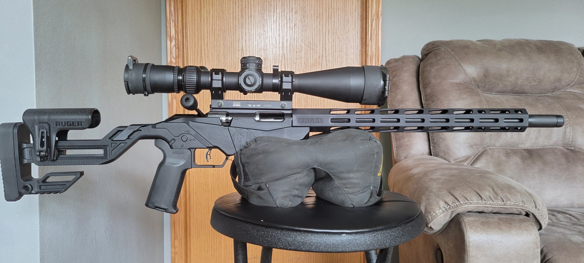

Just bought my 8yr old a RPRR and threw a Vortex AMG on it temporary until her scope comes in. Cannot get a 50yd zero with that oem 30moa rail. POI are still about 6.5" high at 50yds. Current mount has 0 moa built in. Hoping her Burris RT-15 can zero at 50yd. My Savage TRR-SR .22lr with 25 moa rail has no issues with it's Bushnell Forge.
Flip the one piece and go shooting. Wait until you build some skills with a scoped rifle before you spent more money.
