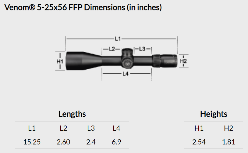

Hi guys I purchased a rprf and put a vortex diamond back tactical 4/12/40 on it With vortex 1 inch rings in high model .97 inches high. This left me with less than a 1/8“ clearance to hand guard. I can’t even put lens cap on front of scope. Shot rifle last 3 days and was very impressed with it but scope so so. I’m looking to do Nrl22 events. After talking to vortex, who were super nice they recommended a venom 5/25/56 I told them which rifle I had but I didn’t ask about rings. I was assuming they would’ve told me if there would be issues. I’m pulling out my hair trying to figure this out. With their tallest rings it says 1.45 inches, with these rings would a 56 mm bell clear the hand guard. I’m coming up with I don’t think so but this scope is 34 mm tube I don’t know if that helps or hurts over the 1 inch tube I have now. Can you put a 56 mm bell on Ruger precision rimfire. Thxs guys
update just watching some videos and now I’m thinking 30 Moa rail could be the issue why I have such low clearance. Should I go down to 20 Moa rail if I want 56 mm bell
The Venom is a 34mm tube. A 1.1" high set of rings with it will put you in the same boat you are now.
So just a matter of figuring our how much higher you want it.
It's not the tube, it's the objective size. The ocular is 2.54" so divide that by 2, and you need 1.27" rings to clear the handguard. If you factor in the 30moa rail, you'll need a little more. I'd do 1.45" to get clearance and fit your scope caps.

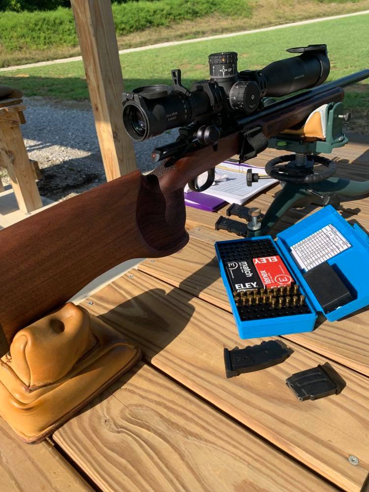

I am shooting NRL 22LR with a CZ 457 MTR with the Vortex Venom. However, I switched over to the Arken SH4 6-24X50 GEN2 FFP MIL VPR Illuminated Reticle. The only reason I went with it was due to the available extra dial up with the Arken (30 mils vice 18.2 mils with the Venom. 2nd reason was trying to find rings with the correct height. It was easier for the Arken (both have 34mm tube). Both scopes were equal in quality.

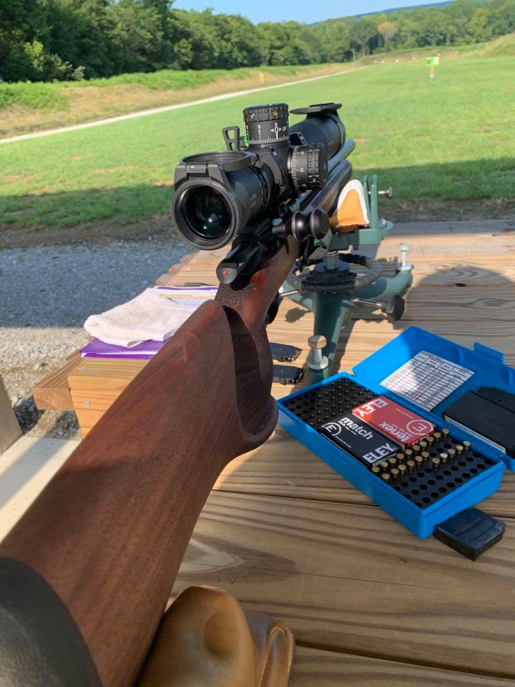

Here is my setup with the Arken scope on the CZ457 MTR
Reactions: Sean69

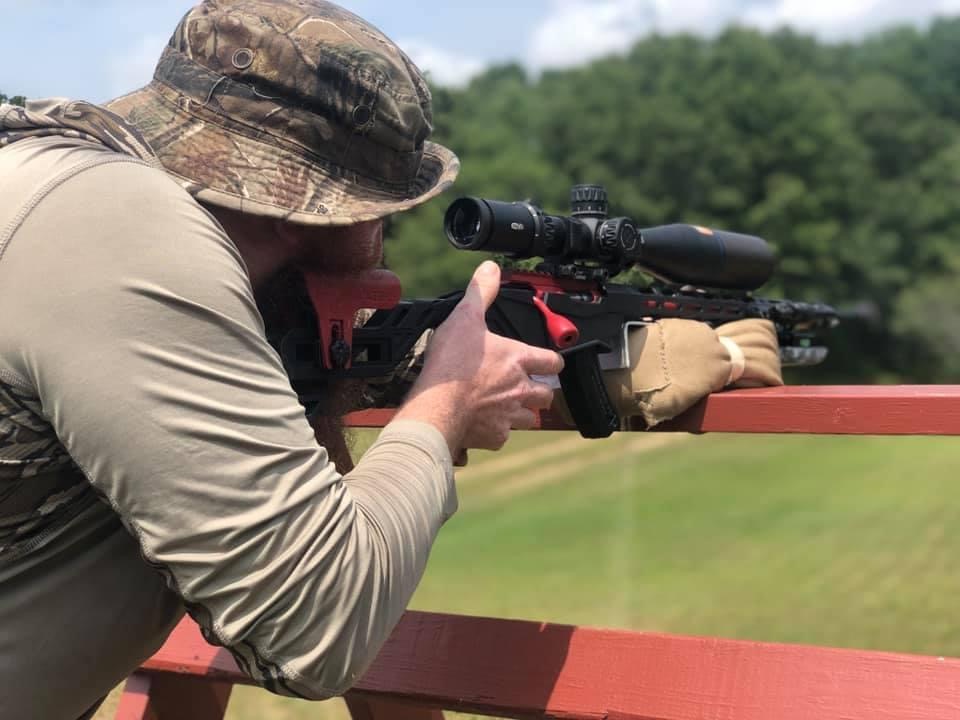

@Sean69. I have a RPRF with a Vortex Venom on it and I used Arken high rings. I believe they are 1.26. I have enough room between the scope and handguard for 1 credit card, but not 2. If you're still looking for options. With the zero stop installed and sighted in with SK Standard Plus I have 47 MOA up available. I have to hold an additkonal 3 MOA to get to 300.
