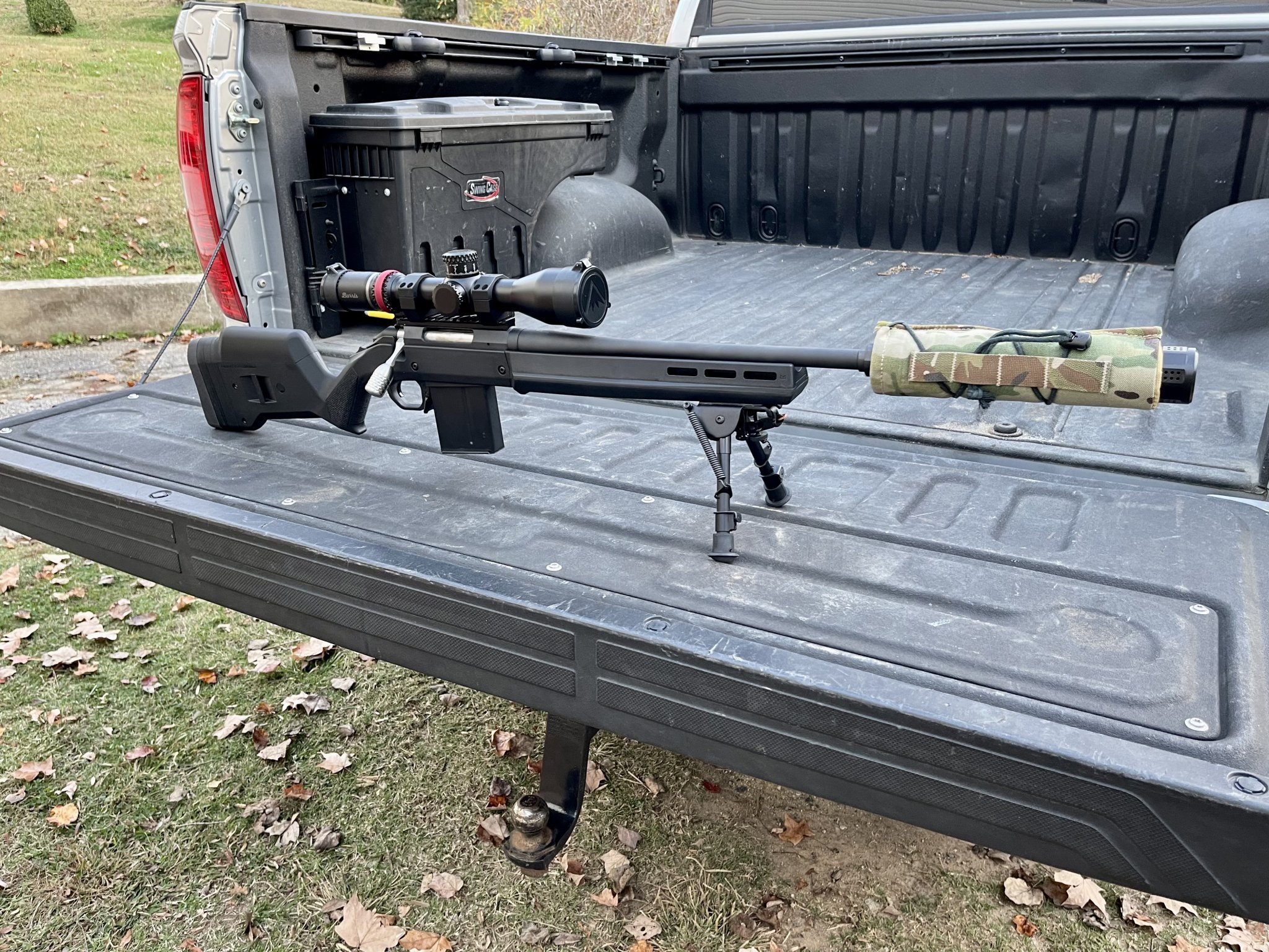

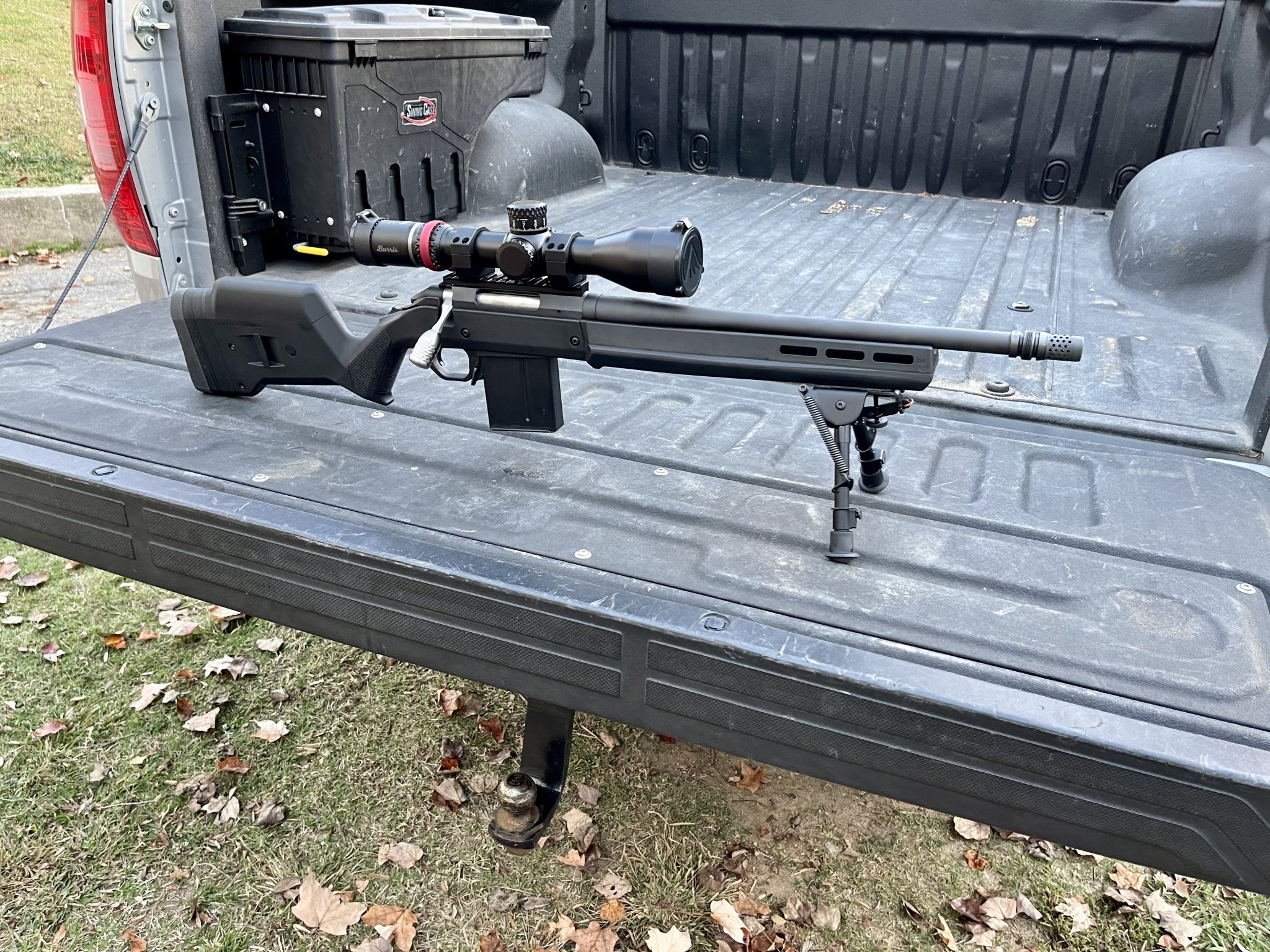

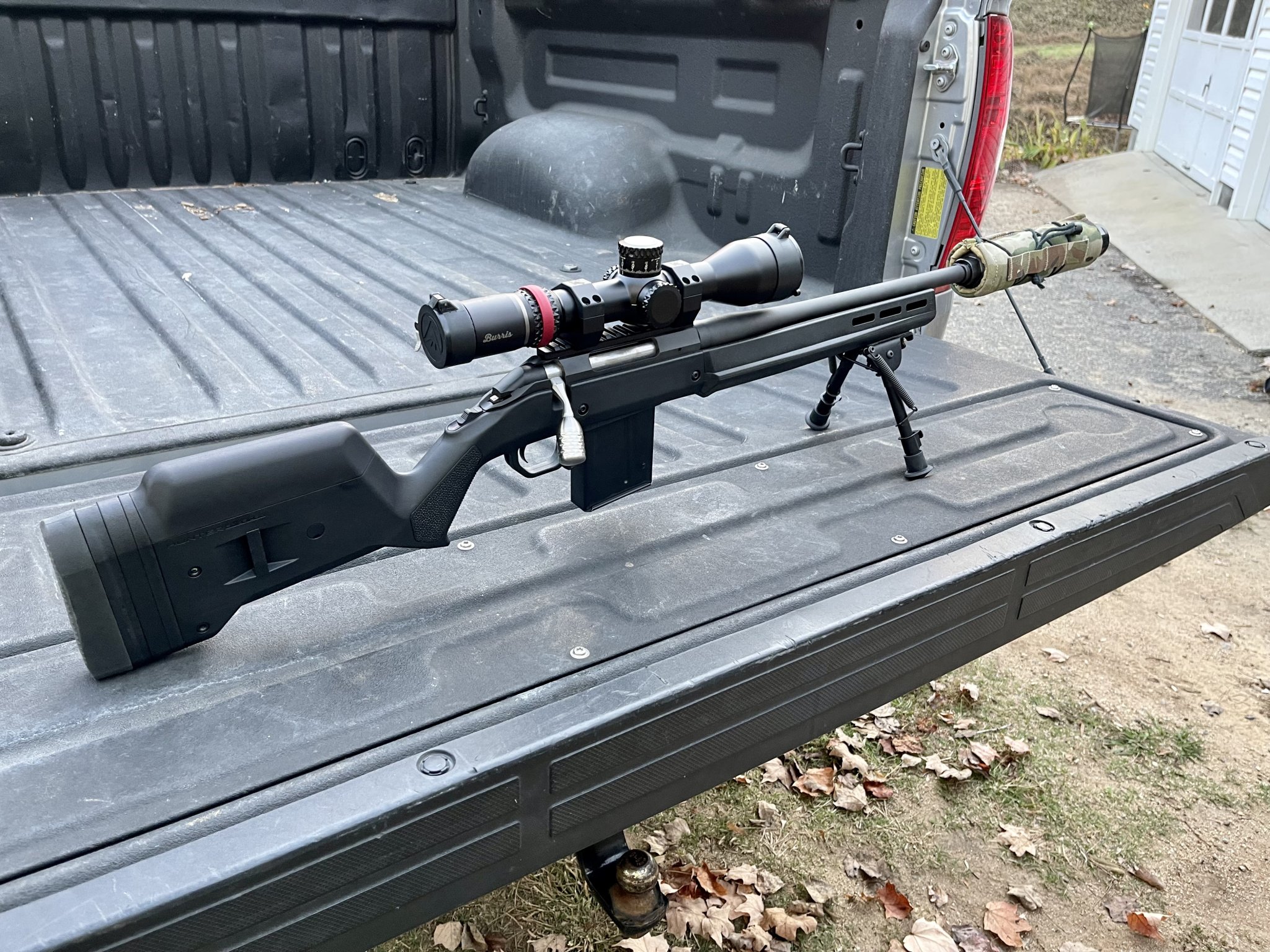

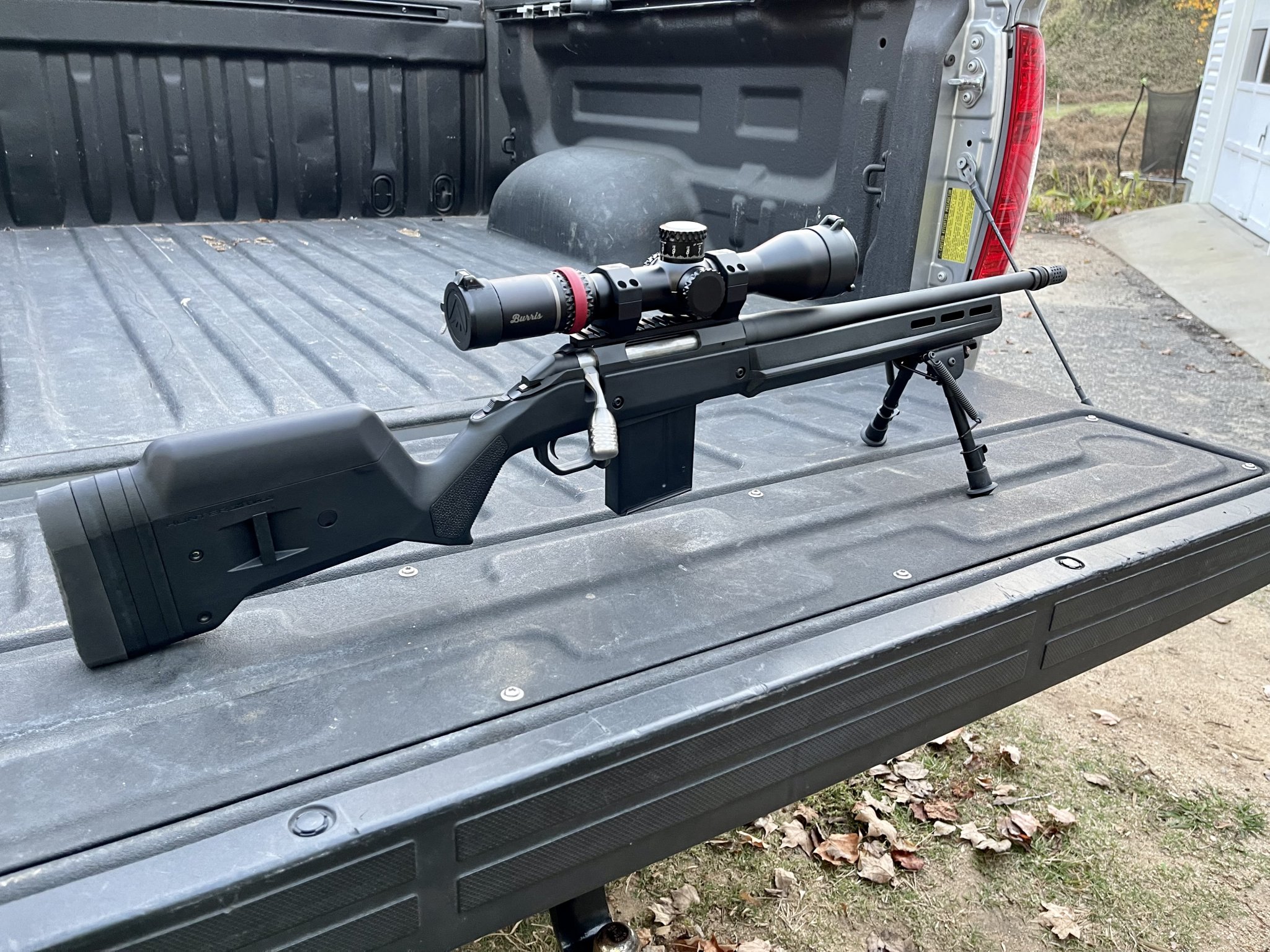

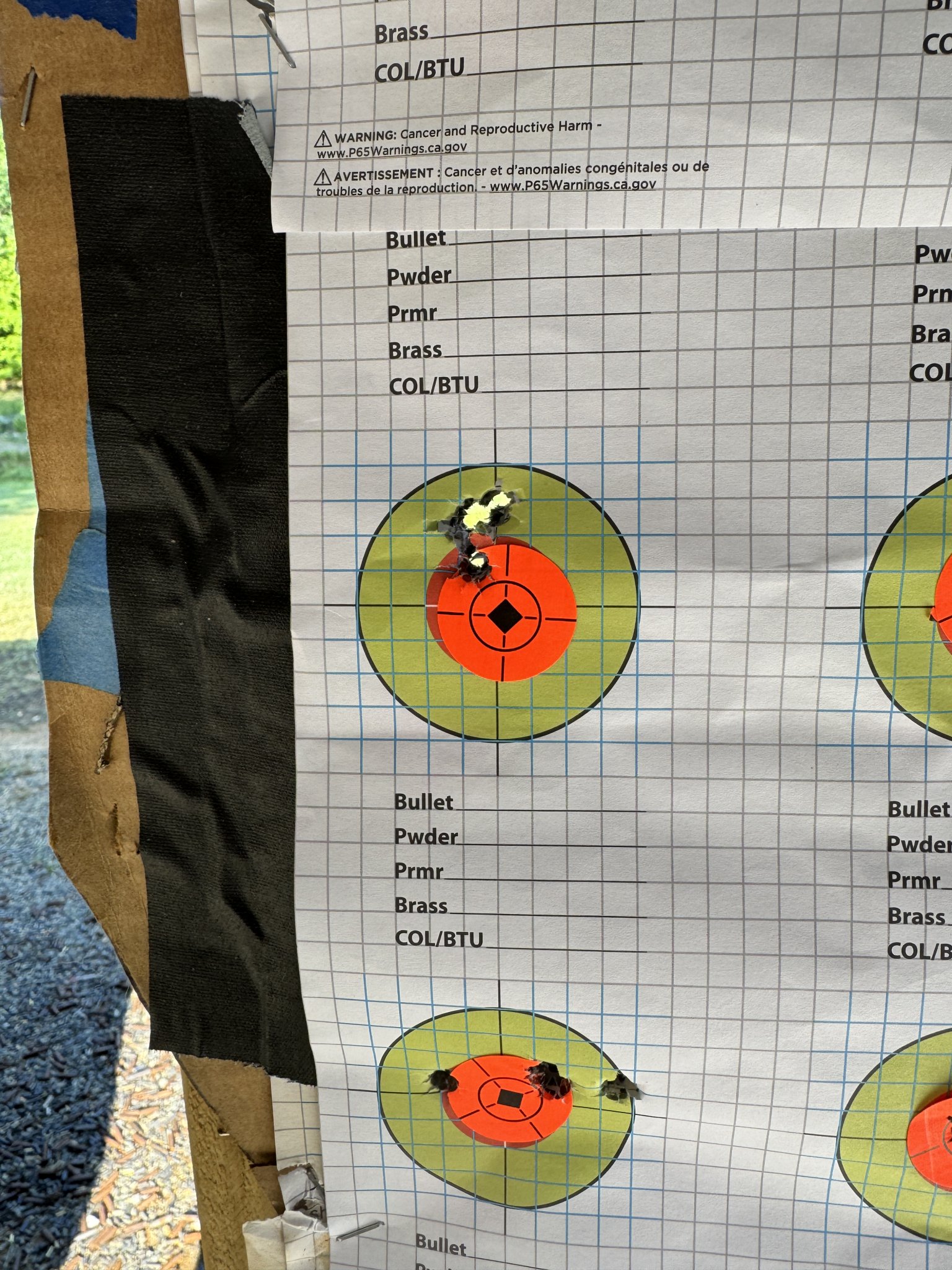

    Bought this 16” Grendel to play with, and have as a medium range do it all style rifle.
    I hated the stock, put a cheek riser on it but that didn’t do it for me. After a range session, I was getting decent groups, .8-1” but wanted better.
    I got tired of waiting for magpul to release the stanag stock so I could use my AR mags.
    Ordered a magpul hunter and MdT 6 arc aics mag. Feeds awesome!!!
    Threw a timney trigger in it and an anarchy outdoors titanium bolt handle. Super happy with how this thing turned out. Range time will be next week.
    Can’t wait for my nomad 30 to get out of jail. The nomad L is sooo long on these short rifles
    I love the short general purpose rifle concept. I've got a Ranch 5.56 and have thought hard about getting the Grendel version.
    Are you reloading for it?
    Yes, using 123 and 8208, at 28.6, I haven’t seen pressure yet but that load was putting me at around .75” 5 shot groups and 2415-2420fps.
    I’m going to try 28.8 and 29 and see if it tightens up.
    Just changing the stock may tighten it up.
    I had a Grendel AR once and i had the best luck with CFE223 and 123 AMAX.
    How was the feeding with the factory stock and AR mags?
    Didn't get a pic of the group, but seated my bullets out longer than AR mag length, since Im running the mdt 6arc aics mag.. Velocity isnt where I want it, but not bad I guess for 8208 in a 16" barrel... Ive got 16lbs of it, so its what I have to run.. Would like to see if CFE223 got me more, but probably not worth the extra fps to spend cash on new powder.
    Shot 5 rounds in a dime sized group at 100 yards.

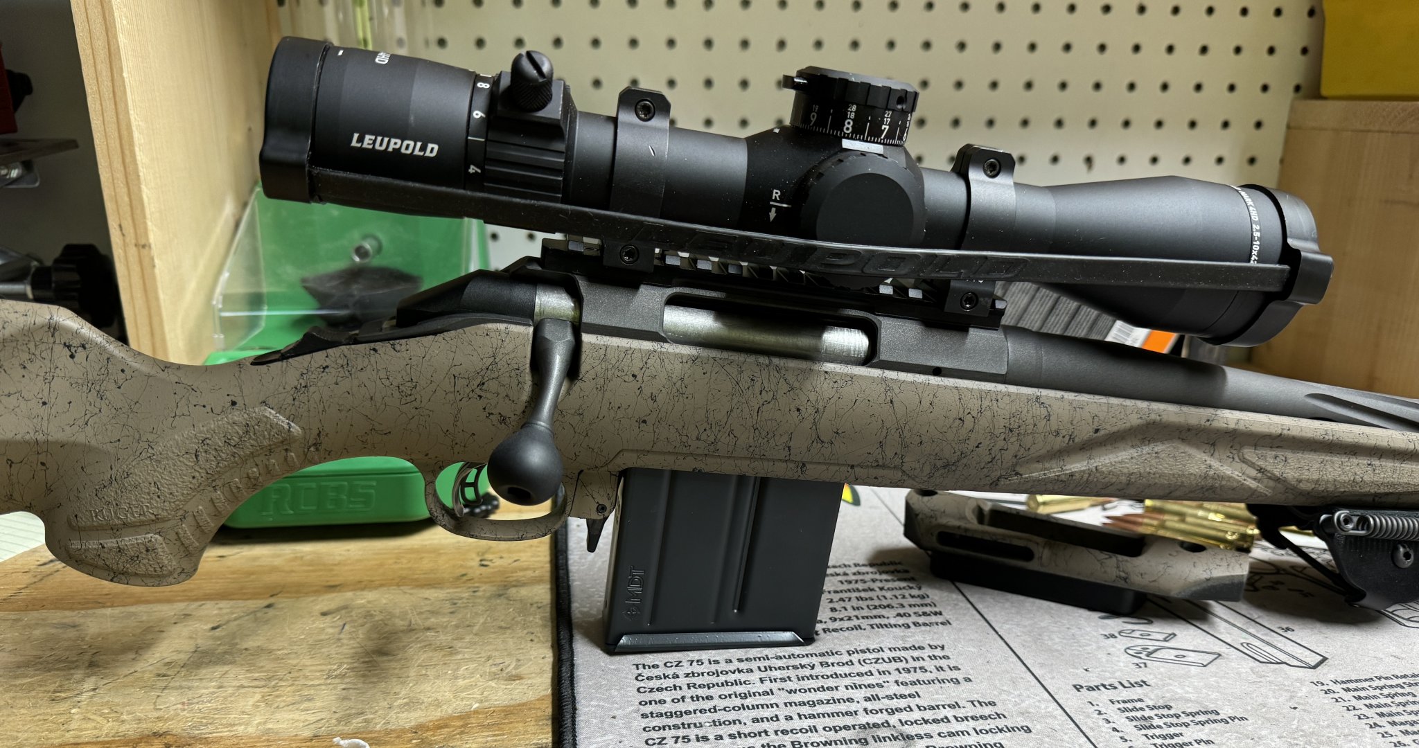

    I have the Gen 2 16” now and even though I like the stock, I hate the mags, so I’ll be switching it to something with AICS.
    I’m using benchmark this go around and have tested 100 eld and 123 eld.
    I had solid .75” groups with the 100’s at 2583fps
    And the same with the 123 at 2350. I’m going to bump up the charge and see if I get more speed.
    Here’s 27.4 and 27.6gr of benchmark with the 123
