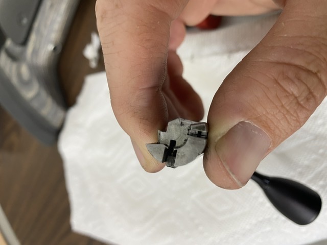

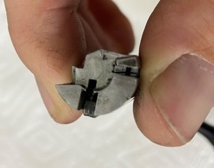

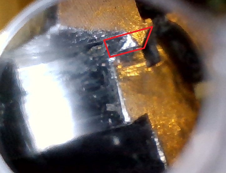

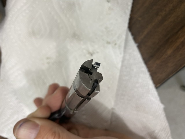

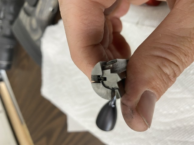

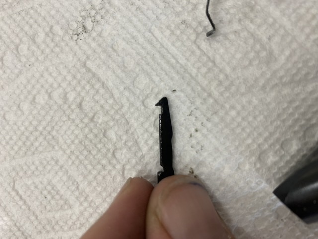

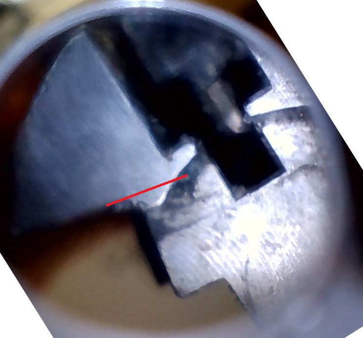

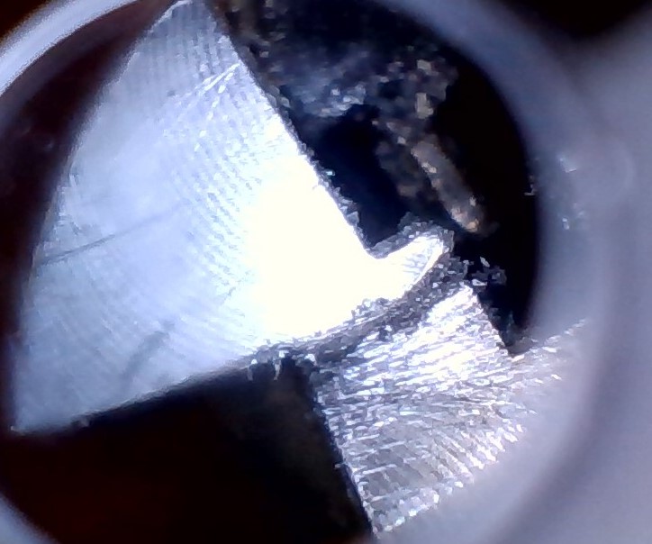

    I've got a RPR that I put a shaw barrel on this week. This gun had ejection issues that seem to have plagued some of them. I've filed off the little knotch on the bolt that was catching the ejector spring clip on the left side of the bolt (and later someone has made a vid about that fix) and bent the spring in giving a bit more pressure and it ejects great now.
    I had done a couple of sessions with the factory barrel and was looking for better than I was getting though I may need to revisit a little on that.
    After reading a lot on the interwebs about the Shaw barrels having tight chambers and being hard chambering I put the barrel on with a .010 aluminum shim to give me a little more chamber length and make it less likely that it will stick loaded rounds. I may eventually try it with out it too.
    Took it to the range today testing new lot of Wolf Math Target and some Laupa Center-X
    I spent a bit of time getting zeros for 25, 50, 75,and 100 yards. One thing I found was that my Silencerco Warlock does not help this rifle. It opens up pretty badly at longer ranges with the can on.
    At 100 yards I was surprised to find that the Wolf shoots quite a bit better than the Lapua in this rifle. I still have to measure groups but right at 1MOA for the wolf vs over 1½ for the Lapua
    One other problem with this setup. The Lapua Center X fails to extract about one in every 7 to 10 rounds. Not fail to feed, or an ejection issue, you have to pick the fired case out of the chamber. Didn't happen once with the Wolf.
    is this what you did to your bolt?
    What I found was a little notch that didn't get machined out of the bolt that the ejector spring (the curved one) catches on and holds it away from the bullet
    This picture is what it looked like after I filed that away with a jewelers file. (hadn't cleaned it up yet so the filing are still there)
    It's the same thing he's talking about in the video. I found that even after removing the burr in the bolt I still had to bend the spring in a little tighter to get reliable ejection. I've seen a picture somewhere of the new spring that Ruger ships out and it's got a slightly different shape that I am going to guess results in the same thing.
    Took the pictures with my Teslong borescope

    Here is what I found sorry for the iPhone pics, but’s it’s the best I have. I don’t see much that could be removed. Am I missing something?
    This looks exactly line mine and this wasn't an issue for my poor ejections:
    There was two things I did to get mine to consistently eject. One of them I can see in the following picture is that the ejector needs to be bent down to where it's just touching the edge of the bolt (that edge where you see a narrow white space between the ejector and the bolt in your picture). If you slide a case into the bolt, the extractor and ejector should hold it firm enough so that there's not much wiggle.\
    I found it helped to file the extractor on the inside from the point to the junction of the L shape taking nothing off at the tip the more at the L junction so that only the tip of the extractor is making a sharp contact with the cases rim. Again, a case should be held in with very little wiggle.
