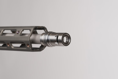

BLUF: Does anyone run Hellfires on lightweight gas guns? I see them all the time on heavy bolt guns. I'm trying to figure out if my use case is appropriate.
I've just picked up my first suppressor (B&T Print-XH) and so I need to switch my muzzle devices over to something compatible and have to pick a brake. I mostly compete in Run N Gun matches where length and weight are critical. I'm a high performer and frequently place on the podium, so I spend more time than some folks optimizing gear.
I expect to run about 80% unsuppressed so my primary criteria is brake performance, not as a suppressor host. Cans are heavy & hot and both of those are disadvantages in a RnG match when you have to run 5-10 miles with the risk of burning your leg carrying a slung rifle with a blazing hot can after a 45 round stage. However, I still want to be able to attach a suppressor on occasion for night matches, etc. I need to outfit 5 rifles. I was originally gonna go with Rearden SPB muzzle brakes and a Wolfpack Low Profile HUB Adapter (lightweight, minimum OAL) and call it a day, but the Hellfire system has caught my eye.
Performance: Hellfire wins, but only slightly
I believe that the Hellfire will stabilize the muzzle better under recoil with less dot movement and allow faster follow up shots. (Based on my experience having shot a 5.56 with SPB and a 6ARC with 3 Port hellfire on them and the 6arc was smoother). On the other hand, the extra weight hanging off the muzzle will absolutely slow down the swing on transitions. Those of you who don't compete may scoff at this, but stages are won and lost by tenths of a second, so these small factors do matter.
Resilience/Durability: I think it's a tie
Any plan B muzzle device has exposed threads that can be damaged and RnG matches are brutal on gear. Whereas there are no exposed threads on Hellfire. But with a Hellfire system and suppressor, there's no sacrificial baffle to protect the can to take some of the abuse to the can with a short barrel (which is where the majority of my usage will be). So I think these factors balance out.
Price: Hellfire wins
The difference here isn't enough to sway me 1 way or the other, so it's a moot point, but just to be thorough.... It would be $300 for Hellfire (I would buy a 2 Port Hellfire + 4x universal adapters). It would be $400 for Plan B (5x Rearden SPB). I only plan on buying 1 Hellfire brake, at least to start, since it's so easy to swap the brake from rifle to rifle - basically QD.
Length and Weight: Plan B wins
The Hellfire 2 port brake is 2.5x heavier (4.1 oz compared to 1.7 oz) and 0.6" longer than an SPB.
Thoughts?
