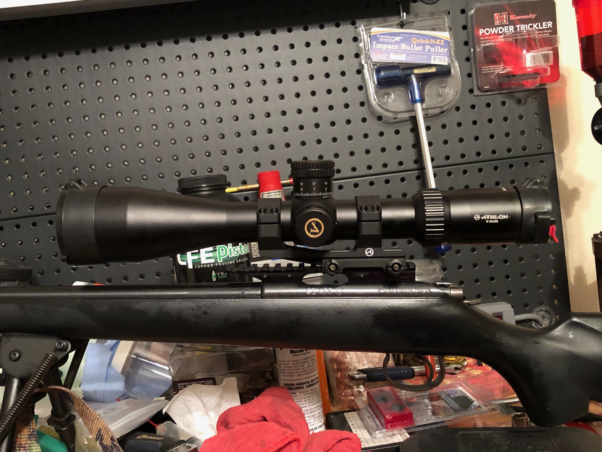

So I topped out my Athlon Helos at 400 yards. 30moa rail on a CZ 455. Dialed up 22.2 mil I've got 0.2 or 0.4 left to go. I have a full rotation plus 2.0 or 6.0 mil, I can't remember how much, but its over 10 mil. A 20 MOA scope mount is on the way. I think with 50 MOA I should still be able to zero at 50 yards but be able to dial and then hold over out to 550. Cross my fingers it works.
A buddy of mine says I should leave it the way it is because running the scope at the bottom of its travel is bad for it. Yes, I normally run 50-110 yards, but I really like going long with the 22. So what am I doing running all the way near the bottom? So the image quality is not the best? That's ok. Am I wrecking the spring inside? Windage adjustment getting damaged running that low?
Initially that’s how my scope was when I sighted it in @ 50 yds with 55MOA of cant built in (30MOA A419 rail + 20 & 5 MOA shims in the Burris XTR signature rings). Took out the 5MOA shim leaving 50MOA of cant and now have about 2MILS of down remaining in the travel.

Mount is on, 50 moa now. moved the turret 5.5 mil down so 50 yards should still be on paper. Still have 5 mil to the bottom. should be able to crank and hold way out.
