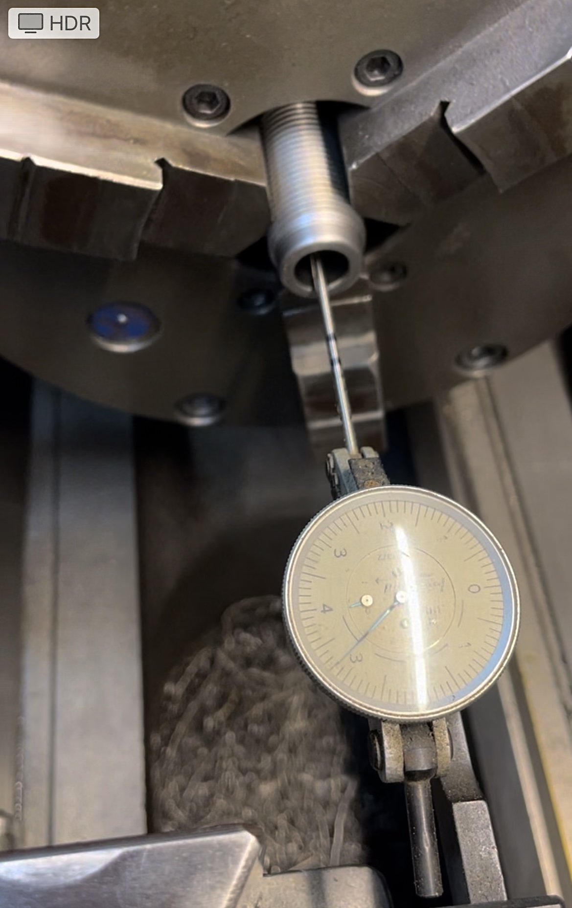

So I was quite surprised to find ~0.002" runout of case mouth from case body in resized brass (AMP-annealed after every firing). So I took the following steps, in order shown, to isolate the runout source.
  1. Insured the neck bushing was floating in the size die. It was.
  2. Allowed the die to free-float in press threads. Made no difference (shoulder bump consistent +/- .0005").
  3. Put the die and .266" neck bushing in a buddy's single-stage press (I'm running a Dillon RL-550). Multiple cases resized, showed exactly the same amount of runout.
  4. Swapped neck bushings - used one of his .266" bushings. Made no difference.
  5. My buddy - a respected gunsmith in our region - was intrigued. So he put the die body in his lathe to precisely check concentricity at several points on the exterior and interior of the die body (photo). After alignment, concentricity of the exterior body was found to be perfect from top to bottom - but the interior showed 0.002" runout.

The runout is definitely in the die. The photo is a screen cap from video. Running the dial indicator around the outside of the die at several "levels" bottom to top showed near-perfect concentricity (the one/ten-thousandths indicator barely moved). But running it at different levels bottom to top inside the die showed runout at the top.
The only way I can think of to "prove" whether the little bit of case body/neck runout makes any difference is to borrow a size die that gives me perfect body/neck concentricity and compare rounds sized with it vs. rounds sized with my die. Having tested seated-bullet runout effect in my early days of precision rifle handloading and finding practically none, I wouldn't expect this "flavor" of runout to be any different.

Thinking out loud ... you said, "After alignment, concentricity of the exterior body was found to be perfect from top to bottom - but the interior showed 0.002" runout."
Your friend aligned the outside of the die. Since the runout was zero, we can conclude that the die body was round and that your friend did a good alignment job. That is, if the die body is round and you align the outside, then runout will be zero. I had to be. The way that you can tell when you do a good job aligning is if the runout is zero. Watch a guy set up a barrel for chambering.
So the die body was set up in the lathe and you indicated the inside and saw two thou of runout. As far as I know, the sizing part of the die is made about the same way as chambering a barrel - you drill a hole straight through the raw die body then run a reamer into the die body following that hole. So where did that .002 runout come from? Could be that when they made the die, it was not aligned as carefully as what your friend did. Could be that the hole was not straight or not centered. Could be they made cuts that were too long and the heat and pressure distorted the reamer.
I tried to read if you did this - maybe I just missed it - did you try to indicate the inside of the die? Then you could tell if the "chamber" inside the die was round or oval.
A real machinist (not some random jackass like me) can probably come up with other reasons for the problem.
