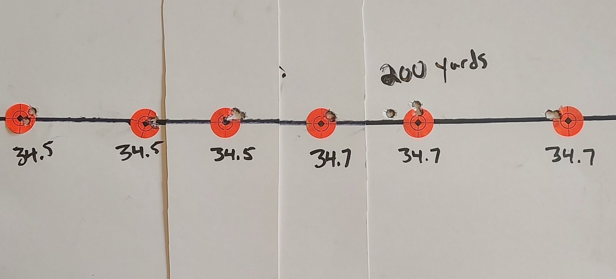

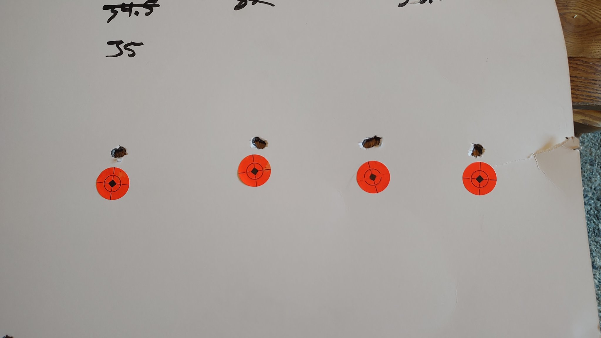

    Well, it appears he is correct. I went to the range today and did some load development. I brought 20 rounds with me that had .005-.008 runout. Here's the verdict.
    Load development with no more than .003 runout
    Ones with a lot of run out. Not seeing much difference.

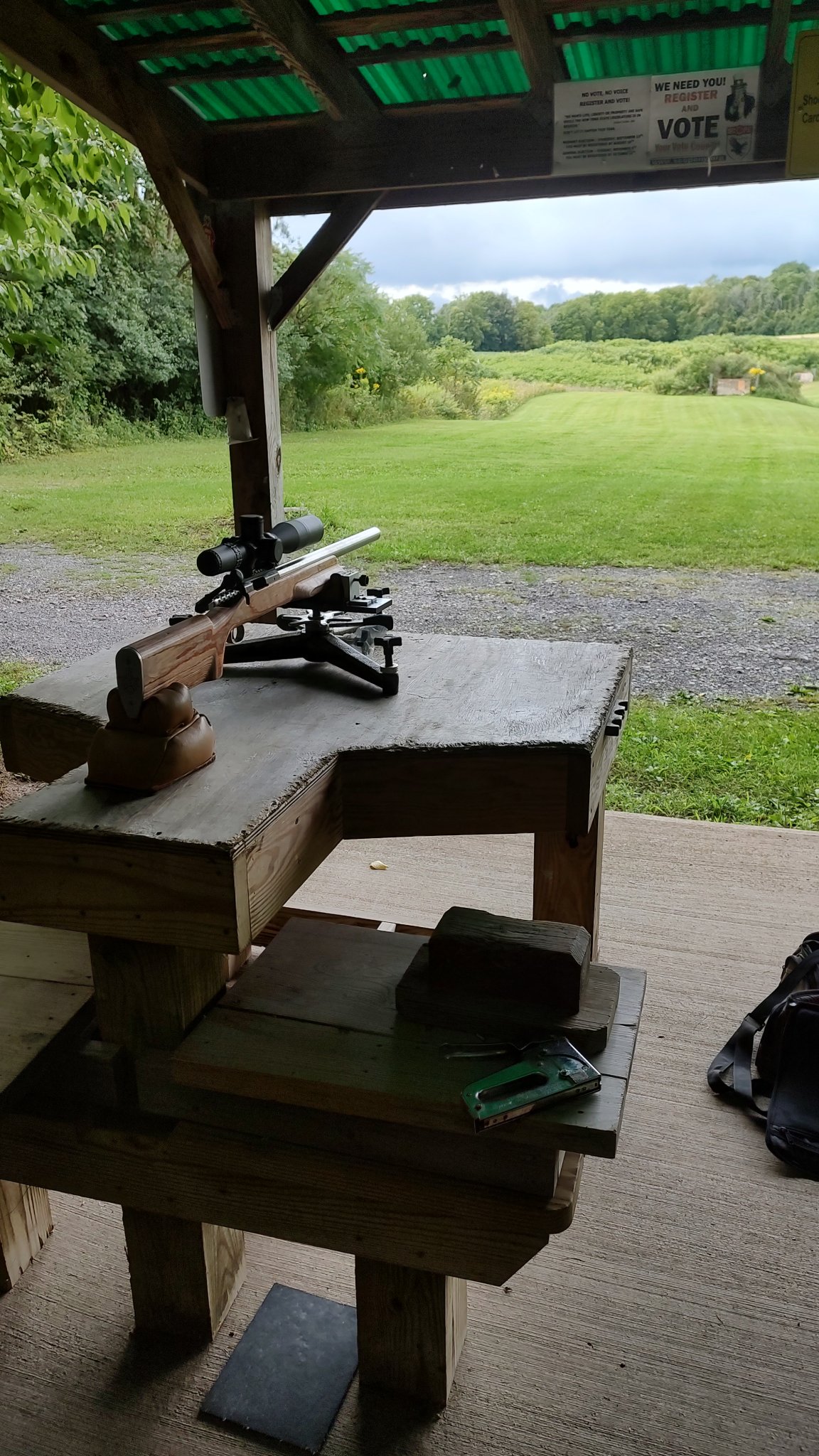

    It's a 30BR. 34.5 and 34.7 both had a .0s I believe. I'm actually not shooting any class. I just wanted a bench rest caliber in a benchrest quality build. The action is a Kauger BRii with a Krieger barrel chambered by Alex Wheeler, and a guy named Randy Owens at precision woodcrafting made me the stock and bedded the rifle.
    I was fireforming brass with 125gr TNT speers and still getting groups in the .1s and .2s
    Now I'm shooting barts and Ken Hottenstien bullets. I've shot probably 200 rounds and the average group size at 100 yards is like .150-.190
    Lots of high .1s with low .2s mixed in and a few .0s
    New favorite gun, and way more info than you asked for. Haha
