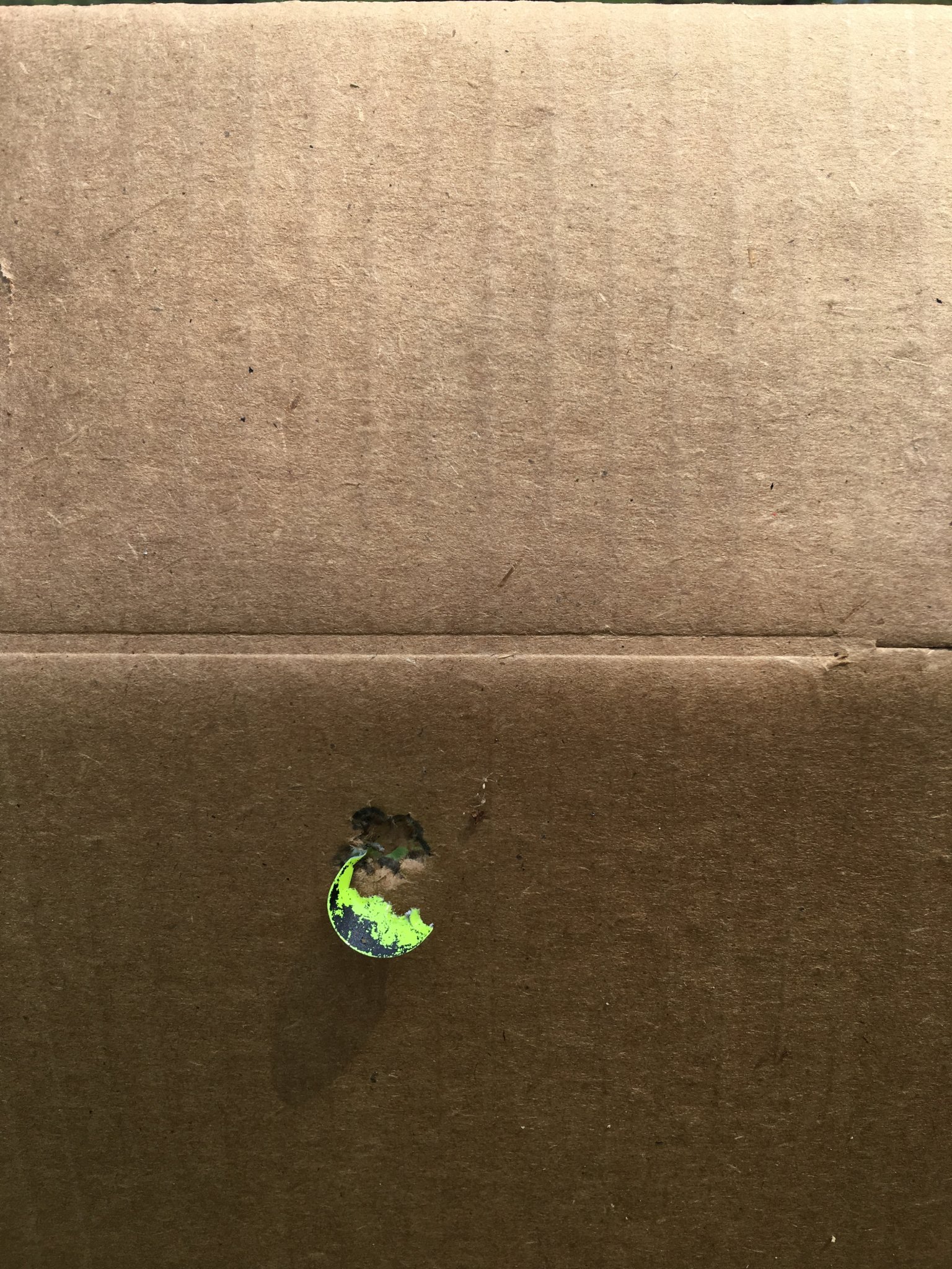

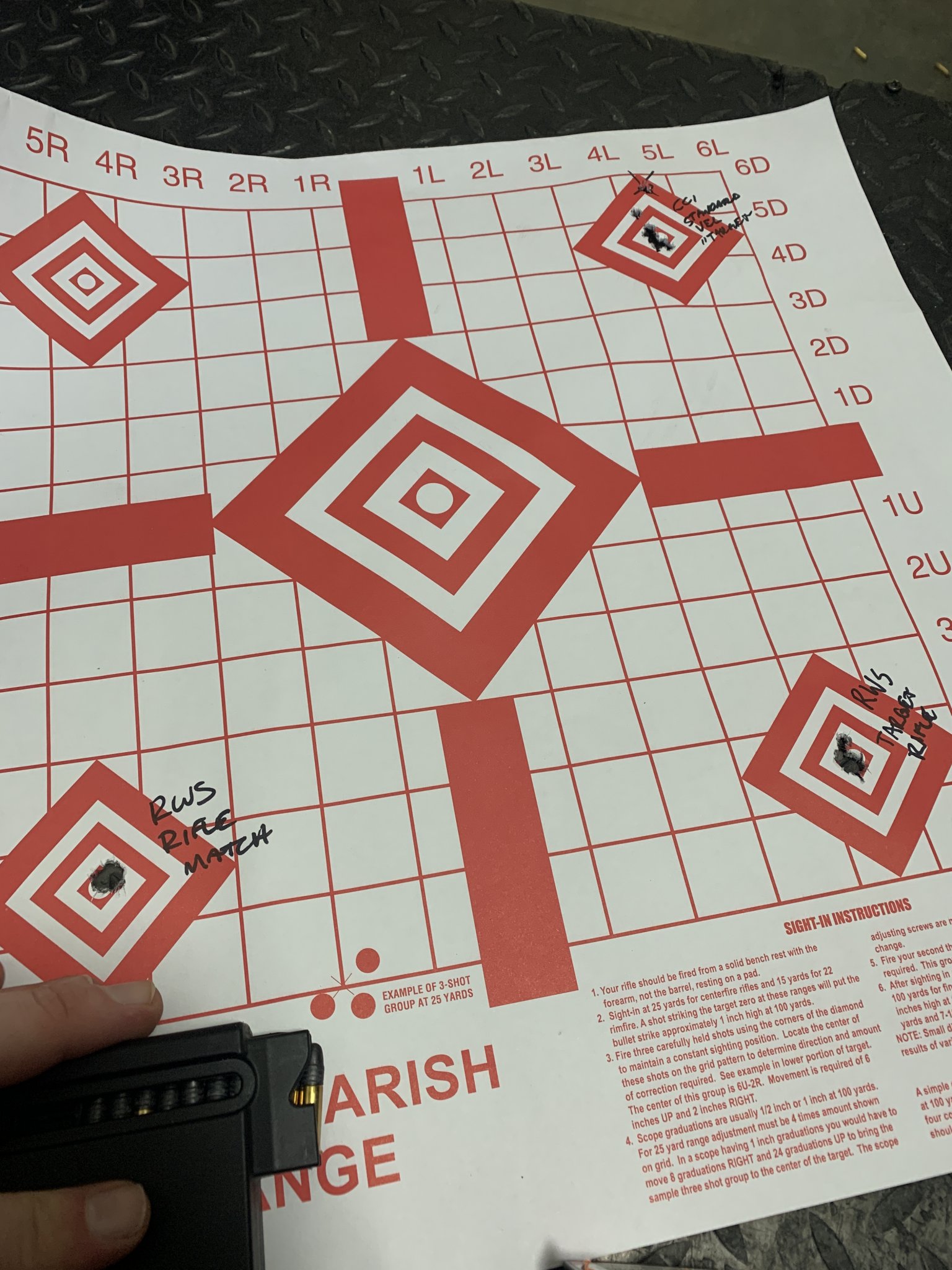

Center x and cci standard shoot the same for me too 100 here’s 10 at 50y
Reactions: BuckeyeSniper
