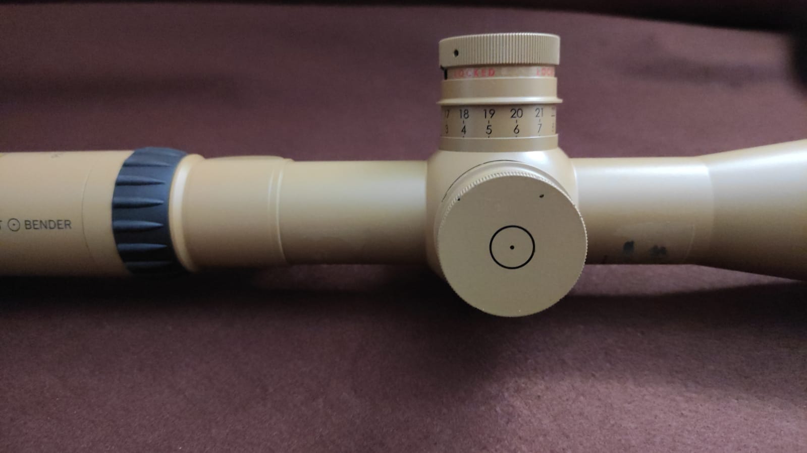

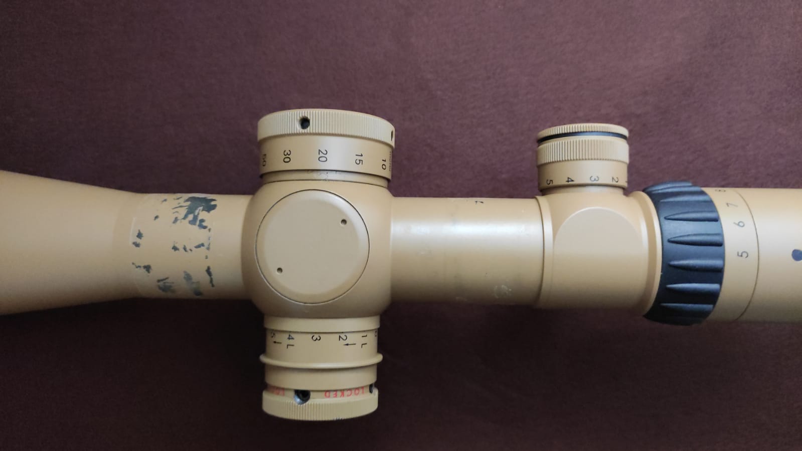

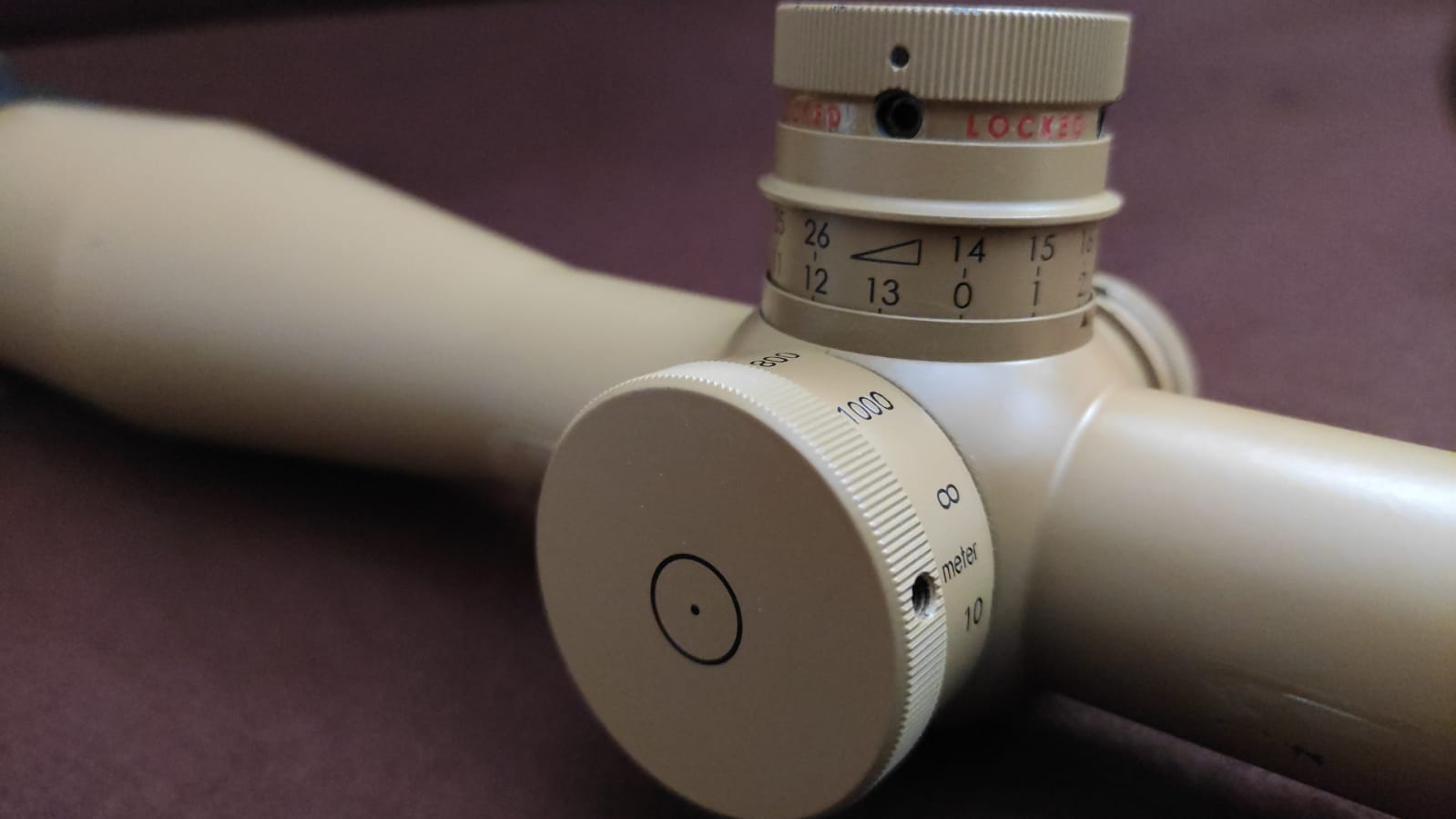

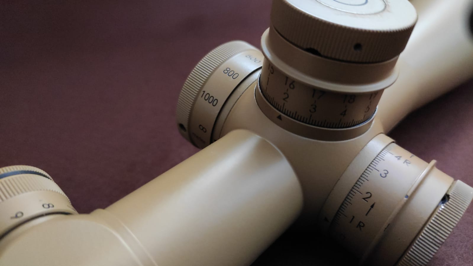

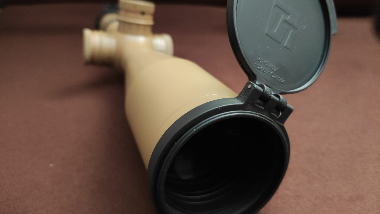

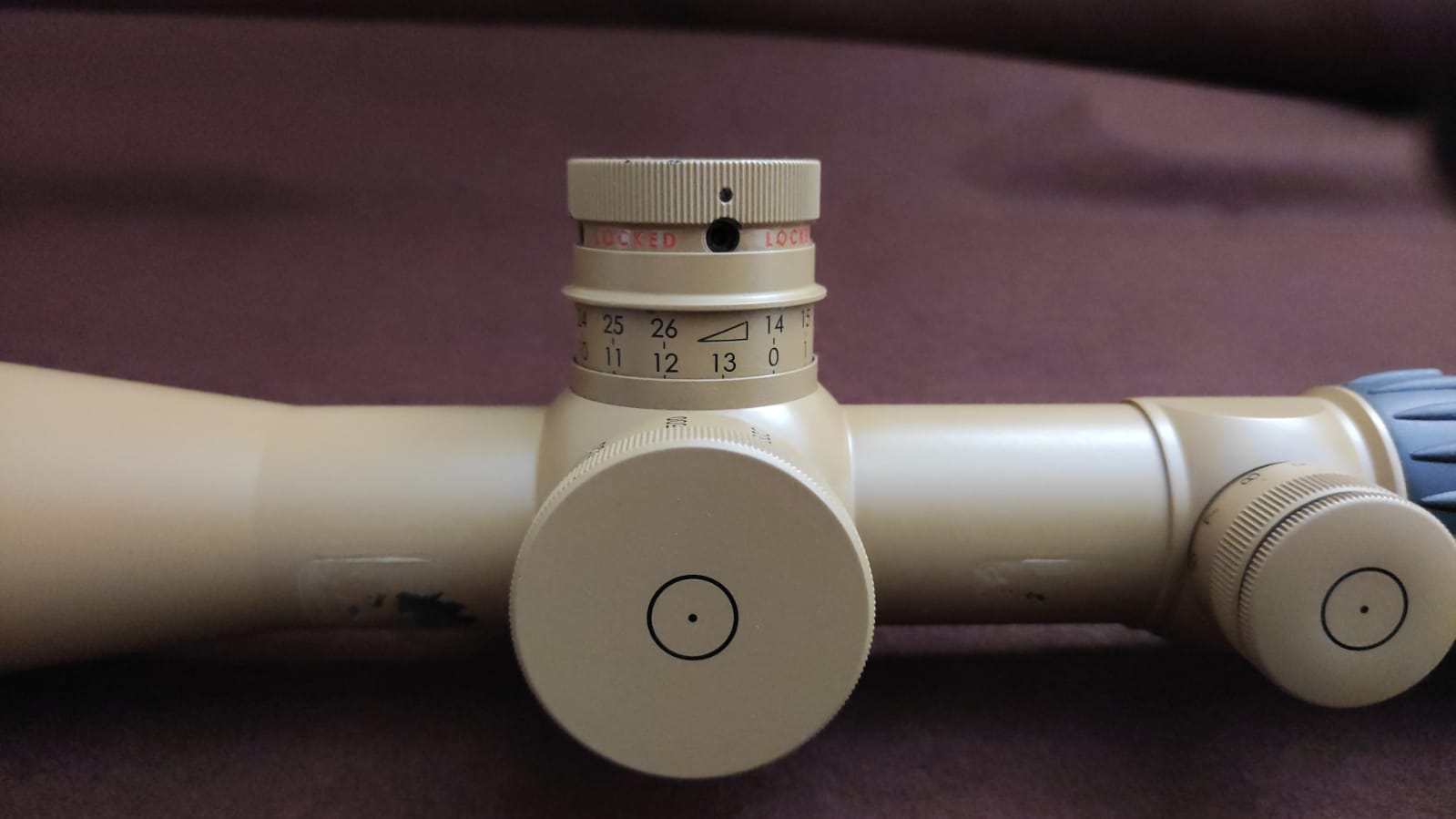

I just received some pictures from the 5-25 i mentioned above. Don't know what to think about it. Is it worth nearly 2700$? It costs about 3800$ new over here.
Maybe it's better to wait for another one but they're pretty "rare". (only about 4 used ones on the market right now in Germany and Austria, all of them way to pricey or sfp which i don't want)
It looks pretty good. The paint on this scope is very soft. The fact that the paint on turrets are good, means that scope didn’t see much use.
That would match with his story. Rarely used but paint damage because of the glued mount. It also looks like the tube wasn't squeezed or anything. (as far as i see it, maybe the optic experts here can tell me more)
Do you think its possible to cover this with some spray paint? Or better put new rings on it which cover the marks and never think of it again.
Main tube has the most wear, but if you look close there is some paint spots missing from each turret.
I get wanting it to look perfect when spending that much money, but the paint wear might not be a bad thing. Just like guys that have exspensive classic cars they never drive for fear of that first ding or scratch. If it was too perfect you might be too worried about usage marks to fully enjoy it.
Only you can decide what's right for you though. There will certainly be more deals down the road if you pass on this one.

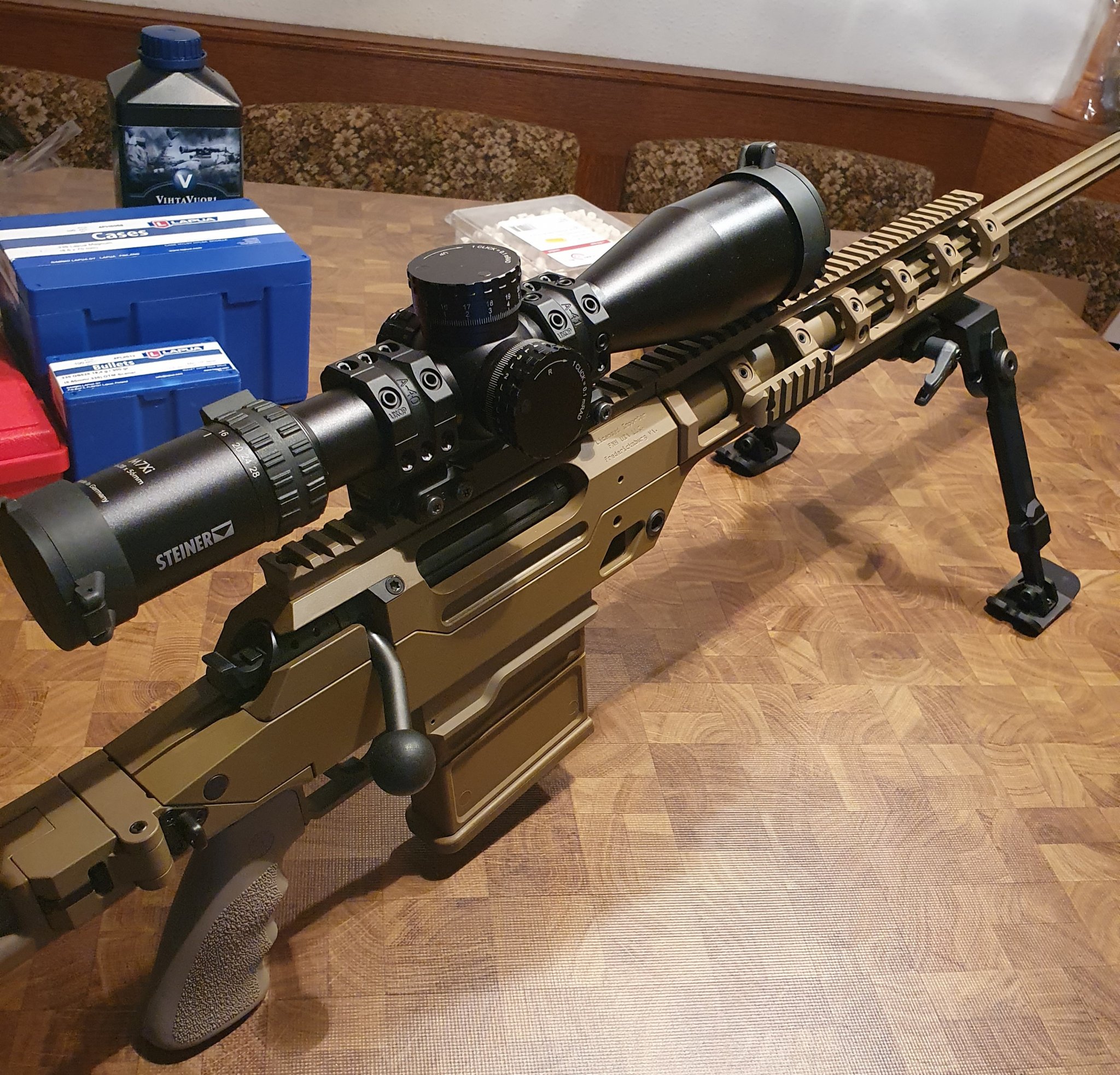

Hello!
I got the Steiner M7Xi today and it`s a damn good scope. The MSR-2 Reticle is a bit fine at the low end but perfect in the magnification i shoot mostly. (16x +)
Can't wait to take it out to 1000 yards but thats only possible at events on military shooting facilities here in Austria and theyre currently closed to the public because of covid....
Thanks to everybody who helped me!
