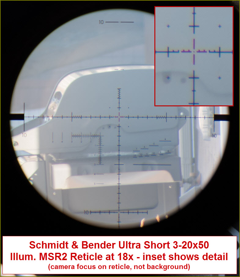

I believe that scopes with the LRR-MIL reticle are the only models that currently have daytime illumination in the current model lineup. Sort of a requirement though if using this reticle in vegetation or any dark background. Glaring sunlight, setting #9 out of #11 is way plenty.
This is a "new thing" for S&B illumination. Whether or not they will make this available in other reticles is unknown.

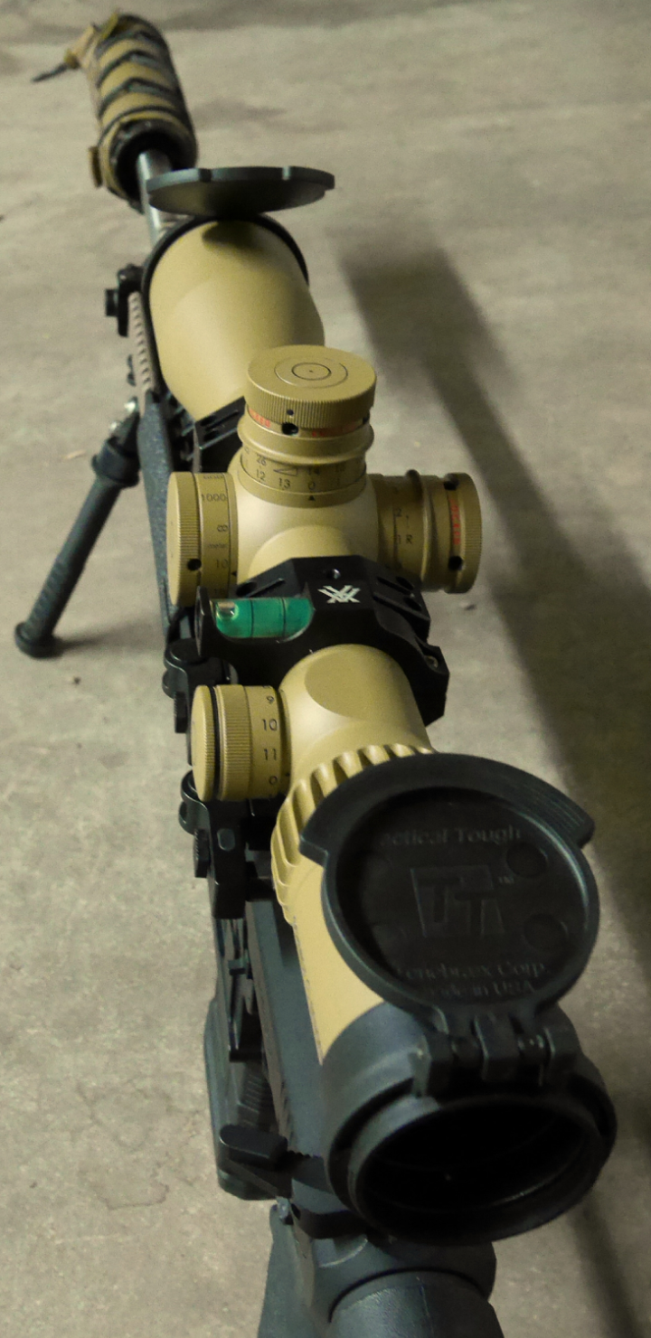

I almost thought that was a Vortex ring with a built in bubble level until I realized it was just the angle the pic was taken. Outside of the illumination tumors, I've always liked the looks of S&B scopes.
