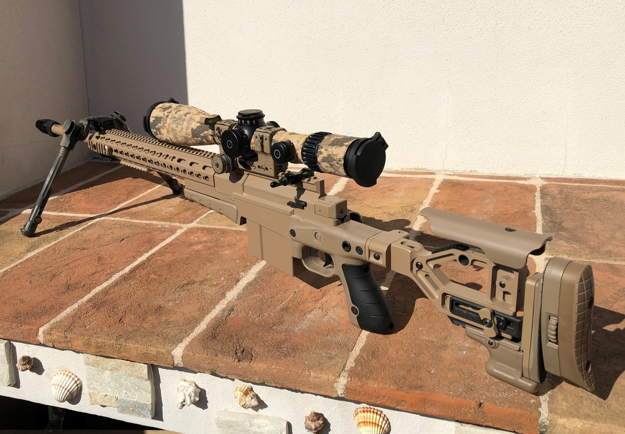

I have a S&B 5-45x56 with LRR-MIL reticle.
Great pic. What elevation/cant do you have on that Spuhr mount? By my calculation, a 3 mil mount would maximise scope elevation adjustment without going too far.
The Spuhr mount have 0 MOA of inclination.
The elevation turret have a sufficient range of regolation for shot over the cartridge range.
Excuse me for bad english….
Ah….. the AX piccatinny rail have a 30 MOA of vantage
Thanks Mark, I understand. I had taken into account the 30MOA rifle rail. I was looking to add more elevation to the mount to maximise up-elevation range of the scope/turret (whilst retaining some down adjustment).
