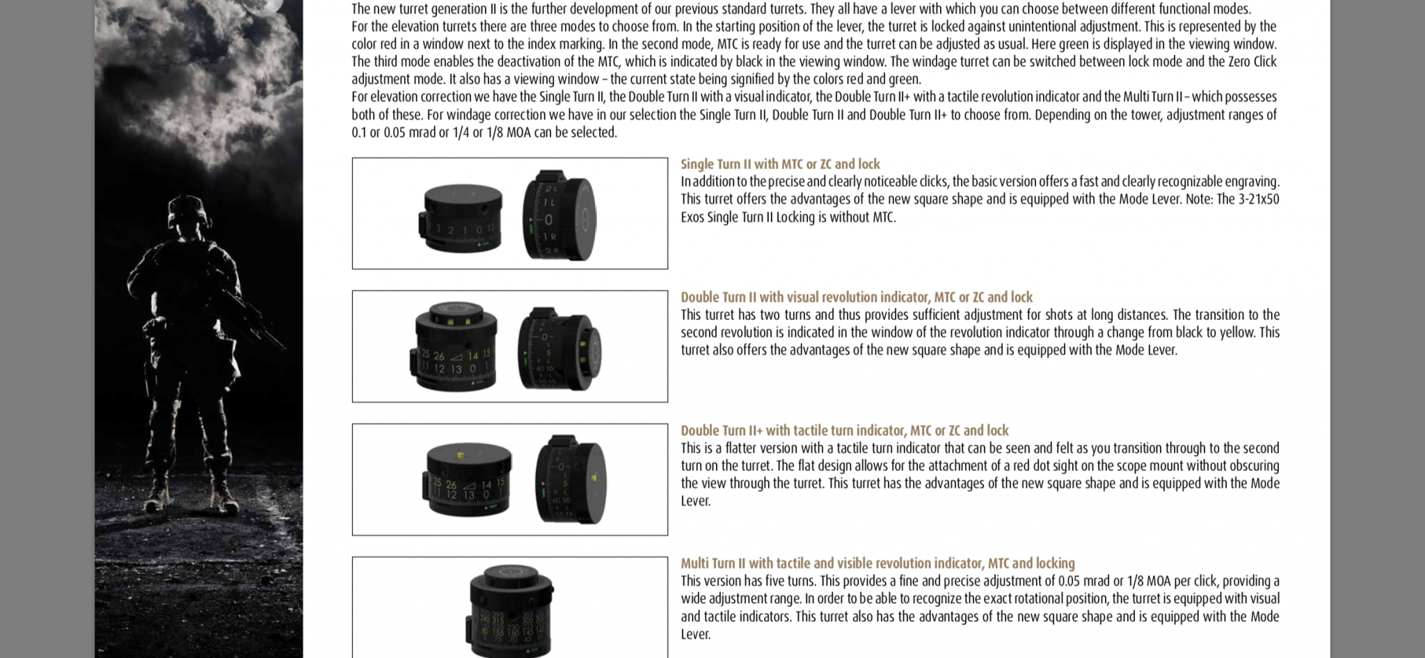

    Are you sure you got MTC ? For 2019, the new scopes come with low profile turrets, and look just like the MTC, but are not MTC. The MTC funtion is offered as an option, but is around $75 more.
    The low profile turrets come standard for all 2019 PMIIs or they are another option that is offered?

    Take a look at the S&B 2019 catalogue online. You will see the new turret design. I’m not sure if it’s an option or standard?
    I think I’ll likely have to wait until I have my new PMII in hand before jumping to conclusion. Hopefully shipping end of April/early May, though someone may confirm on the turrets before this.

    True. The stiff MTC is one of the frequently mentioned "weaknesses" of these style turrets. I have a few DT's versus the MTC and really like those, but I'm liking this particular MTC if it's the norm. Essentially it does away with that weakness entirely, at least on the one that I own.
    There is a procedure to remove the MTC entirely, and after looking at the procedure I'm sure I could modify it to only lighten it up instead of disable it. Will I though, most likely not. I'm all about modification for the better where applicable, not all about voiding the warranty on them though.

    There was a price increase in April for all Schmidt scopes. That's probably why you are seeing higher prices. The 5-25 turrets have not changed to my knowledge from previous years. I'm looking at their dealer price list right now and the description of the turrets is the same as it was last year so I would not expect any changes.
    The do however offer the DT/LT/MTC turrets with MTC disabled from the factory.
