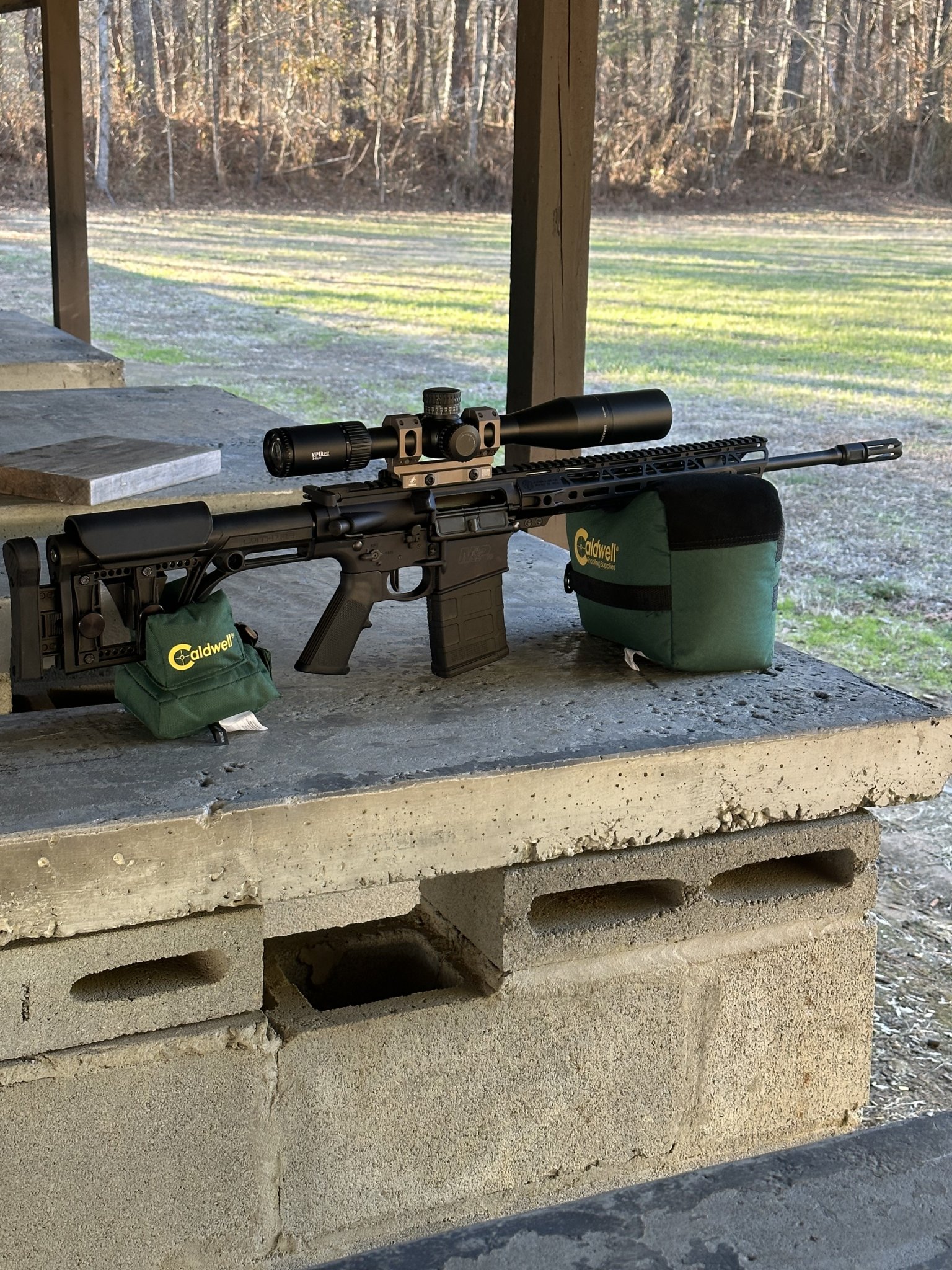

    I’ve got the M/P 10 6.5 performance center. I’ve changed out few parts so far. Put a Magpul UBR gen 1 stock, Radian charging handle, hogue grip, NF NXS 3.5-15 Mildot Optic in Warne mount. It’s the most accurate weapon I’ve ever shot. It literally puts all the rounds in the same hole. I’m not a great marksman and it makes it easy. Everyone that has shot it puts rounds in the same hole LOL. 100 yards is the furthest I’ve shot so far. Anyway, I love the thing it’s just kinda heavy.

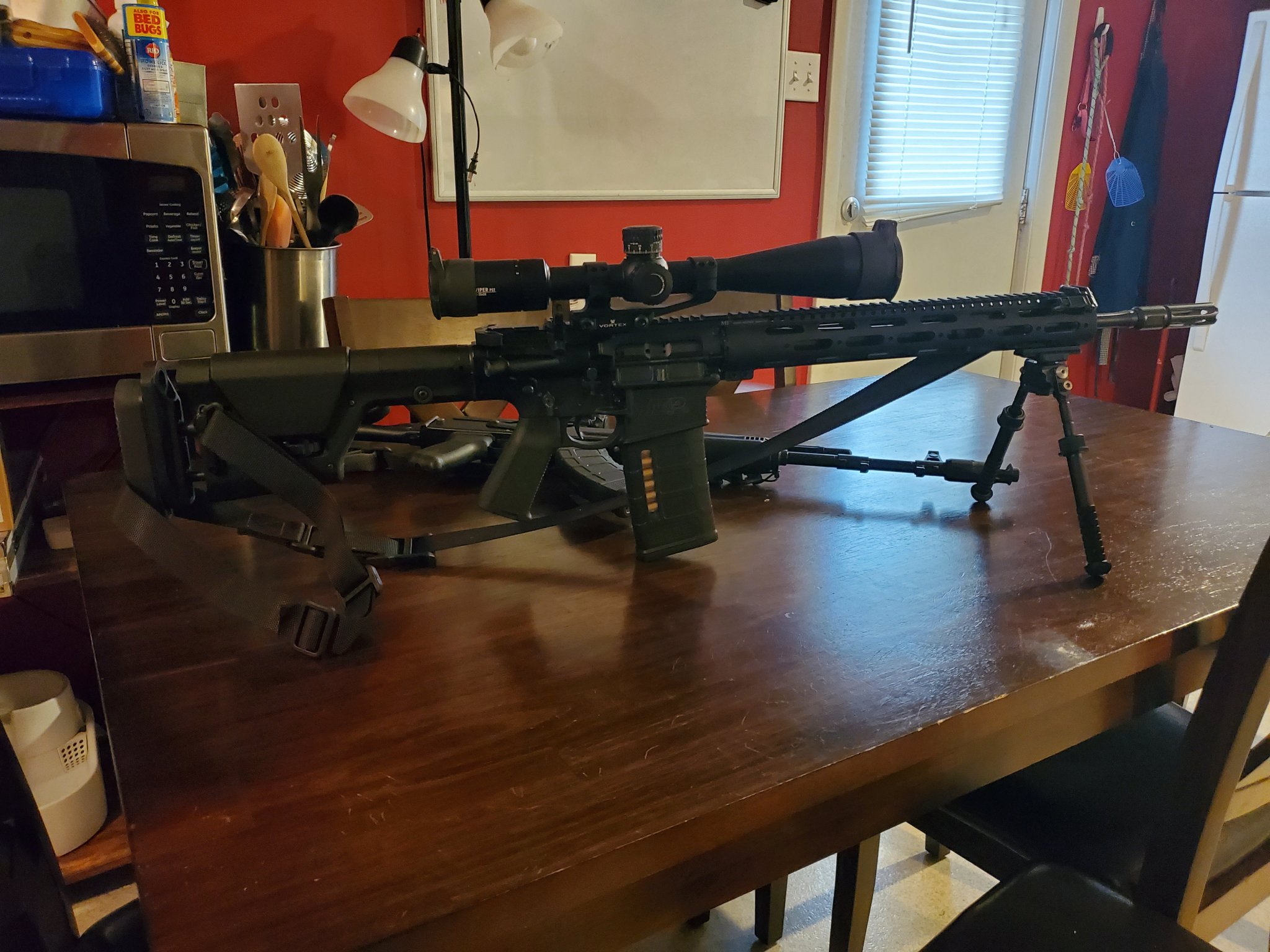

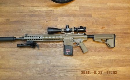

    I'll just add to this thread instead of starting another. I bought one of these in Feb. Here's my thoughts and a little review of it so far. It wasn't the AR 10 variant I wanted, but it was the only one available locally at the time. I bought this mainly as a shtf rifle due to the political climate at the time. Right now I'm using it as a test platform for upgrades, furniture, and accessories for when I do start building a large frame AR.
    As pictured it has a Vortex GenII Razor 1-6, Apex handguard, Daniel Defense collapsible buttstock, SLR adjustable gas block, SLR combo flash hider/brake/compsensator. Tubb flatwire spring, hogue grip, Surefire Millennium, KAC offset irons, Vicker's sling.
    Now for a little of the bad. I've had a couple issues with it. Minor issues, but annoying ones none the less. The original CAR buttstock was not vertical with the rifle and also a little wobbly. With the rifle straight up and down, the buttstock was pointing from 7:00 to 1:00. At least S&W didn't stake the castle nut. The DD stock on it now is a much more snug fit on the receiver extension, almost too snug as it takes some effort to adjust, but I'd rather have it that way than too loose. Brand new, out of the box, first few mags through it were fine. Then it started short stroking. Put on an adjustable gas block. Still had short stroking even when opened up all the way. When installing the gas block the first time, I had checked the gas port size. It was on the lower end of what a mid length gas system should be, so I drilled that out more when trouble shooting this issue again. I didn't have to drill it out by much. I gaged the hole at .072" and opened it up to .076". Then ordered the flatwire spring and put that in. Short stroking seems to no longer be an issue now.
    Now I'm on to finding what flavor of NATO ammo it likes best. Below is pics of shot groups from my most recent testing. As other's reviews and opinions have stated, I'm finding the MP10's prefer heavier bullets. Who else makes M118 besides Lake City and Winchester? The good Lake City ammo is getting hard to find and the prices for Winchester M118 is absolutely fucking ridiculous! (Take these shot groupings as you will. After a long break from shooting, I'm still getting my fundamentals re-established. 15rnd shot groups with the exception of the L2A2 which I only had 10rds left and one of those was a misfire. All groups shot at 100yds with the Vortex set on 6x)

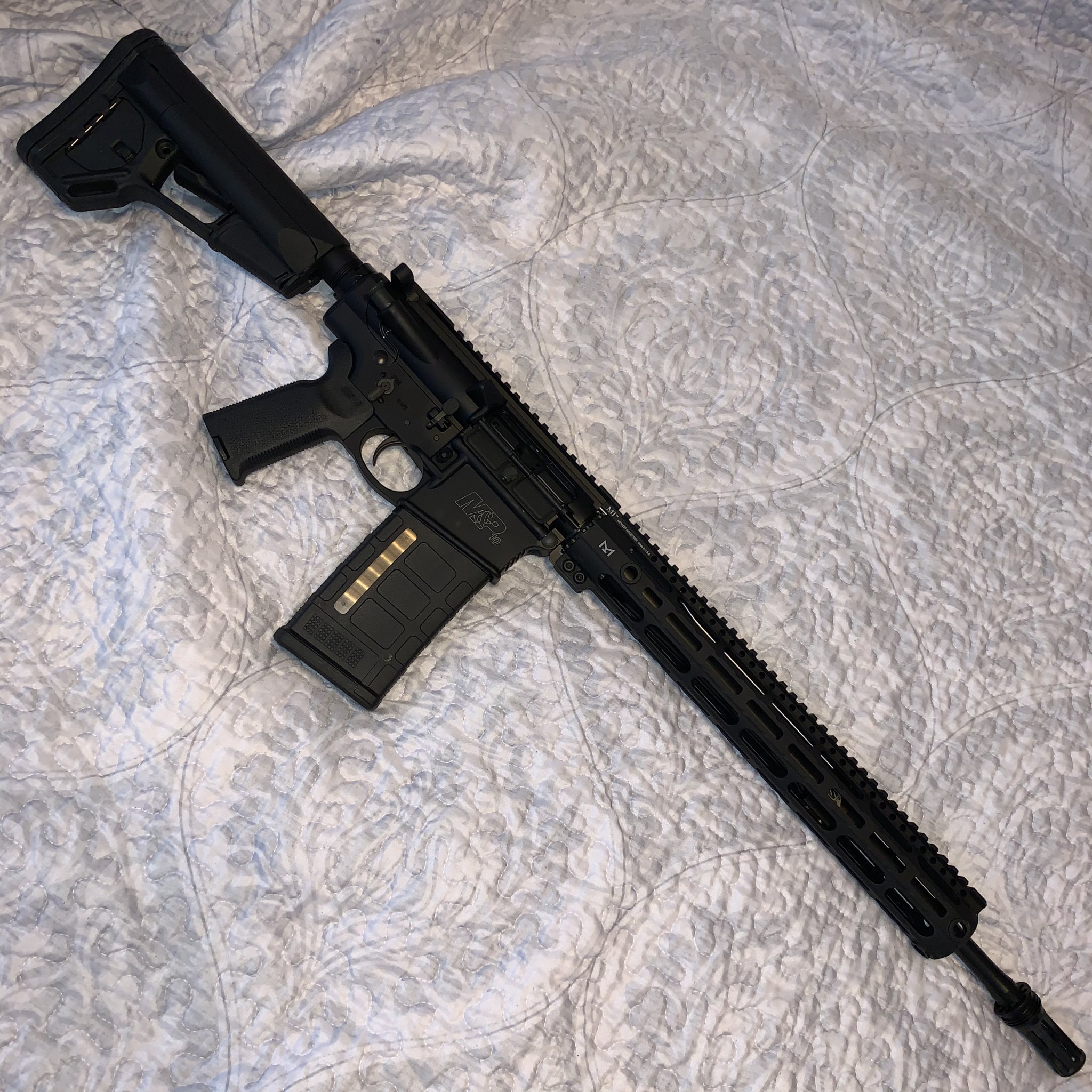

    Looks like a dead thread, but I'll post anyways because I really like the M&P10. This gun is pretty heavily modified, but I haven't changed the barrel or BCG. It's got a Magpul PRS stock, MIAD grip, Radian Raptor CH, Geissele SSA-E trigger, MI full length handguard, Magpul MS1 sling, Atlas BT10 bipod, Vortex PST Gen 2 5-25 MRAD on a Vortex Pro mount and currently a Vortex Sparc Solar dot on an offset Vortex mount.
    Every type of ammo, including around 2k rounds Tul 150s, has run flawlessly except for a case of ZQI that was under pressured and wouldn't cycle. Lake City M80/M118LR, Federal GMM 168s, Norma Whitetail, Wolf 145s, but my go to round has been PMC X-Tac 147s for anything inside of 400. That stuff absolutely fucks.

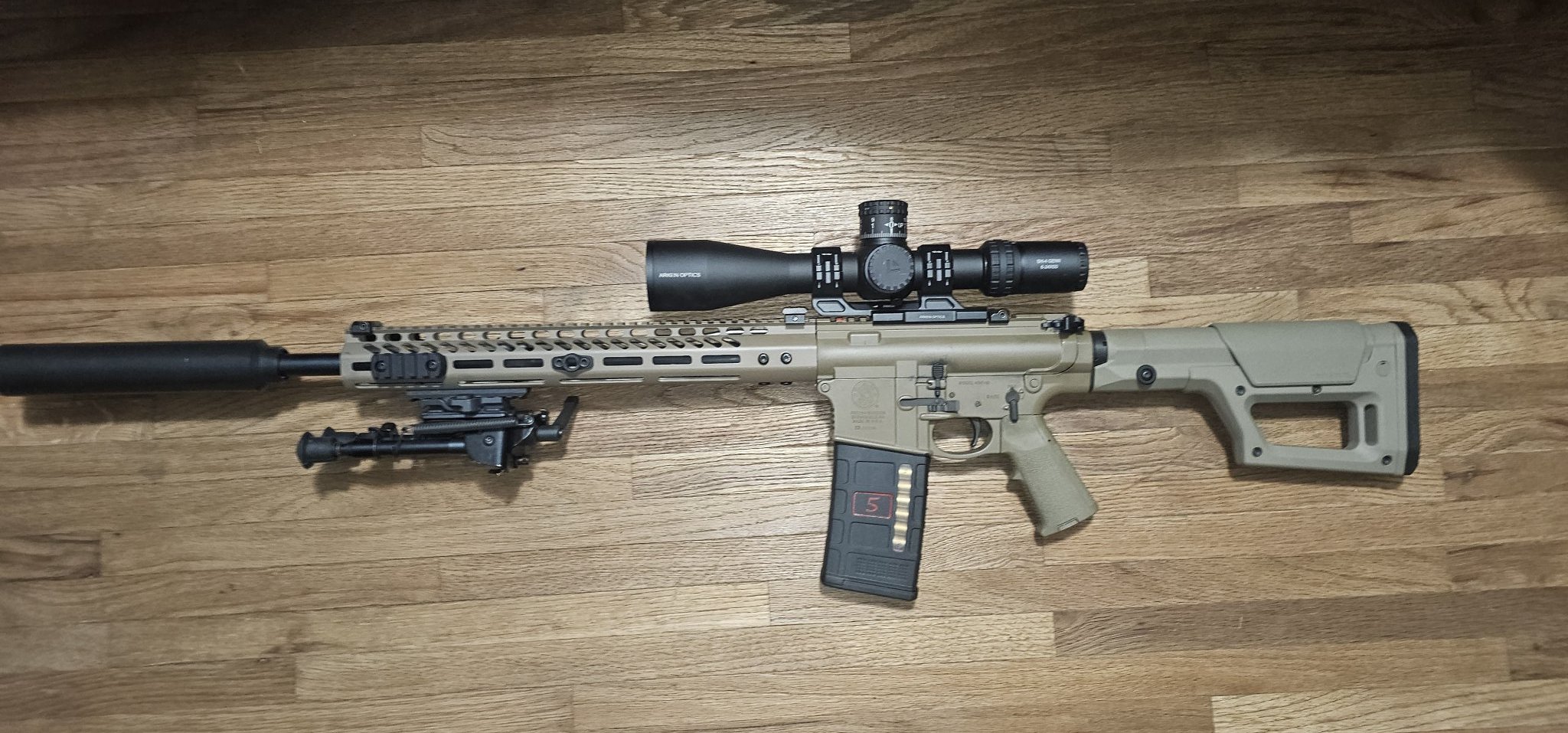

    Loving my m&p10, but will look to swap barrel and BCG to accommodate 6.5cm. What’s the best barrel and BCG for AR’s? Also, anyone know where to find additional uppers?
    I just swapped out the pencil barrel for the AR stoner 18'' Heavy contour barrel in 6.5 Creedmoor with a KAK bcg. Works great! after about 40 rounds I'm @ 3/4 MOA.

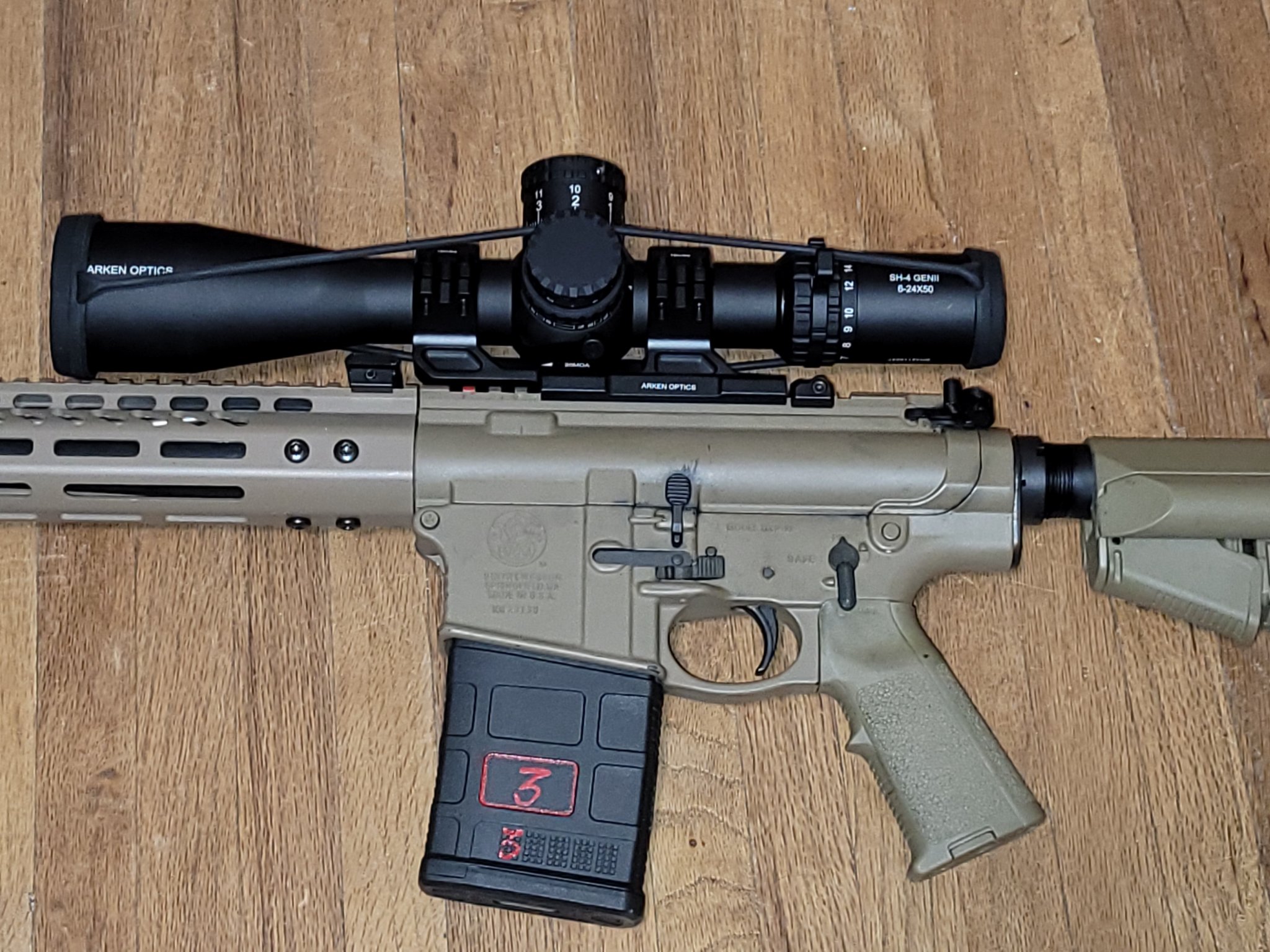

    I bought my M&P 10 in August of 2014 from Buds Gun Shop. I purposly chose the Model 811310 State Compliant model which had the 18" barrel that was not turned down in front of the gas block. Under the gas block is .750" and just ahead of the gas block is .745". I installed 2 different free float tubes on the gun since I've had it
    The gun currently has a Arken 6-24x50mm scope in an Arken mount Magpul MIAD grip, BCM Gunfighter charging handle, dropped in no mods. Magpul buttstock and folding 45° sights. RRA 2 stage trigger. Factory barrel threaded by Adco and a Griffin Armament brake and PHS supressor. Harris bipod with Adco Pod LOC and Arms bipod mount. Inexpensive no name gas block not even adjustable and shoots great suppressor on or off.
    The gun shoots like a house-a-fire. No malfunctions.
