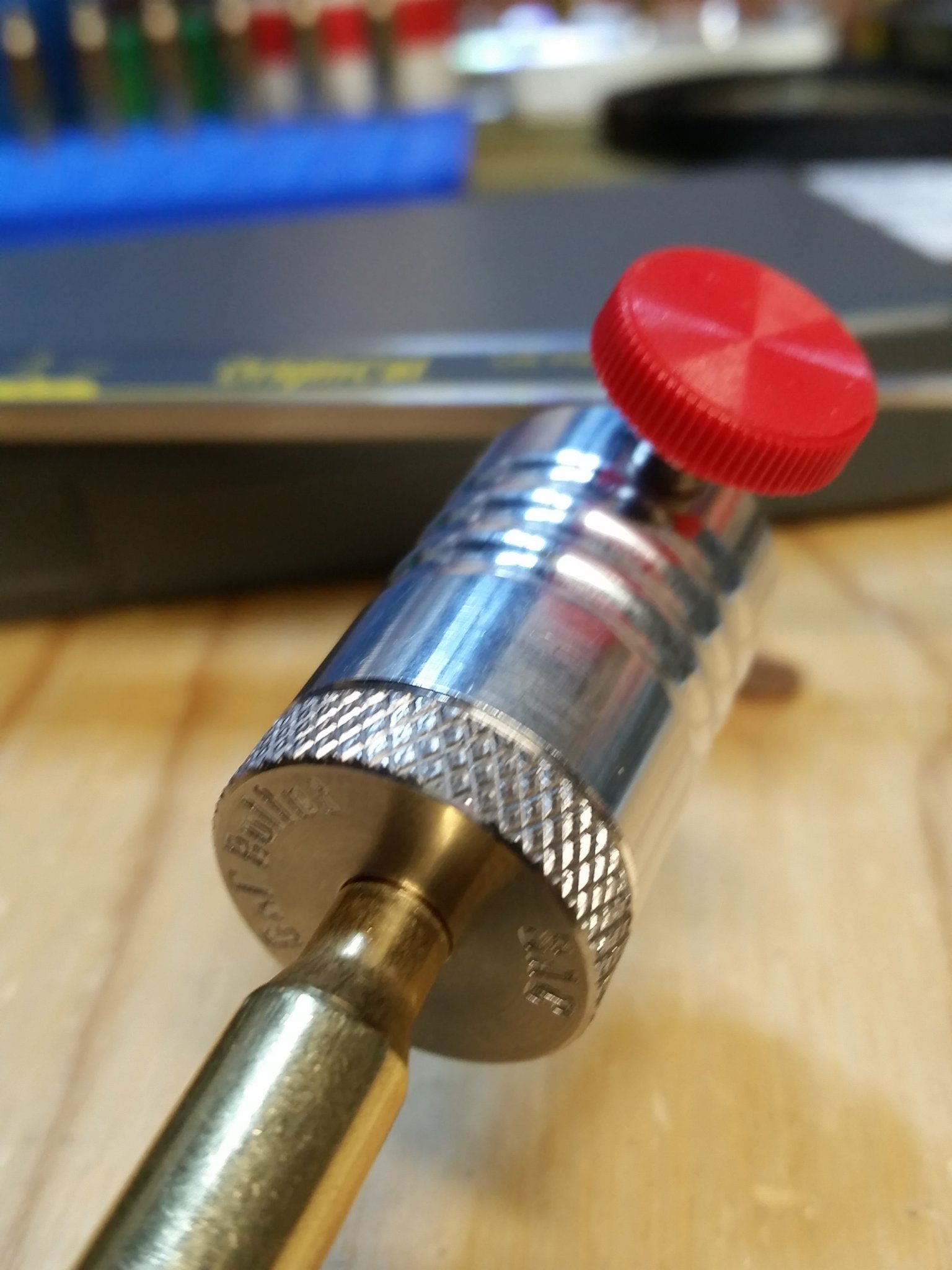

Anyone find your unable to use the SAC comparitor to measure SAAMI length rounds? In this case, a 77g 223 bullet, the tool hits the brass unless you load long.

No . These are as deep as I can go before the tool hits the case. Just 2 examples.
TMK 77g. 2.283
Berger 77g OTM 2.262

I have the SAC body and inserts for .223, 6x47L and .308W. The bore ID for the .223 insert is 0.221". So, if you are contacting the mouth of the brass, I would surmise "that you don't have enough bullet Ogive sticking out of the case mouth" to properly engage the comparator insert the way that it should. In other words, your bullets are seated too deep.
Again, measure the bullet diameter/OD and the ID of the comparator insert. The ID of the insert should be at least -0.002" below bullet diameter. As I said above, I measured mine and it is 0.221". If the comparator measures 0.221" or thereabouts, there is nothing wrong with the insert/comparator.

However as is If you look at my measurements I'm "not seated too deep". Rather both bullets are longer then SAAMI spec (2.260).

OK, So, how does "SAAMI spec" (of OAL) have any relationship whatsoever to various bullets of different tapers/profiles ? SAAMI does not take into account different bullets with various different tapers/profiles.
Just measure the ID of the comparator with your calipers and compare that against the OD (also measured with your very same calipers) of the bullet. Is that so difficult to understand ?
Hint; Different bullet profiles will have different physical locations of where the comparator bore will hit/interference fit with the Ogive. A very small difference in the taper of the bullet will have a huge difference as to where the comparator contacts/interferes with the "ogive" of any given bullet.
BTW, throw your "pin gauges" in the garbage. You're WAY overcomplicating this. SAC sells comparators/inserts. They bore the 0.223" inserts to 0.221", or 0.002" under (actually 0.003" under when you consider that the bullet diameter is actually 0.224").
Hornady and others bore them to about 0.003" to 0.005" under bullet diameter. Not hard to understand. Which one is better ? Neither/both. It doesn't make any difference because the comparator measurements are RELATIVE, they are NOT ABSOLUTE.

Trust me I get what your saying. I just find it odd if I load either of the two bullets to 2.260 (what most manuals quote as COAL) the gauge insert bottoms out.
I have been using the 224 and 30 Cal inserts and loading long in the past so I never ran into this.
The ogive is almost certainly inside the case neck. The SAAMI spec was not written with 77gr projectiles in mind.
A cartridge with maximum case length and maximum COAL as per the specification will have the bullet protruding from the case by 0.500".
I don't know what bullet you're using but, as an example, all of Berger's 22 caliber projectiles heavier than 70gr have a nose length longer than 0.500". They would all have the ogive inside the case neck when loaded to SAAMI max COAL.
