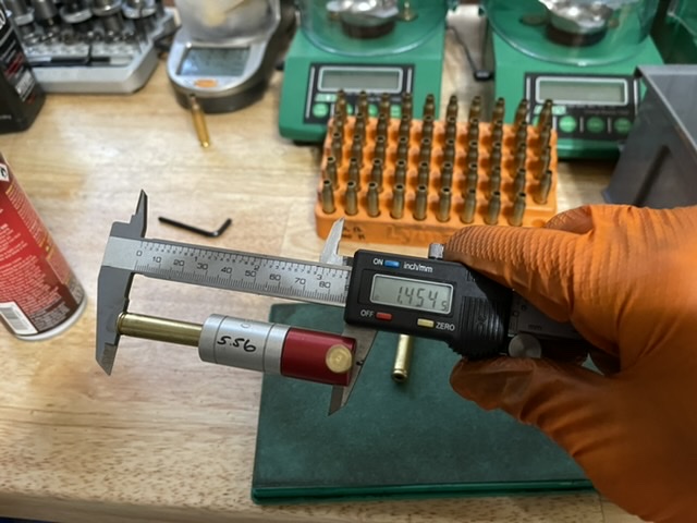

Quick question, are they worth it?
I am fumbling around being angry with my Hornady comparators thinking the case shoulder can move too much and it takes too long to get a measurement I am confident with.
And yes, I am new to this so without doubt much of this could just be my inexperience and my fault. But I hate wasting time and I know the right tool can save me a shit ton of work and worry.
So, should I just be patient, learn how to reload like a big boy and keep working the Hornady’s, or are the SAC’s actually that much better?
Thanks.

If so, The Hornady tool takes some reps to get used to. I usually take three measurements, considering it good when i get the same result twice.

Getting consistent readings is a learning curve. I have the Hornady and the Sinclair headspace (bump gauge)sets. I get good readings with both sets. Practice makes perfect.
With both sets, you need to realize that there are a couple of things that will give you false readings. First is to deprime the cases to be measured. A cratered primer will give you up to a + .005" false reading and two, brass fired in gas guns can get nasty ejector swipes on the bases and will also give false readings.
One thing to remember, the Hornady comparator is a comparator, not a headspace gauge. You will not get SAAMI readings from them. The numbers you read are for setting you F/L die to bump the fired case shoulders to what you want for that Rifle.

I think I get more consistent readings with the SAC gages. They don't seem to stick as much. I just believe I can feel a more consistent pressure on the caliper and the numbers are more consistent. I am a numbers guy though. And confidence in all aspects of shooting helps. I like them. But I can still make good ammo with the other ones, I just have more confidence in my numbers using these.

Quick answer ... "Yes". Work way better than the Hornady version. What I like best is that the comparator insert "rotates" to give the best possible measurement within the calipers. Everything I've ever bought from SAC was top quality and better than alternatives.

... my takeaway from your post is the time it takes to get a measurement you are comfortable with. My suggestion would be to get a second anvil for your calipers. In my experience using a second anvil not only sped the process up, but improved accuracy due the case rim sitting on the large flat surface of the second anvil as opposed to the thin blade. On the blade alone you can have a canted base, off-centered, etc. that will cause variations in the readings, which is why folks rotate/wiggle the casing to settle it in, using a second anvil decreases that need.
To repeat the above, I started with Hornady, actually got the Forster as well. Both require a feel to get it and can give false readings. All 3 benefit from an anvil flat base and I still use the Hornady one. The SAC are better, no question, give more repeatable measurements without worrying as much about feel. I also like they are stainless, not aluminum. I sold the Forster and the only reason I still have the Hornady is SAC doesn't cover all my caliber(35-45) needs yet.

Second anvil is a rock solid idea. I am gonna do that. Probably still get the SAC comparators down the road at some point, but only after I build up my experience a little.

Not unless you get lucky with the specific gauges that you received. Take a quality headspace gauge and measure it using all three of those gauges. Odds are they will all give slightly different readings.
My preferred instrument for measuring headspace . . .
If a guy can’t get a good accurate shoulder bump measurement using a piece of fired pistol brass or tubing, then your problem is technique. Fix that first, and then you’ll realize that improvements beyond that are about convenience, not accuracy. The convenience improvement worth it to one person may not be to the next, and both are right.

I got a second anvil and some more experience, and things have worked out nicely. My calipers are good, and yes, good calipers are crucial. Loaded my first rounds thru my 400th round. Had three that wouldn’t feed (learning as I go) and maybe three others that showed some pressure signs. Otherwise, pretty good start.
