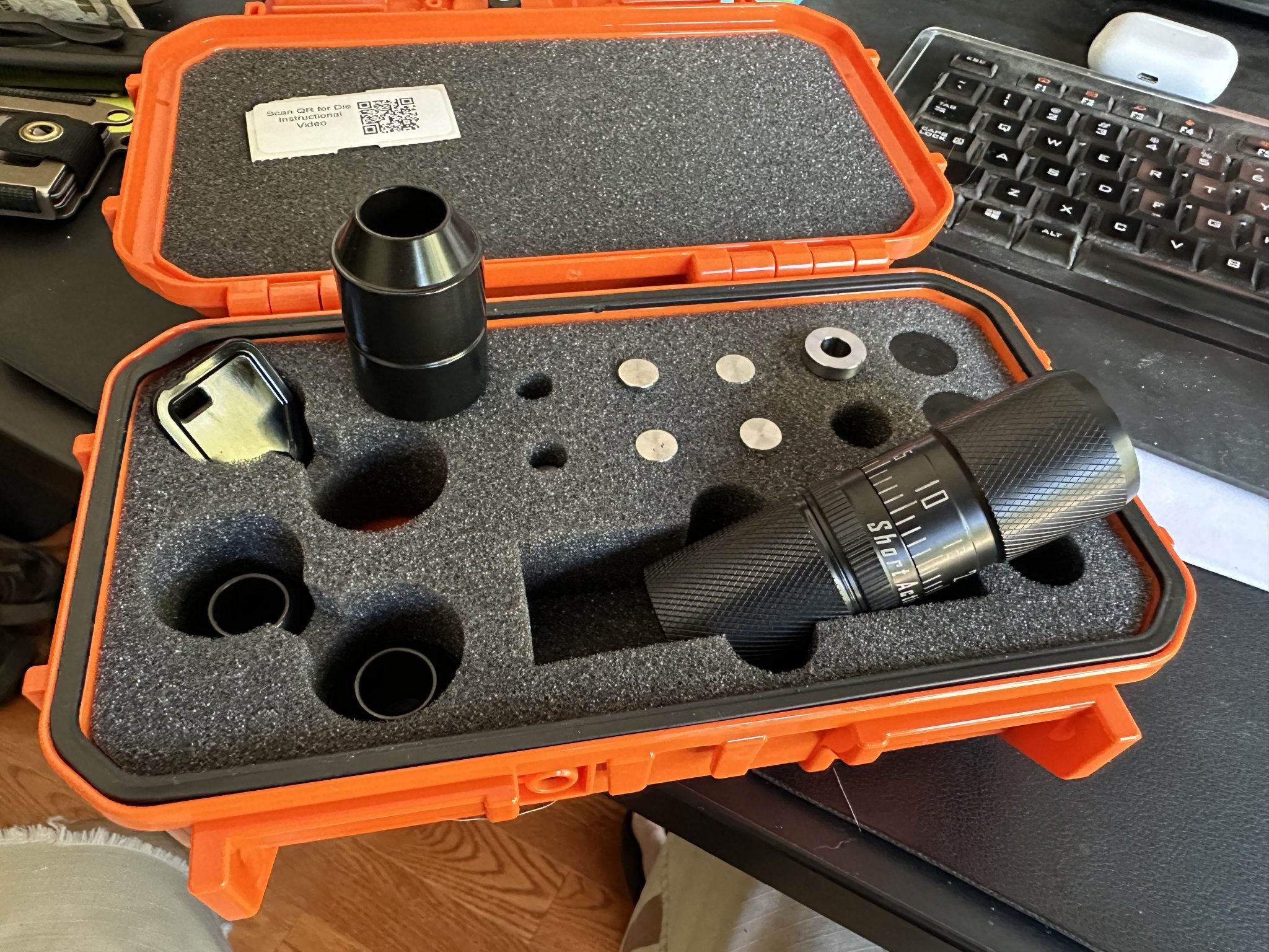

Anyone using a Short Action Customs infinity seating die?
It appears advertised as the "only die" you need seat bullets in multiple calibers but it also seems like you'll have to go through a full setup process of measure/adjust every time you switch back/forth between calibers. I was hoping this die would provide some quick and repeatable way to swap between calibers like say a 6BRA and 308. Haven't bought one btw, just eyeing new stuff.

Unit just arrived and this thing is built like a high precision tank. Fit and finish are superb and clicks are oddly satisfying in a way that makes my good scopes seem mushy.
Will try loading some .300NM & 6mm Creedmoor tonight and let you know if I’m kicking myself or going to the in-line seater darkside again.

Ok, so I spent about an hour doing some experiments with the die and here are my initial impressions:
  • It's remarkedly consistent.
I started with a .300NM load I use with 250 A-Tips at 2.793" COAL and first made a dummy round in my traditional press. Setting up the die is pretty straight forward; picked the M3 stem, placed the dummy in the base, added the body on top, and did a little trial and error with the pusher and dialing the body so it was just flush. When I seated a new case/bullet combo, the COAL was spot-on. I repeated this six times with fresh cases/bullets and the results were +/-0.0005" which is impressive from my experience. Even with my old LE Wilson/Sinclair dies I didn't get that kind of consistency, nor with my traditional press with Redding or RCBS seaters.
  • changing cartridges isn't a pain, but it's a little involved
I reset the micrometer, swapped seating stems and bases for 6mm Creed, then did the trial and error fitting of the pusher. Took probably 3 minutes or so. Again, super consistent results.
Obviously it's still too early to say much more, but I'm really liking it so far. One of the main reasons I got this is because after all these years I still don't have a seater for .338LM Improved 40 that I'm particularly happy with. I started with a custom die set from CH4D, and that seater left a lot to be desired. The best I've had so far is a custom Whidden die and I have a love/hate relationship with those micrometers. I even tried Whidden's inline seater conversion, but that was a big mistake. This SAC die may do the trick this time.
If this die wasn't so expensive, I'd probably get one for each major cartridge I load so all I'd have to do is adjust the micrometer. But swapping out stems and resetting the micrometer isn't that big of a deal. Swapping the cartridge sleave for smaller cases like .223 might be a bit of a pain though. So...I'm pretty happy so far.

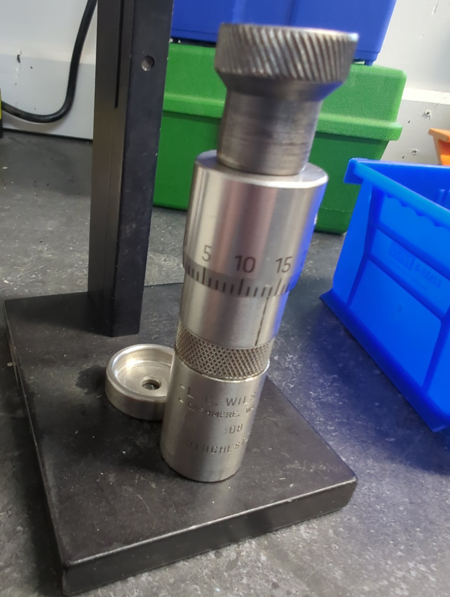

I stopped using mine and went to all LE Wilson SS Micrometer in line seating dies with a K&M Arbor Press. Best move I ever made. Talk about true 0.001 click adjustments, zero runout (your neck prep/sizing plays a big role in this fyi) and you can tell your neck tension consistency. And at $109 a die I had zero issues buying one for every caliber I own. I absolutely love them.

The fit and finish and machine work on the LE Wilson SS dies, both seating and FL Bushing sizing dies are a clear step up from all your traditional dies. Their sizing dies are so damn smooth, size like butter..

Which Wilson dies are you using for seating in a press? I wasn't aware they had traditional seating dies. Just tradition sizing dies and inline chamber seating dies.
