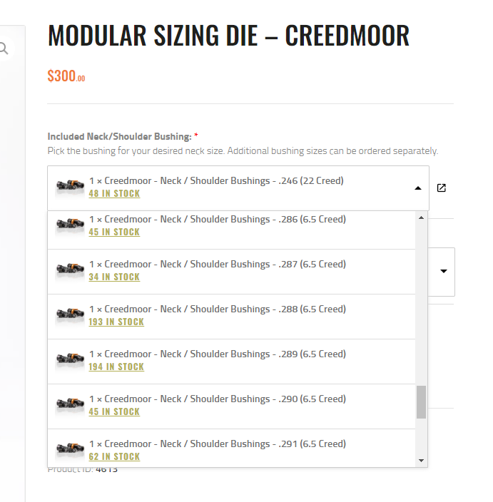

Options on SAC have me confused. The 6.5 CM busings range from .286 - .291
The .261 is listed under 6 creedmoor

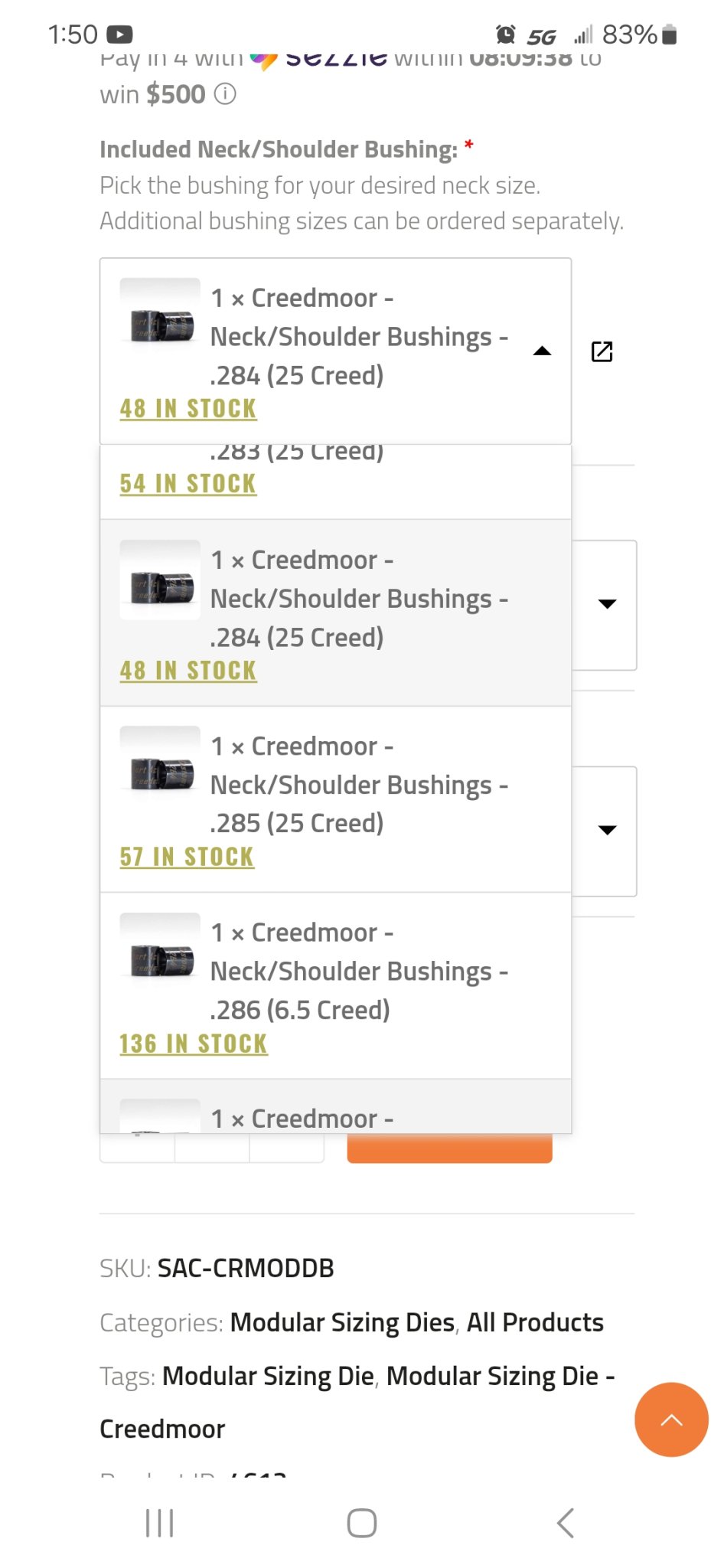

I'm wondering kinda the same thing for 6.5cm im going with .261" mandrel but for a bushing the 6.5cm drop-down list only goes down to .286" and then it says it's for 25cm and .286" is only .002" less than the mandrel but anything past .286" says it's for the 25cm. Can I still use the .284" shoulder/neck bushing for 6.5cm even though it says 25cm next to it? Is the only difference between the two just the neck diameter? If I use the .284" for 6.5cm instead of 25cm will it be the same as using a 6.5cm suggested bushing dimentionally wise beside the neck diameter? Im trying to get the die for black Friday but can't figure out what do to on the shoulder/neck bushing size
