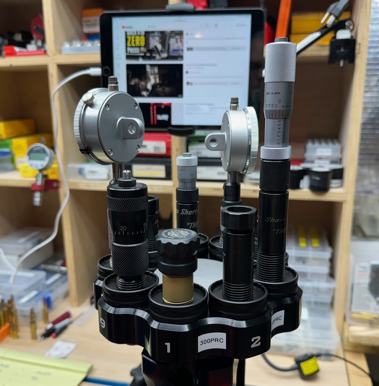

    I'm pulling what little hair I have left out trying to get this combo to bump the shoulder on my 300PRC once fired Hornady brass. I'm setting up my just received Zero press with the SAC sizing dies, beginning with the 300PRC. I've followed the video instructions, used the lowest Redding comp shell holder I have (.002) and added a 13 shim stack to the SAC die, no bueno. Has anyone else experienced the inability to bump a shoulder with this die?
    ETA - Ref the tooling in the pic, everything is working except the 300PRC sizing die. The other SAC sizing dies (6BR and 260R) are working as advertised, as are the seating dies.

    Not coming at your Brother, but I set it up to the letter. If it worked, I wouldn't have had to post my question.

    As an update, I did send SAC a note and they replied that issues tended to be too much bump versus my issues with no to too little bump. I have not re-engaged with SAC, I wanted to do more testing.
    I took everything apart and made sure it was clean, reassembled and still had issues. I bought the Area 419 shell holder set and while it helped (I could get a bump with the -2 shell holder and a shim), it was inconsistent. I swapped the SAC with a Whidden and had it up and running in 5 minutes. I took the SAC die and set it up in my Co-Ax and it was working in minutes and with consistency. Placed it back into the Zero and still issues with consistency.
    I did not have similar issues with my SAC sizer for my 6BR or my 260R, work like a charm. My uninformed opinion is the cam-over in the co-ax works wonders.

    Yeah it sized ok for me and was consistent with my regular redding shell holder. If you use the same piece of brass after you adjust you will have issues so you have to get it close then use a new piece, and so on or you won't ever get it, just fyi but you probably already knew that.
    It sized consistently for me .002" on my zero press.

    Lol... Don't know if it would help. You're suppose to just add the spacer shims to add a thousandth. Added to no avail. How u doing though
    I didn't use any shims. It looks like that's one of the ways they say you can do it but you can use it like a normal bushing die too, which is what I did

    Watch the video again at around the 5:15 mark. That's not the only way it works. They specifically say you can thread the die in as well.
    Which means there's no one size fits all way of using the die. Shims may work and sometimes you may need to thread the die in or use different size shell holders.
    It's a three part system with shims, shell holders, and the die body threads.

    To add, the die can be threaded in as far as you like on the Zero, but there is no cam-over so the ram simply stops when it contacts the base of the die. The possible solutions include using the thinnest shell holders possible to force the case further up into the die, or the shims to remove some of the free play and force the neck bushing down (or both). A more radical choice might be to shave a skoosh of the die bottom.
    Stupid question but since it’s new, are you torquing the turret with the torque limiter? Is there any obstructions keeping it from seating? I know this basic stuff but I often overlook the simplest of things.

    I updated my OP to clarify that only the 300PRC die is problematic. The SAC 6BR and 260R seating dies are working and the SAC seating dies are spot on once adjusted. I loaded 30rds of 300PRC yesterday in the SAC seating die (with 220 Bergers).
    ETA: I use an Accuracy One Seating Depth Comparator, which measures from the shoulder to ogive versus base to ogive with the Hornady/Stoney Point comparator. So, if my shoulder bump was off, the AO comparator would indicate and I would just dial it in using the seating die. That way, my shoulder to ogive are all similar.

    Good questions. I actually removed the turret and made sure everything was cleaned and free from any manufacturing left overs (as well as the dies). I reinstalled and do torque the turret at each station.

    So you did get bump with the Area 419 -2 shellholder and ”a shim”. Sounds to me like you have a very small chamber (at or below min SAAMI headspace) on your 300 PRC. I would get a go gauge and check the rifle headspace. If that’s the case, you may have to trim some metal off a standard shellholder or “shave a skoosh of the die bottom” as you mentioned above.
