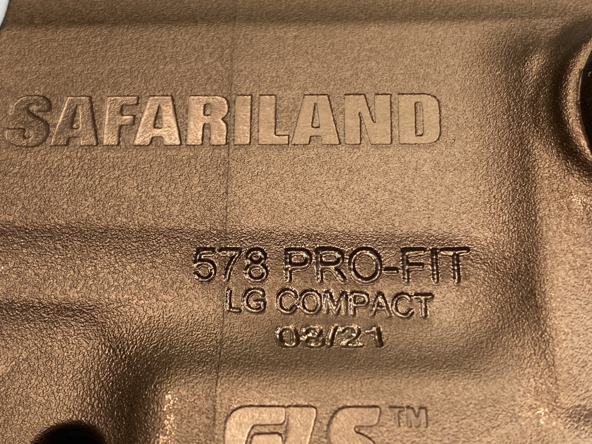

The problem with a Safariland ALS will be the red dot. You can get a GLS for it. Instead of a thumb release button, it releases via a lever actuated by the middle finger as you get a grip. I prefer the ALS, but the GLS works pretty well too.
578-450-411 SKU…

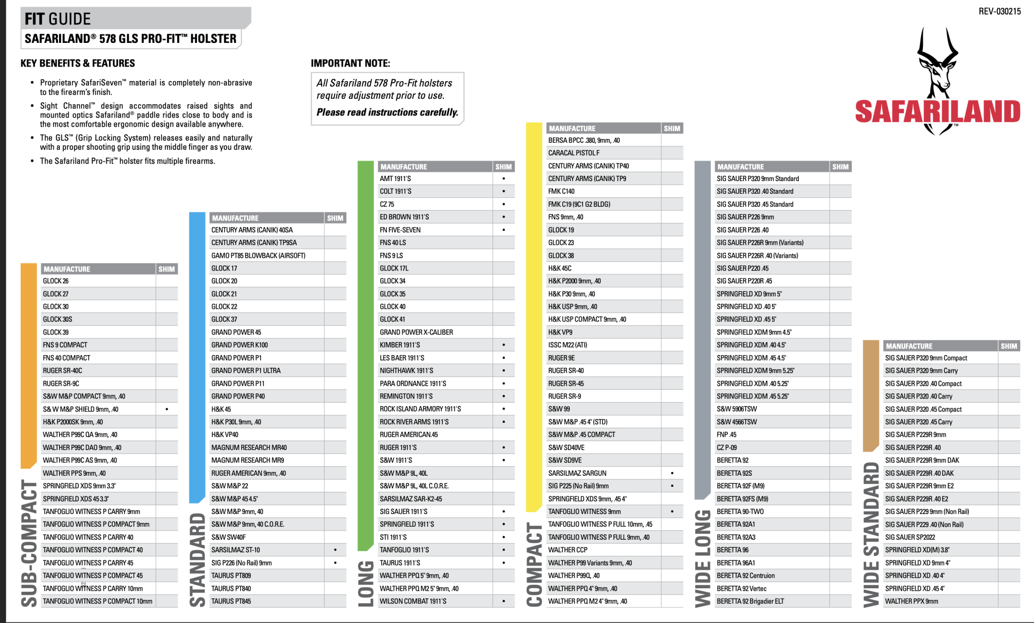

Looking through Safariland’s holster finder, if you want the ALS model holster for a pistol without a light, you don’t have the option for a RMR.
Reactions: DontShootEnough

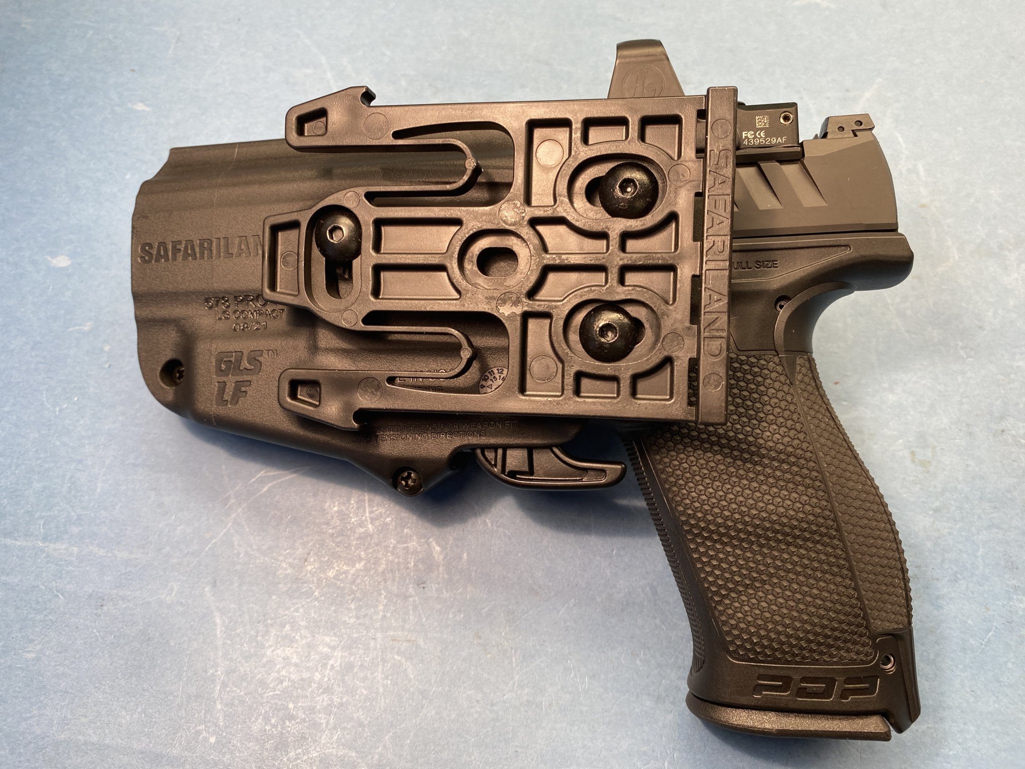

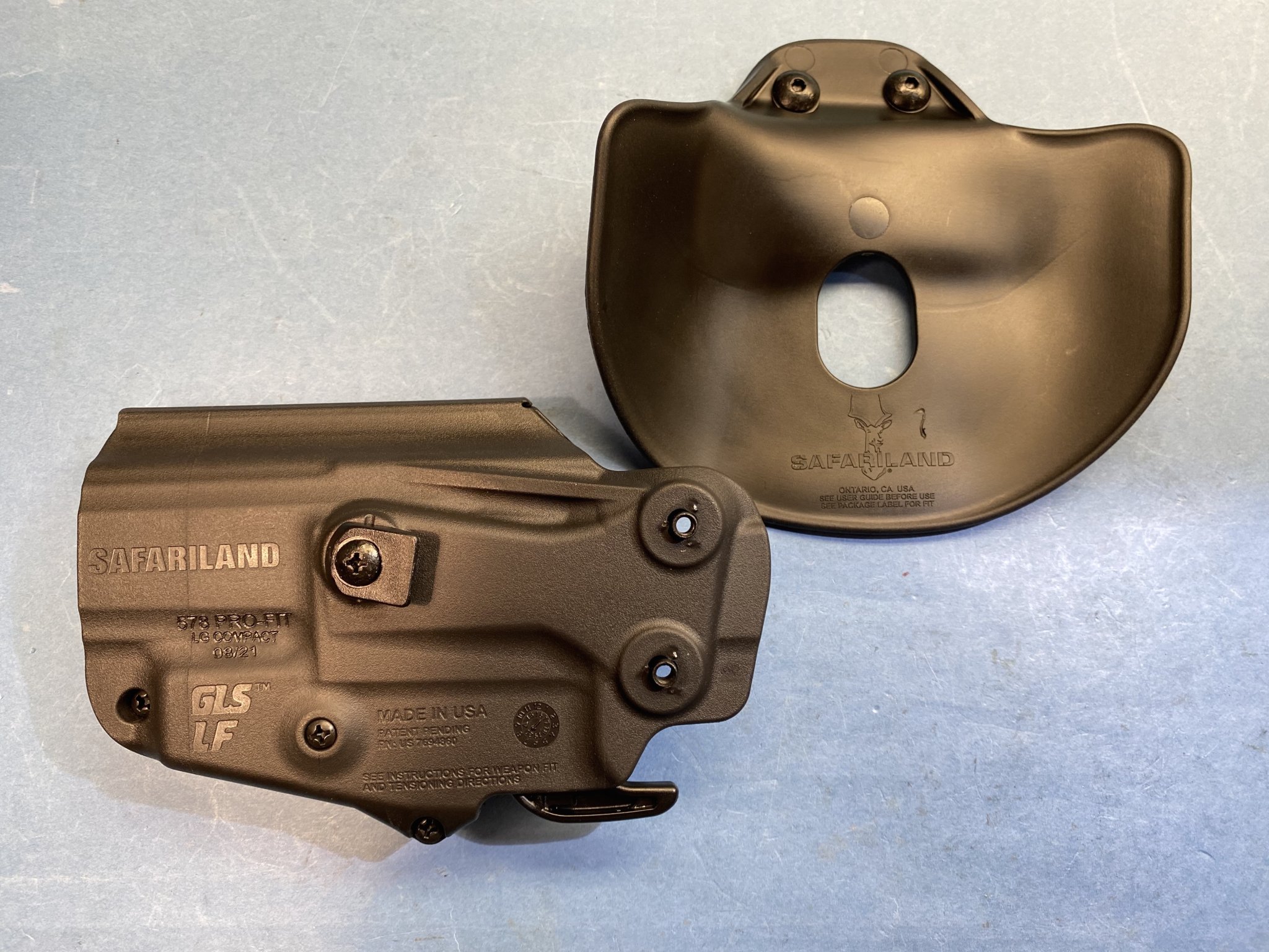

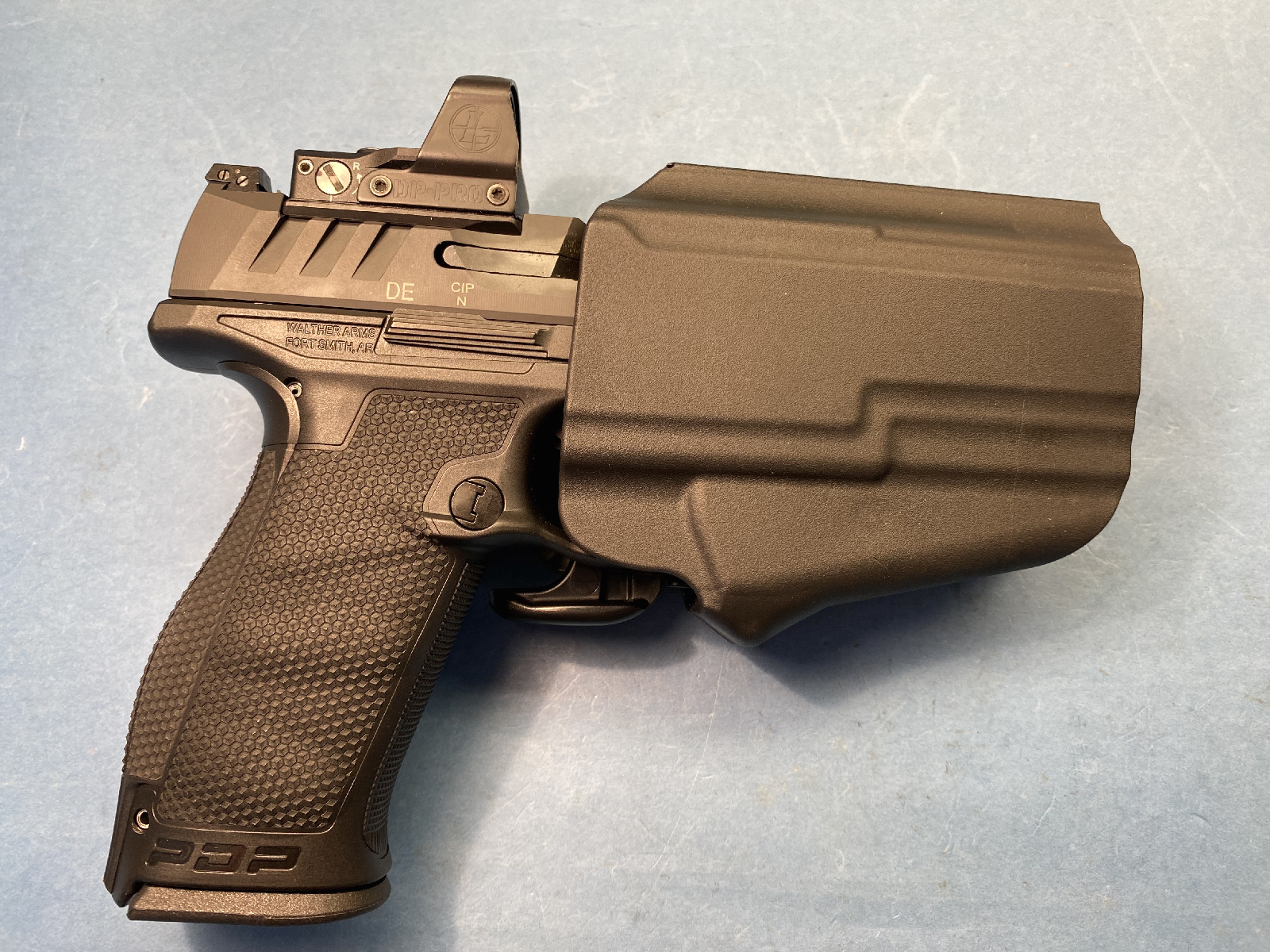

The Safariland GLS (Grip Lock ingSystem engages the trigger guard) works well with PDP.

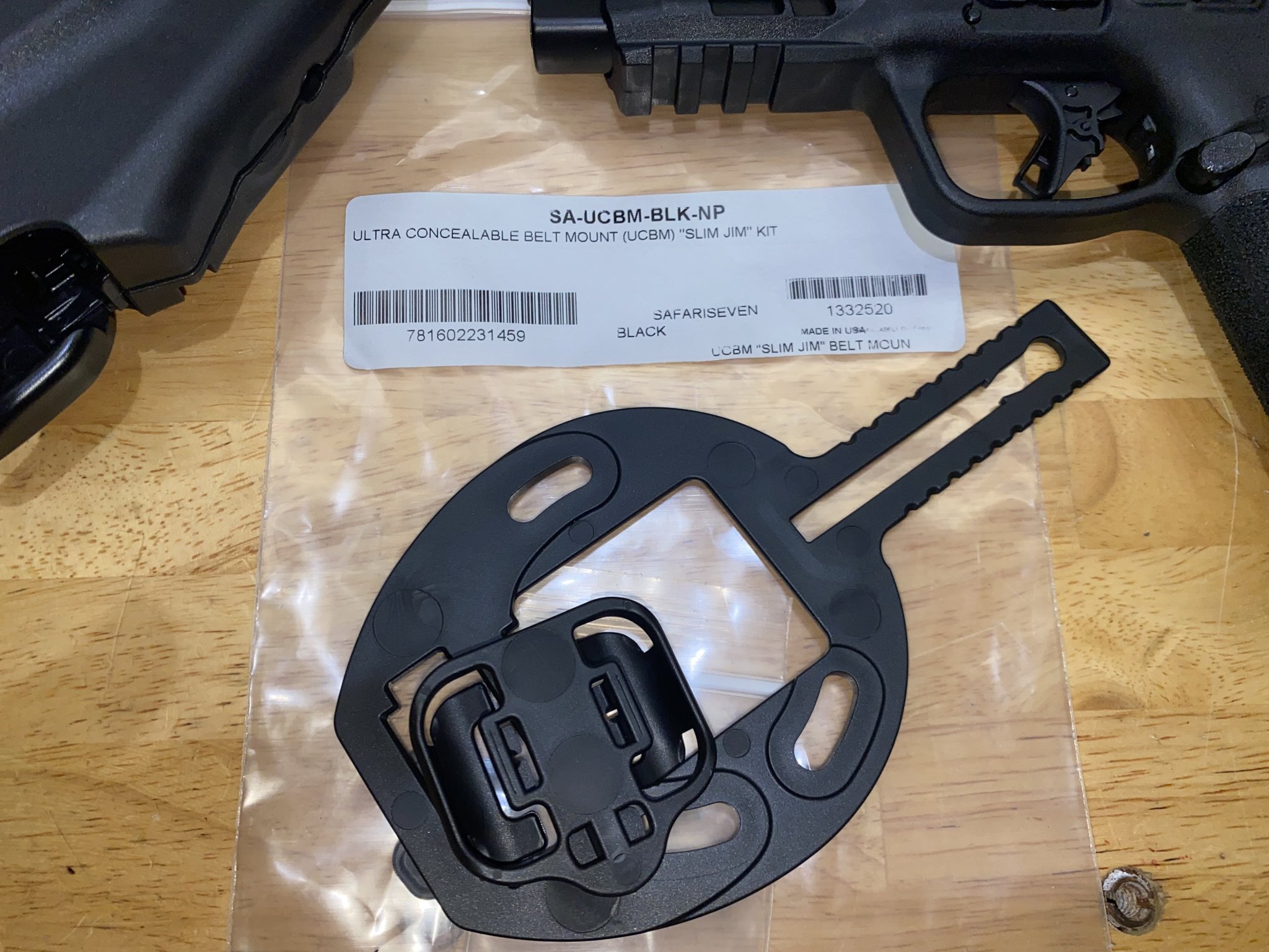

One can use the paddle, QLS or their new Ultra Concealable belt attachments.

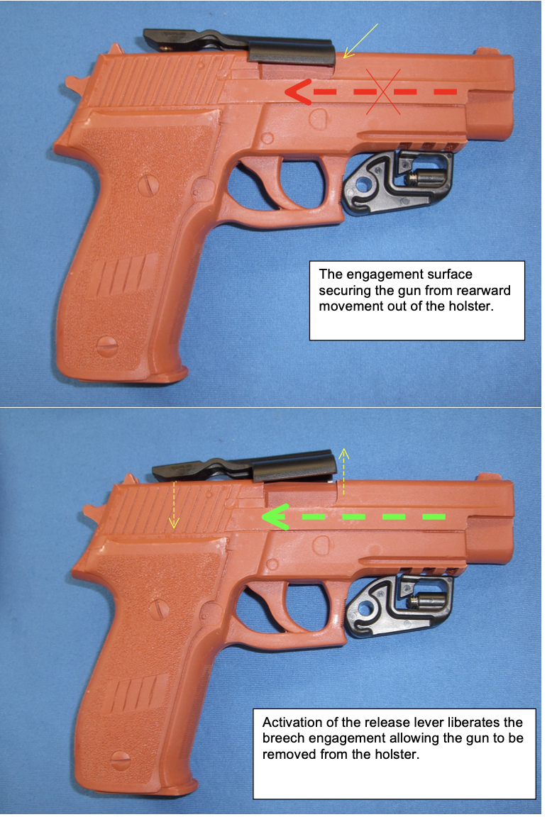

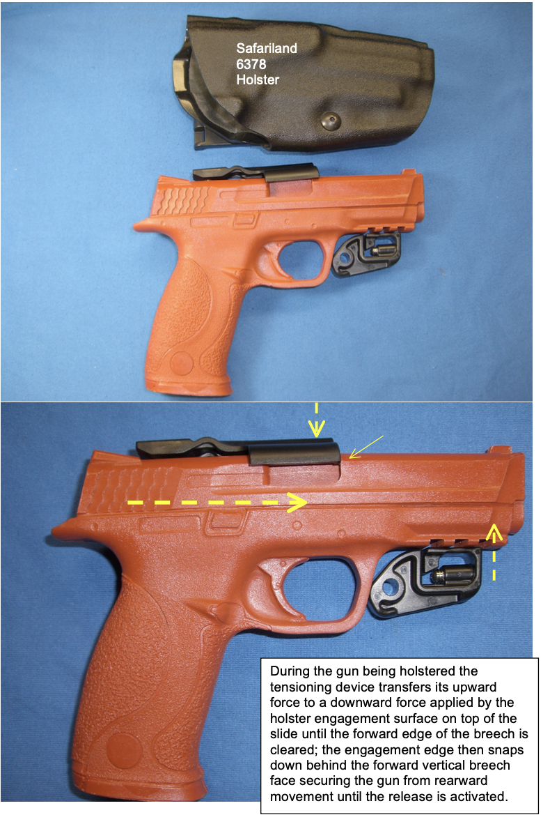

As mentioned above, the ALS (Automatic Locking System) mechanism engages the back edge of the slide-breech area.
IMG_8536Walther PDP Leupold Delta Point Pro Mounted Safariland GLS e copy.jpg
IMG_8344Walther PDP with Safariland GLS Holster QLS and Hip Paddle Mounts 2021 copy.jpg
IMG_8346Walther PDP with Safariland GLS Holster QLS and Hip Paddle Mounts 2021 copy.jpg
