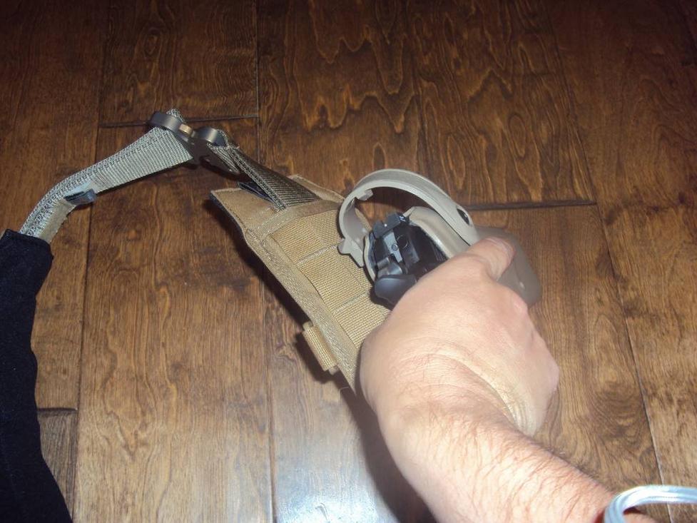

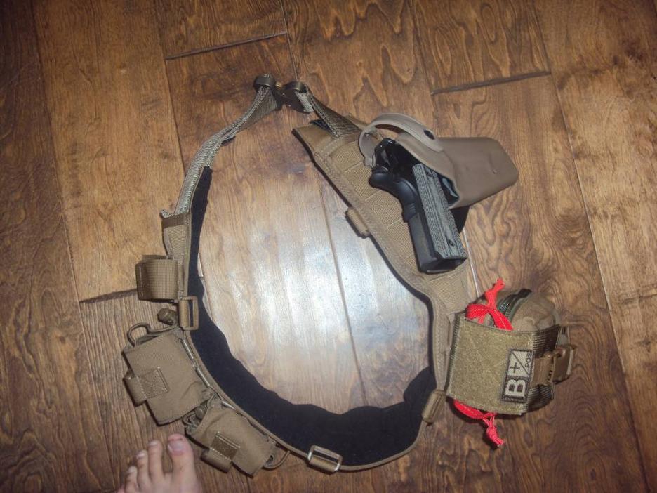

    Here you go man. I threw it back together real quick as I had the belt and holster off of it.
    First pic is it 'at rest'.
    Second is what happens when I try to unholster the pistol.
    Third is what this looks like with my hand out of the way (and obviously my body not holding some of the slack back).
    I do need something more stiff. I'm just not sure if this is also in part due to the warbelt being an ATS having zero stiffness to it, or that the mount is on the belt instead of directly on the warbelt molle where it would have more leverage.

    With that belt loop mount( had to look it up) and the belt you are using, there is going to be play while it's in the warbelt. I'm guessing you don't have as big an issue if you put the cobra belt on as a pants belt with the holster attached. The siloution would be either to get a very stiff gunbelt to go inside your warbelt or to use a different holster attachment method.

    I have the GCode RTI for my SIG226 and like it. Was thinking of getting the conversion hanger for the Safariland holster so I can use whatever holster on any setup. From looking at this more, its the mount attachment thats the issue; there is slack in it and it gives (hence why I can unholster if I hold the bottom of the holster straight down). Think I am going to try the RTI hanger and the GCode attachment that connects directly to the molle and may look into a stiffer warbelt as well.
    ETA - Just remembered I have an ARES ranger belt; put that in instead and there is a 200% improvement. If I get rid of the mid-ride mount this will run perfectly.

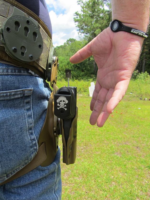

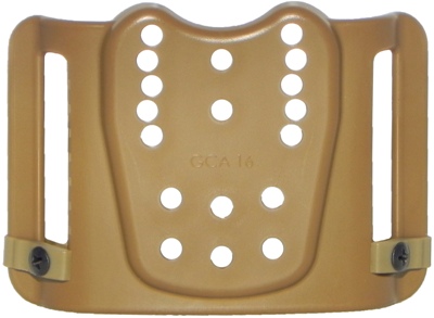

    I think I know what you are saying. Did your safari land holster come with the small adjustment guides to make the belt integration tighter? If you look on this G code picture, you will see each slot has a small piece that you can adjust to better fit the size of belt used to prevent what is happening with your current set up.
    Here is a shot off of G-codes FaceBook page that has a good set up. I am not a big fan of thigh rigs, any real walking in the mountains of Afghanistan or serious running and you get beat to death. But the rig pictured is a good balance as it still rides high enough that it doesn't flop around. What I like about this set up is that I can take the holster and mount it directly to the warbelt when I am not wearing body armor. However, when I need to wear armor the leg platform give me the added space so the bottom of the armor carrier isn't hanging up on the hood of the holster. The modularity of the RTI wheels and attachment accessories make this my no brains go to set up for holster and pouch/knife attachments.
