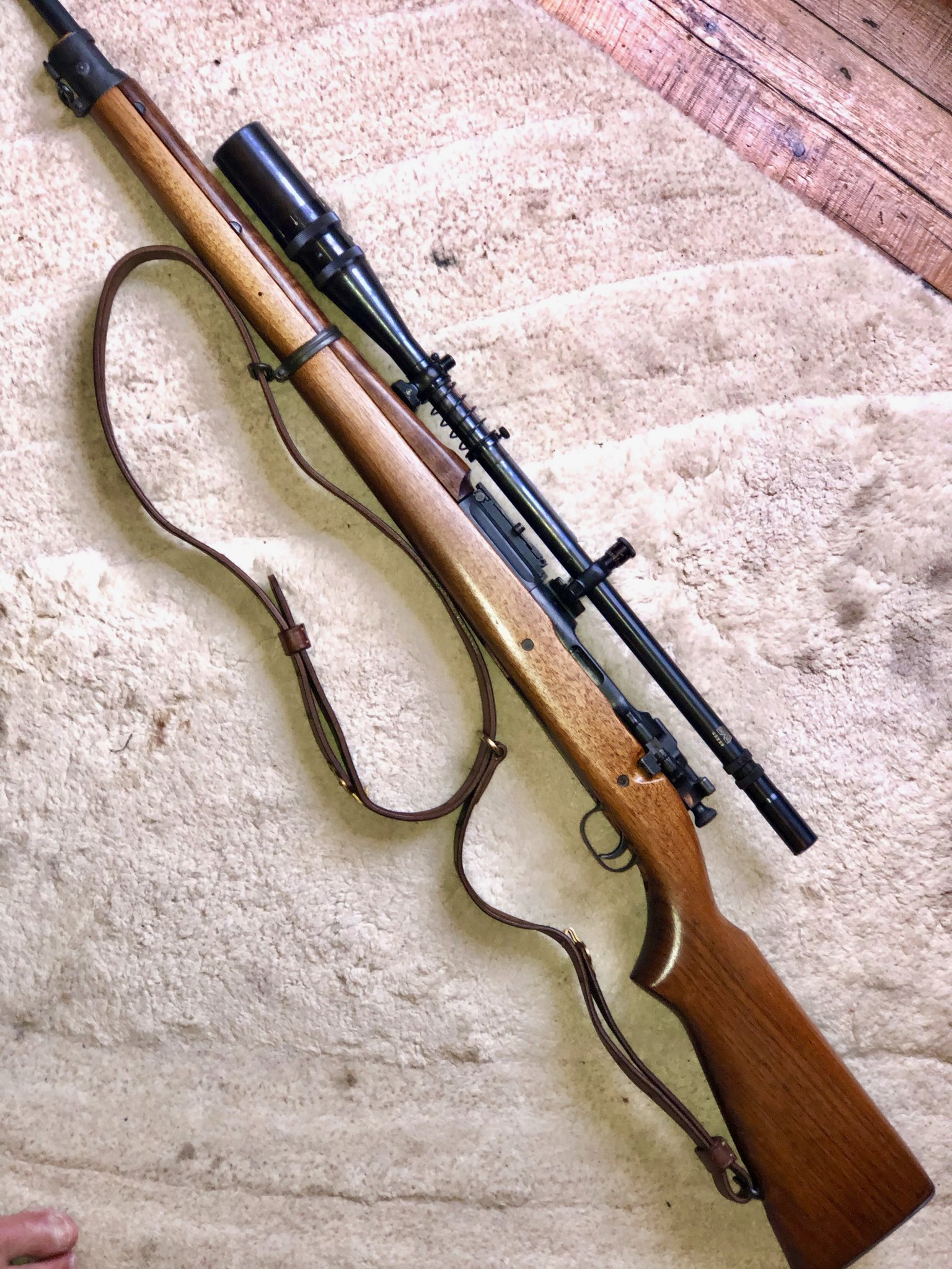

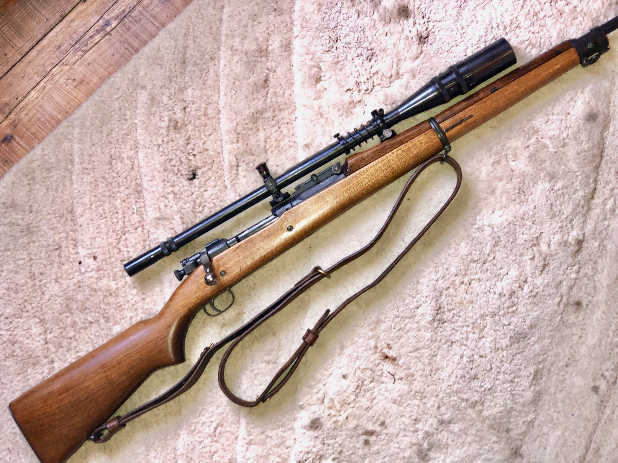

the rifle I have I believe is about 80 years old and the two grove? barrel looks original to me.. with this in mind I was looking for a light accurate load I could use, I have loaded 170 Lap at 2500fps but only got 3/4 MOA at 100yds but have not shot it at distance.
any advice would be gratefully received.

The standard load at that time was 48.5 gr. of 4895, under a 150 gr. bullet. We didn't have dedicated sniper loads like we do today. Also, 4895 was THE most common powder. They did not differentiate between Hodgdon and DuPont (it was all actually made by DuPont, Hodgdon bought it by the rail car after WWII).

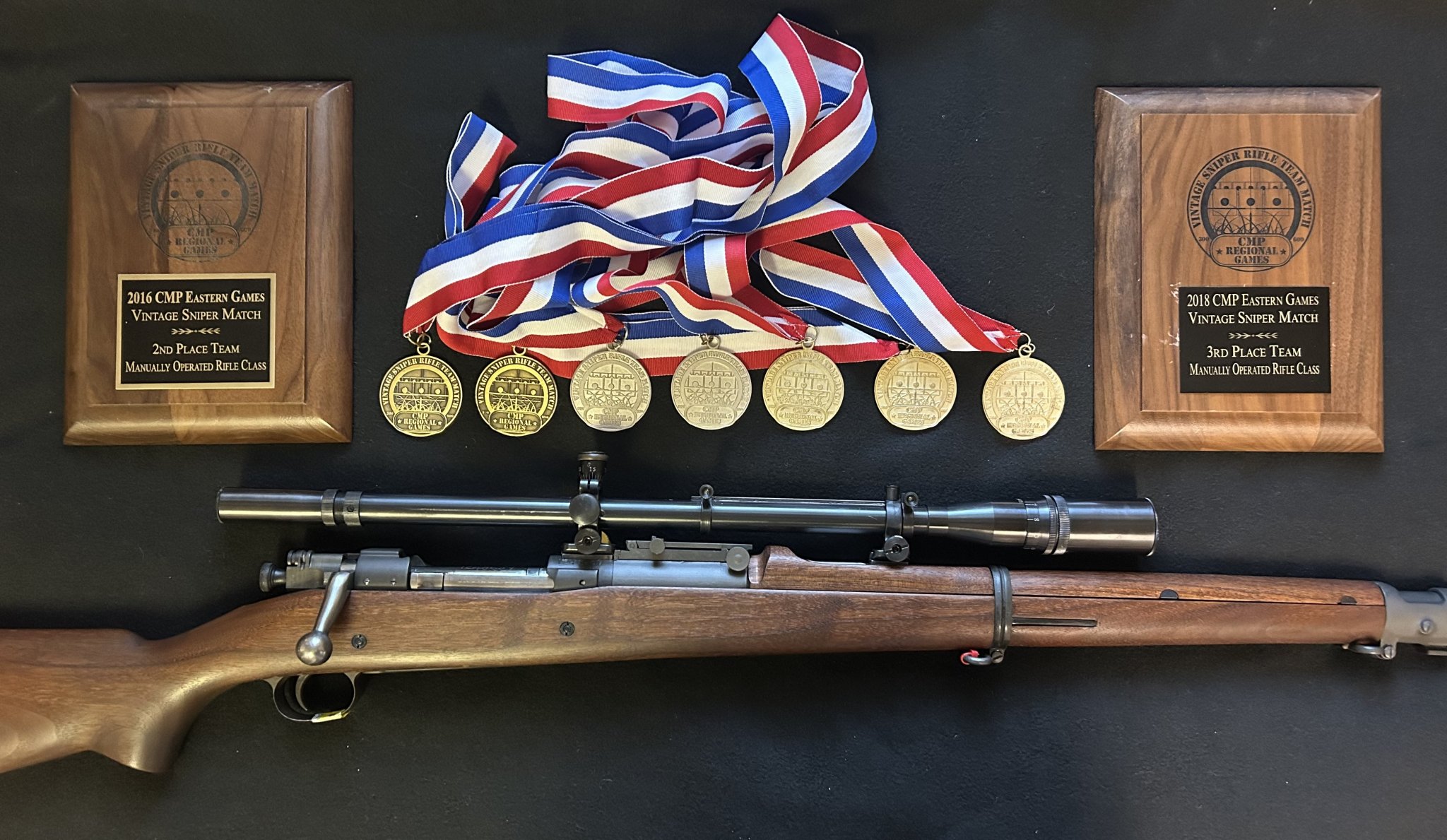

A real one with USMC documentation is easily $15k-20k here in the U.S., but most for sale are fake. Whereas a reproduction might be $2500 plus, if built with a new Criterion barrel, plus a new stock, carefully installed Steve Earle scope blocks, plus all the other gunsmithing required to carefully put it together to compete and win at CMP vintage sniper matches. Mine was built by a 1000-yard benchrest shooter, using a match chamber reamer, trigger job, carefully fitted stock (voodoo), and all metal was professionally refinished, etc. It’s a labor intensive build to do it right. So that’s a ball-park range.
