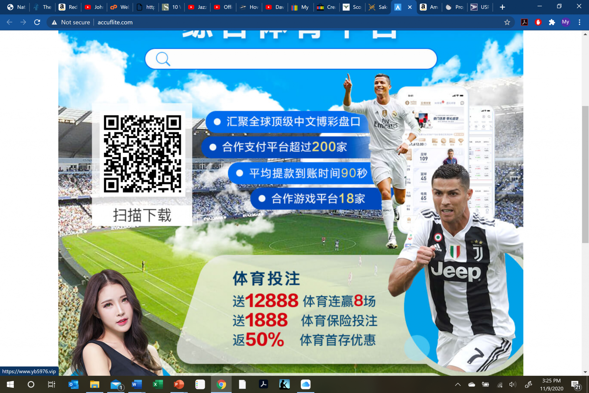

Haha - here is where your accuflite link took me. I like the pretty Chinese woman but I don't like soccer.

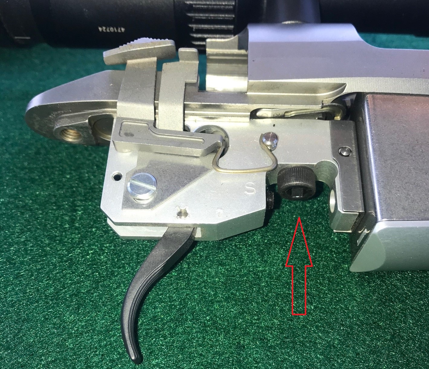

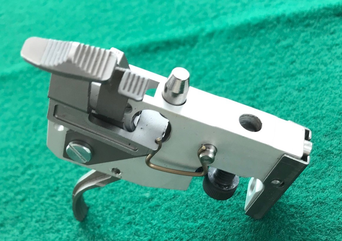

Ha - oh man, this is so easy it belongs in the "stupid questions" forum, not here!
I already knew how operate a 5mm allen key. Remove one cap screw (the big one in front of the trigger going up into the receiver) and the entire assembly comes off, safety and all. No pins to drive out and lose, no springs to go spro-o-ing! No bolt release slide (I already knew that). What a great setup.
If you can operate an allen key, you just remove one cap screw (the big one in front of the trigger going up into the receiver) and the entire assembly comes off, safety and all. No pins to drive out and lose, no springs to go spro-o-ing! No bolt release slide (I already knew that). What a great setup.
