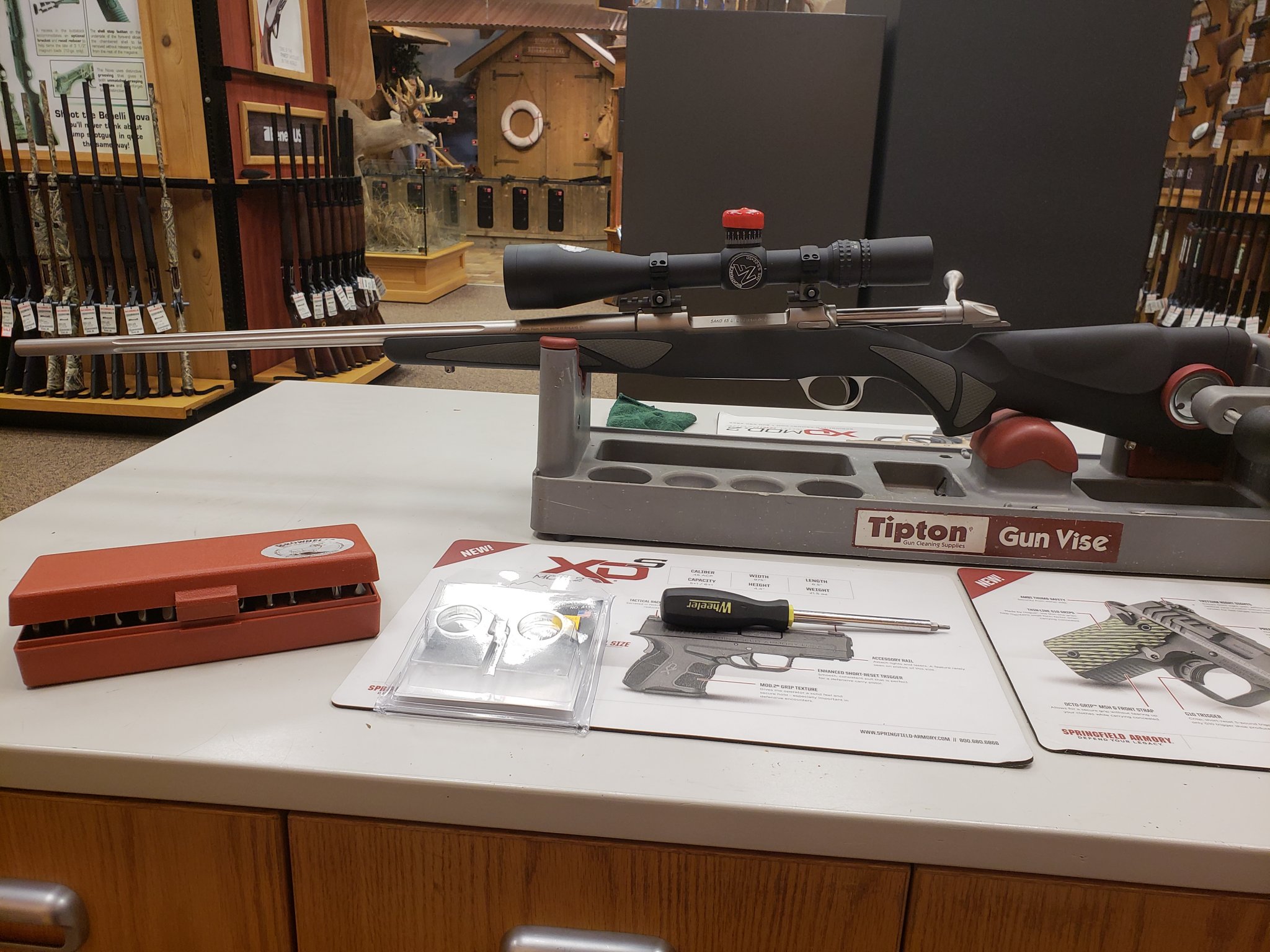

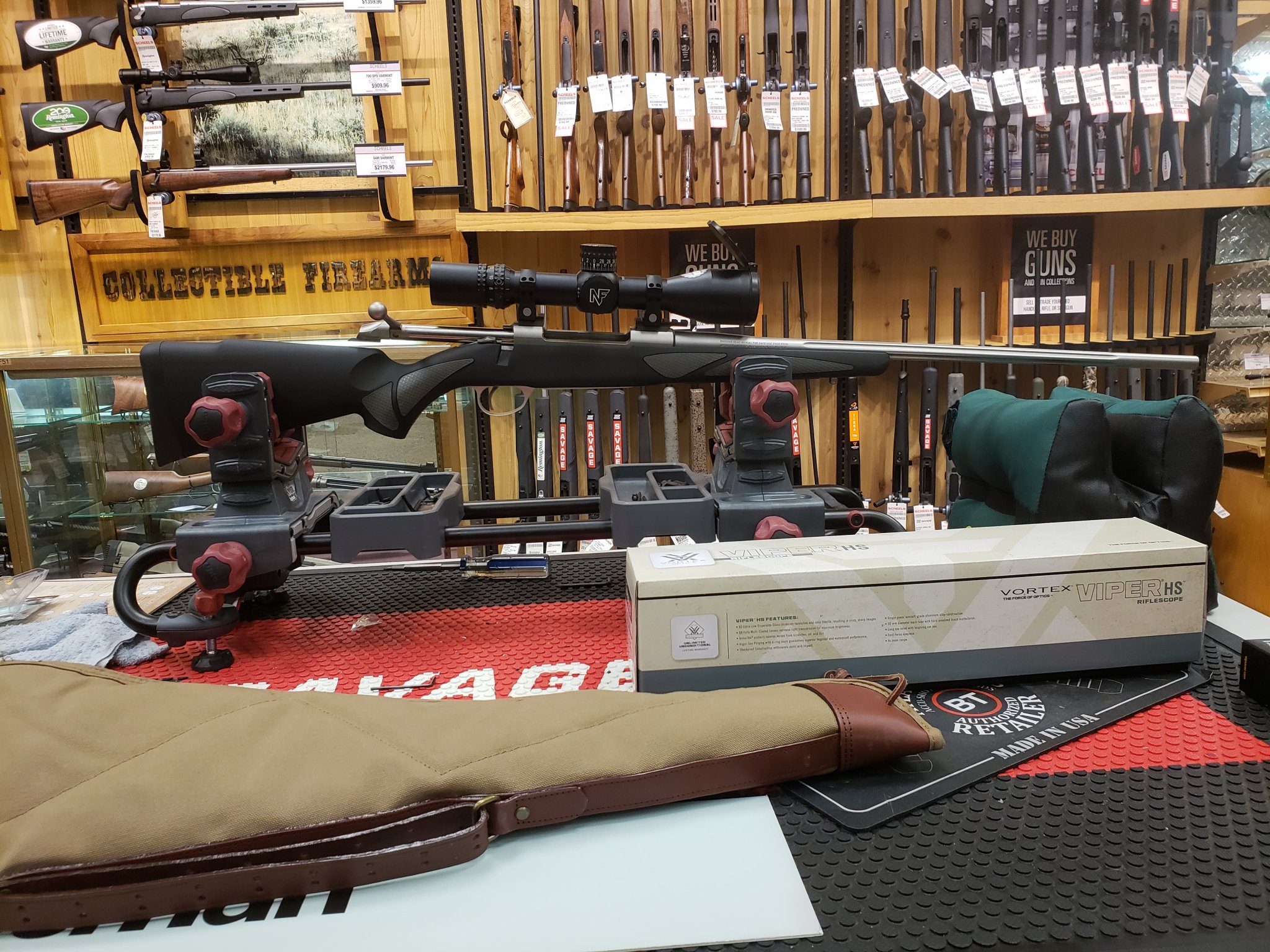

Did some playing around tonight. Put the 4-16x50 atacr on my rifle and an nxs just to see how it would balance. Store didnt have a 3.5-15x50 nxs so I put a longer 5.5-22x50 on it just to see.
Nxs:
ATACR:
Kinda looks a bit awkward visually with the 34mm atacr, certainly sitting up a bit higher than the 30mm nxs.....
What are your thoughts on them Bwahl???
The nxs Def looked less awkward on the rifle. I'm not to concerned with looks as I am with low light performance. But that nxs has a little more forgiving eye relief and is some cheaper...pluss allows for a lower mounting profile.
