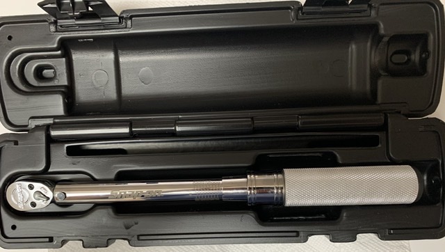

What should I use to tighten? Simply can’t get enough pressure on L wrench to tighten it down. Do I require something different or special tool?

I have a Snap-On 1/4“ Drive In-Lb Torque Wrench (you can buy a cheap Torque Wrench online for infrequent use). My Brake get’s torqued to 10Nm or 89In-Lb but check the documentation that came with your‘s for the proper torque spec.
