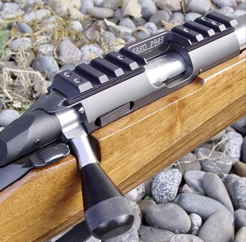

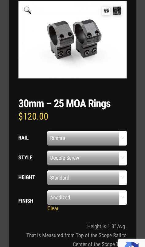

I recently won a P94S Range on the RIA auction, I live in S FL and would like to get into some PRS events with my Tikka Tac 308 in the tactical division, however I dont want to drive for a lifetime for a range bigger than homestead, which is far enough, and ammo prices have gone off the deep end for now. Maybe try to get a NRL22 group together at one of the public ranges around S FL???
Fast forward to one gun I've always wanted and just now got, a 22LR P94S. My plan is to put a PST Gen 2 3-15 EBR-2c moa (yeah I know all the cool kids dont use MOA), on a 25MOA rail for the P94S, this would match my PST Gen 2 5-25 EBR-2c MOA on my 308 Tikka.
I was also looking to add a good sling, I have the short action precision on my Tikka and AR, or maybe just a target type with a hand stop and no rear attachment, heck as I kid I used to just have a camera lanyard loop off my front swivel that I would use as a sling. I want to also ditch the harris bipod for a atlas to match my Tikka, just personal preference, I'll also be matching the trigger weights between both rifles best I can.
My question is am I missing anything on this build for a good NRL22 gun, also how to I get a picatinny rail on that euro target rail for the bipod?
Hope that wasnt too much, and THANKS, looking forward to the day when I can contribute more than I ask :)

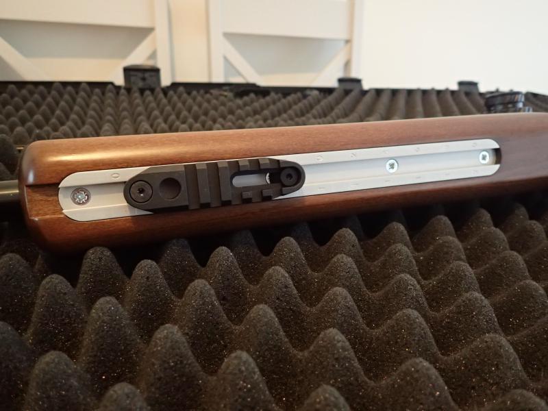

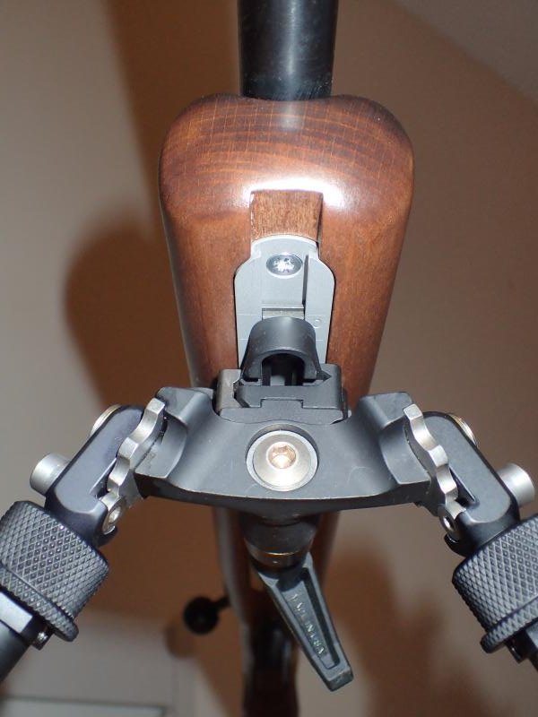

I was thinking of having something like this just aft of the new atlas bipod if possible, though space and weight might beg to differ.

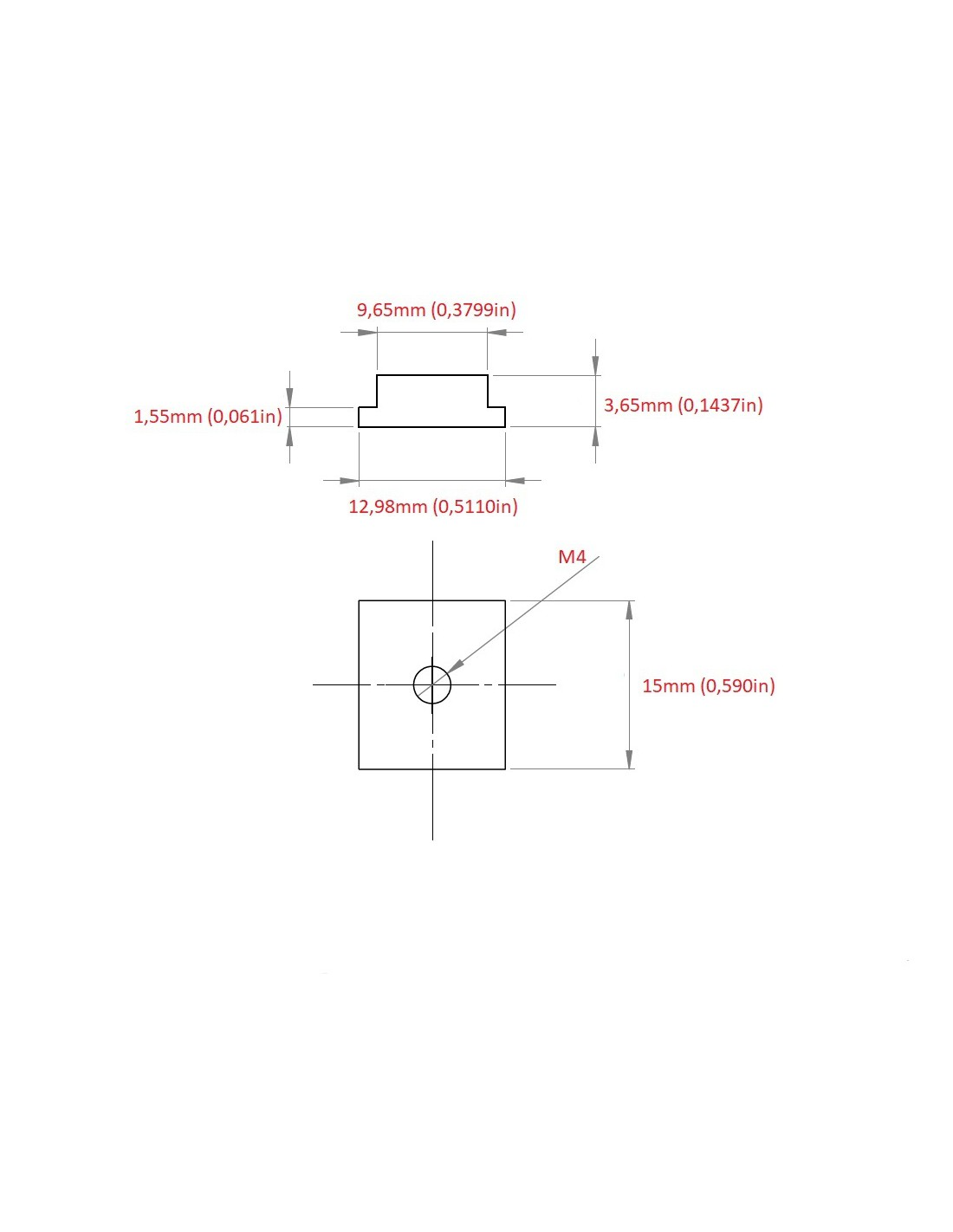

You can get square shaped nuts that slot into the rail and then these accept the Picatinny rail screws. Just make sure the screws are compatible with the nuts obviously (metric/imperial). I searched my email looking for where I bought mine to give you a link but I couldn't find it. Maybe try NordicMarksman.com. Search Google for a UIT Rail Nut or an Anschutz Rail Nut. Alternatively, I've read an M6 flange nut with some filing down will work as a DIY method (on some rails anyway). I have a few at home but haven't had the need to file them down yet so can't 100% verify but looks like they should work.
I use this rail on my 1761 MPR, it has a built in flush cup which is handy for attaching a sling without adding more hardware: https://www.accu-shot.com/catalog_new/accessories-official-manufacturer/64-bt15-335-1913-rail.html
Nice P94 BTW, wish you the best of luck with it(y)
Reactions: TurboTrout
Thanks, Ill looks for those nuts (insert joke?), but thats great if thats all I need for a proper install
Per the bag I was just going to use my one SAP bag, will there be stages where I need two bags with the bipod?

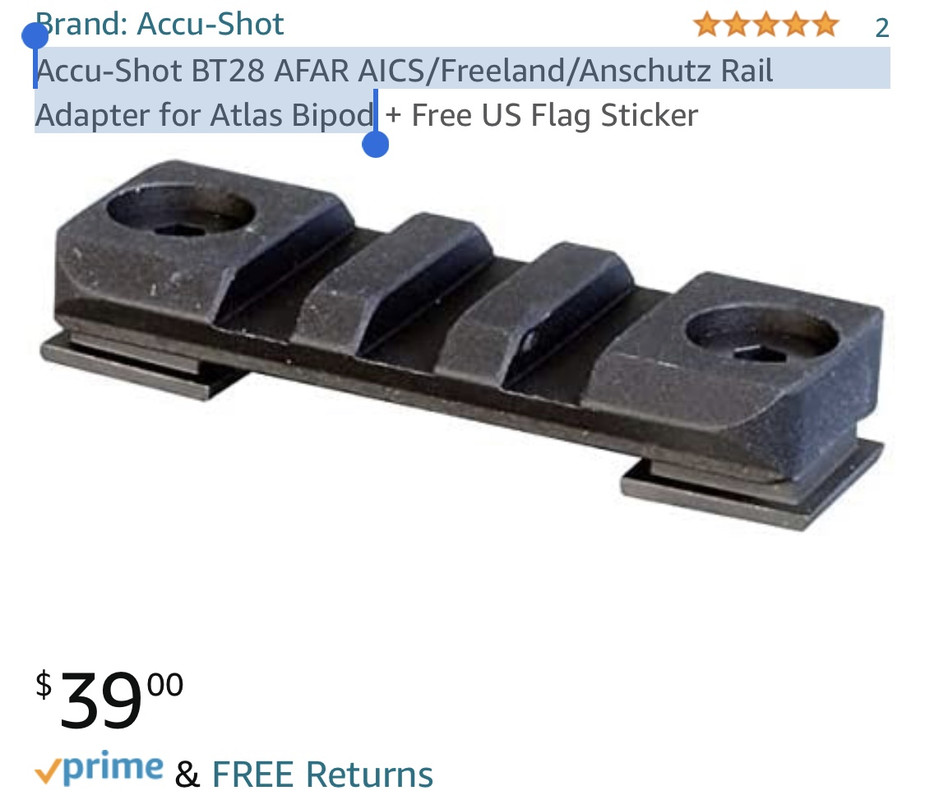

Does this look about right?
As I see it, folks arnt carrying these rifles for miles at a time, what about using a slig/cuff like this?
Yes..and no! The nut you pictured will work with that particular hand stop all right. That nut, once slid into the rail, will protrude beyond the rail. That hand stop pictured has a slot to accommodate this protrusion.
If you want to mount a Picatinny rail like I have on my rifle you'll need a lower profile nut that does not protrude below the bottom of the rail - otherwise when the screw is tightened it will just marry up against the nut and not squeeze the rail. You'll need something like these:
Images above borrowed from here: https://www.tactical-evo.com/en/mou...placement-screws-with-uit-plate-for-rail.html
I shoot the same rifle for Long range 22 matches. The gun is phenomenal and will shoot certain Ammo 1/2 MOA at 100 yards and beyond. I mounted an arca rail to the existing rail with the square nuts previously mentioned and run an Atlas bipod as well as RRS Tripod off this set up.
Also get yourself a DIY 25 MOA pic rail ... you will need that to get out there past 300 yards.
- Good Shooting.

Went with this one
still debating a hand stop.
one question, I was about to order a bipod and it got me to wonder, with how easy it is to remove and install a railed bipod these days, do most here have a bipod, sling, bags for each rifle, or do they swap one between their platforms?
I never was into swapping or quick changing a scope for the zero, but a bipod hmm
When you say a "railed Bipod" what exactly are you referring to? A bipod that mounts directly to the UIT rail or a bipod that mounts to a Picatinny rail? I cannot comment on the former but removing a bipod from a Picatinny rail takes seconds if you have a quick release cam style attachment rather than a bolt that requires an Allen key. (Apologies if I picked you up incorrectly)
Edit: Forgot about an Arca rail - these can be swapped in seconds also with a quick release.

yeah, I meant Picatinny
So do most here share a bipod between rifles? Is there any downside I’m just not thinking of?

One last question, how does this look for a rail?
Any better options?

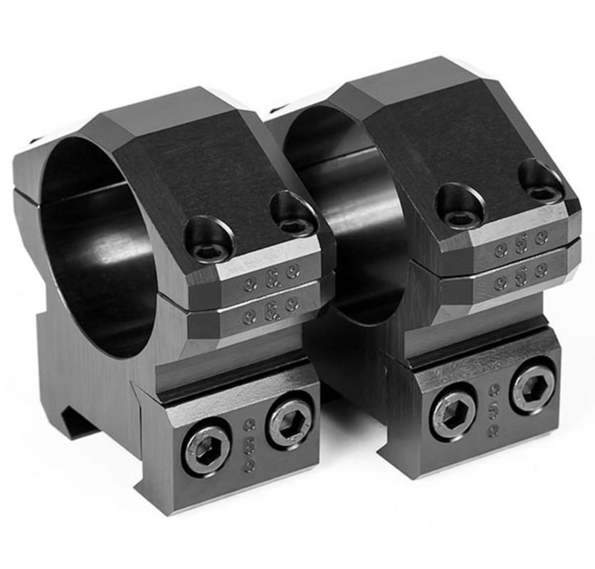

With these rings
Or would I just be better off with their dovetail rings since I don’t see myself taking the optic off shy of it being damaged?
Seems they have some MOA dovetail rings too
Seems just going with straight dovetail rings with the MOA built in would be less parts, seems less parts = more solid
lit also appears the rail uses set screws to gouge into the top of the receiver, vs the rings use clamping force, perhaps more surface area contact with the rings?

ATLAS makes great products so you have chosen wisely, grasshopper. I have BT28s' installed on my euroOptic Special Edition Sako Quad as well as on my Tac Ops X-Ray 51 & X-Ray 66 and use QD picatinny mount bipods on them. For me, the QD is pure convenience since I shoot off bipods most of the time and rarely remove them. I've been using BT28s' for about nine (9) years now and they're never loosened up on my Quad, X-Ray 51 (.308), or X-Ray 66 (.300WM).
Below are photos of the BT28s' in the 10" Anschutz Rails in my Quad and X-Ray 66. The screws on the Quad have been CeraKoted Graphite Black to match the rest of the metal. The screws on the Quad are TorX, so I upgraded the screws on the BT28 and the Anschutz Rail the BT28 rides in so all of the screws are TorX now. The Anschutz Rails, BT28s', and screws on my X-Rays' are coated in Tac Ops Green T & Black-T to match the rest of the metal on the X-Rays.
euroOptic Sako Quad w/QD picatinny bipod on BT28 in 10" Anschutz Rail, PMII 5-25[56] atop 45 MOA Murphy Precision Picatinny Rail:
Tac Ops X-Ray 66 w/QD picatinny bipod on BT28 in 10" Anschutz Rail, PMII 5-25[56] atop 45 MOA Murphy Precision Two-Piece Base:
Any better options?
With these rings
I've never used Kelbly Rings, but I do know that Kelbly actions, rifles, bases, and rings products are in competition, including Benchrest, so I'm sure they're of the highest quality. If you go with the Kelby rings (or some other rings with built-in cant such as the Burris Signature Rings), depending upon the Elevation range of your scope you may or may not need additional cant and can mount the rings directly to the receiver. I'm not an engineer, but the two (2) ring clamps almost assuredly have more surface contact (i.e. bearing area) than the six (6) set screws of the DIP Rail.
I'm also of a mind that less parts (more simple setup) means less tolerance stacking and less chance of failure somewhere. Although DIP's Quad picatinny rail has eight (8) set screws instead of the six (6) of the P94's. "Window-type PMII 5-25[56]s' weigh a whopping 38oz. without rings or other accessories so I thought about this long and hard before I chose to have Cameron Murphy (Murphy Precision) machine me a 45 degree titanium rail to mount the PMII 5-25[56] on. Like the DIP rail, my Murphy Rail also uses eight (8) set screws, and because none of the four (4) cartridges the Quad shoots generate much recoil I decided to go with the Murphy Rail. Knock-on-wood, the Rail hasn't slipped the slightest bit.
CeraKoted 45 MOA Murphy Precision Titanium picatinny Rail with PMII 5-25[56] in APA 1.031" height rings mounted on top:
