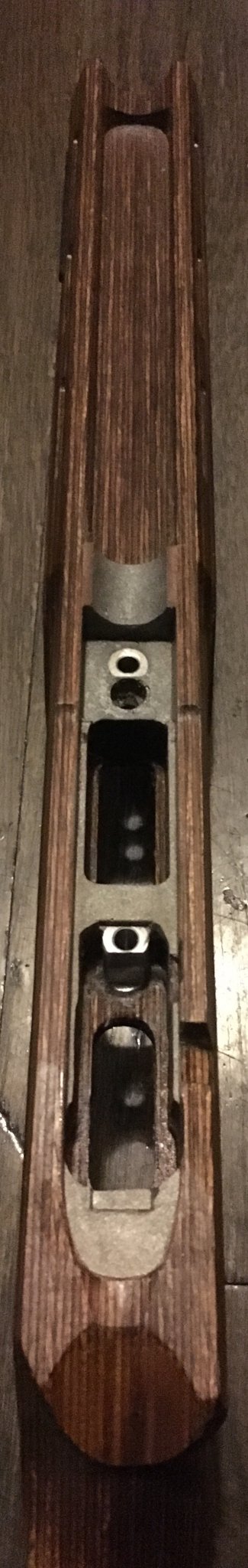

Pillar and glass bedding it will be a better fit than a pre machined block. The epoxy will be perfect fit all around the action. These ain’t for the occasional person who beds stock but anyone who is good at bedding a stock could do it with ease.
