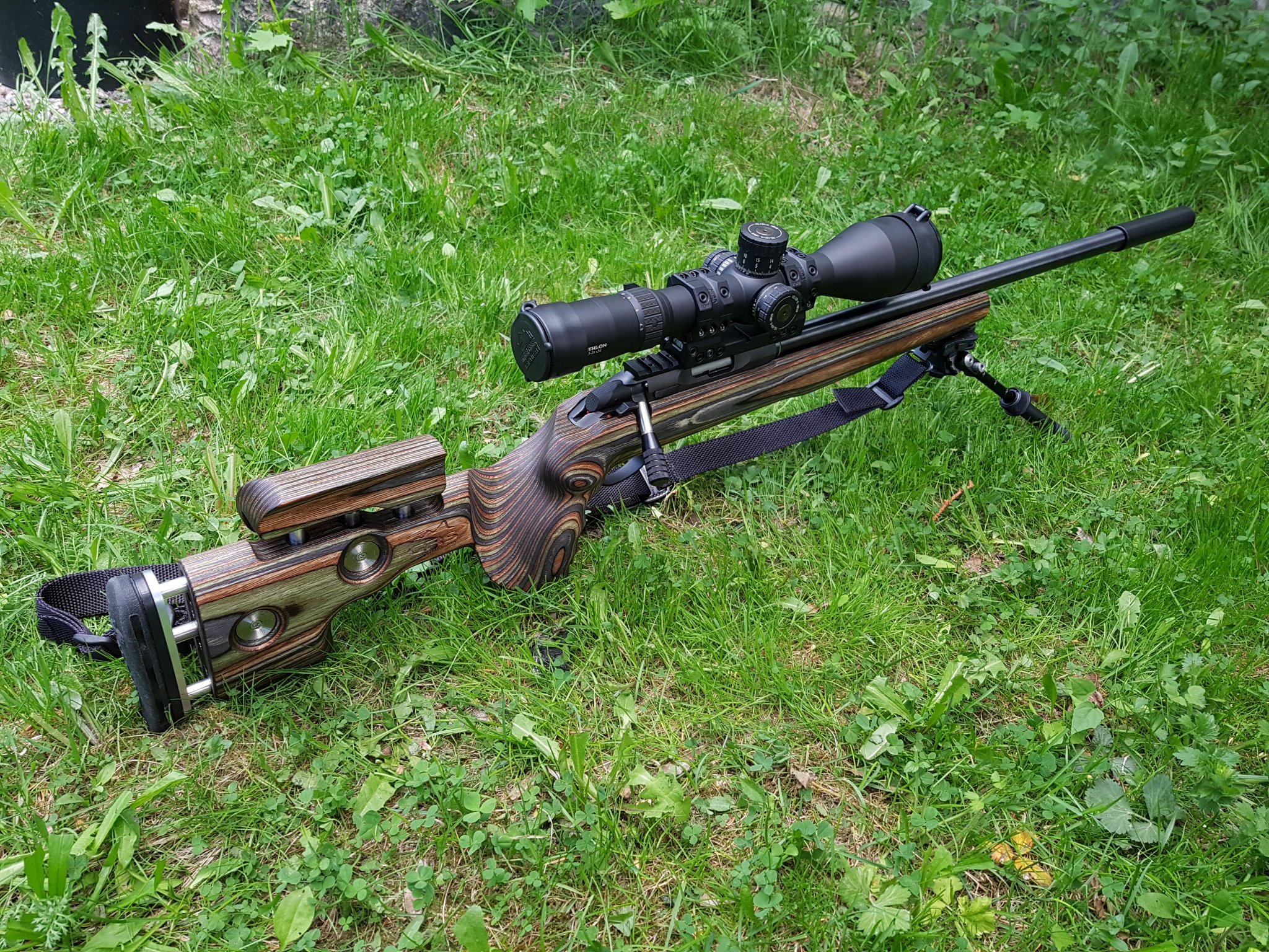

I'm 18 months late to the party, but for the edification of anyone interested in a McMillan or Manners for a (Sako) Quad I've distilled it down below pretty well. I had posted this a few years back on the RFC and The Sako Collector's Forum, but I'm not sure if I posted it here on Sniper's Hide so I grabbed the text of my Sako Collector's Forum post, updated it slightly, and pasted it below:
Manners still makes their T4 22 Trainer and inlets it for the Quad, but unfortunately (according to Manners), their T4A mold with KMW ACH (Adjustable Cheekpiece Hardware) isn't setup for the Quad. The workaround to this is to buy a T4 22 Trainer (non-adjustable cheekpiece), then send it to Joe Ducos ("jducos" here on the "new old" Hide' and Scout sites). Joe was formerly known on the old Sniper's Hide (pre-Scout) as "stockdoc"). Joe will expertly cut your T4's cheekpiece, install the KMW ACH, then patch and touch-up the stock. From what people who started-out with non-adjustable stocks say (both Manners and McMillan), Joe's work is very good, and their stocks look as if they came from the factory with the KMW ACH. I have no affiliation with Joe other than he's installed several Loggerhead ACHs' for me in McMillan stocks. As I type this, Joe's current contact info is:
Joe Ducos
5105 Montalbano Court
Salida, California 95368-9339
(209) 620-5268
[email protected]
NOTE THAT INSTALLATION OF THE KMW ACH IN STOCKS THAT AREN'T MOLDED IN TWO PIECES REQUIRES A LOT MORE WORK THAN STOCKS THAT COME MOLDED IN TWO PIECES, SO LEAD TIME AND LABOR COST FOR SUCH AN INSTALL WILL BE GREATER THAN FOR A STOCK THAT WAS MOLDED IN TWO PIECES. HOWEVER, THE KMW ACH UPGRADE IS WELL WORTH THE TIME AND EXPENSE!
I've never had Joe modify either a non-adjustable Manners or a non-adjustable McMillan for me, but I have had him install the KMW ACH (aka "Loggerhead") for me on a couple of McMillan A5s' and an A3-5 (molded as two [2] pieces). McMillan will not install the KMW ACH, but they will do most of the inletting for the KMW ACH install. The trick is that McMillan will only do the inletting on NEW STOCK ORDERS WHEN THE STOCK IS ORDERED AS AN ADJUSTABLE STOCK, AND VERY SPECIFIC ORDERING INSTRUCTIONS ARE REQUIRED TO ENSURE THAT THE STOCK IS ORDERED "JUST SO".
Basically, you order the stock (A2, A3, A3-5 A5, or HTG) as AN ADJUSTABLE STOCK, BUT SPECIFY "NO HARDWARE" SO MCMILLAN WILL MOLD THE STOCK IN TWO PIECES (THE MAIN PIECE, PLUS THE CHEEKPIECE ITSELF) BUT INSTALL "NO HARDWARE". YOU ALSO NEED TO SPECIFY "FULL GLASS - NO VOIDS, KMW INLET". McMillan will fill the stock with fiberglass so there are no voids, giving the best strength, and partially inlet for the KMW Hardware. Whoever installs the KMW ACH will complete the inletting prior to installing the KMW ACH. Side note: Those who really know McMillan tactical stocks know that the A3-5 is molded in two (2) pieces, so ALL A3-5 stocks are adjustable by default, you just have to specify which cheekpiece adjustment hardware they want. (In the case of the KMW ACH, you specify "NO HARDWARE, KMW INLET").
PLEASE NOTE THAT WHILE THE (MCMILLAN) A4 IS AVAILABLE MOLDED AS A TWO TWO-PIECE STOCK, UNLESS MCMILLAN UPDATED THEIR INLETTING PATTERNS FOR THE A4 THEY DO NOT INLET THE A4 FOR THE QUAD. (I VERIFIED ALL OF THE ABOVE WIT MCMILLAN 9/6/2016.
McMillan also inlets their "Sako Varmint" stock for the Quad, but McMillan doesn't have a two-piece mold for the Sako Varmint. McMillan doesn't offer an adjustable Sako Varmint because the cheekpiece tapers rather thin at the comb. If someone wants a Sako Varmint for their Quad and they want an adjustable cheekpiece they can call Joe Ducos and ask Joe if the newer KMW ACH will fit the Sako Varmint (I know it fits the HTG). As with any McMillan stock that you want the "Loggerhead" installed in, you'll have to send it to Joe Ducos to for customization and Loggerhead install.
As far as price goes, I spoke with Terry Cross at KMW himself the beginning of August 2016, and Terry told me himself that Joe charges 1/2 of what Terry will charge you. (Terry is, after all, a gunsmith and has other fish to fry). With COVID-19, that may have changed. Begining of August 2020 Joe Ducos quoted $250.00 (including hardware, installation, and return shipping) on a McMillan A3-5 (molded as two-pieces). Since that doesn't include shipping from you to Joe, add another $50.00 or so for shipping to Joe. Of course, you could always save some money on shipping by having McMillan ship your new stock directly to Joe Ducos, but I always want to receive and inspect the stock before modifying it (once modified, you own it), and it isn't inconceivable that McMillan could send you the wrong stock and/or said stock is defective and/or missing parts). If you have McMillan ship directly to Joe Ducos, you might not discover a problem in time.
Finally, McMillan's "Single Screw Clampbar" cheekpiece hardware functions and looks similar to the KMW ACH. However, there are definite differences that make the KMW ACH superior. (If you look at McMillan's "Single Screw Clampbar", you'll notice that the Clamp sits below flush in the Buttstock, and a large rectangular recess allows McMillan's non-flush cheekpiece hardware on the bottom of the cheekpiece to reside within the recess when the cheekpiece isn't raised-up). And unless they're filled-in, two (2) holes remain on the top of the cheekpiece from the hardware install where water and debris can enter the stock. With KMW ACH installs, there are two (2) holes on the bottom, which don't show. You can fill them in, but they allow water and debris to exit the stock so I leave them.
I love McMillan stocks (I have four), but their adjustable cheekpiece hardware setups just aren't as "clean" as the KMW ACH. Because of this I accept the extra steps and lead-time of ordering my adjustable stocks from McMillan as specified above, then shipping them to Joe Ducos to have Joe install the Loggerhead in them. I have three McMillans' with the KMW ACH in them, (two A5s' and one A3), and they are awesome. Below are four photos of my euroOptic Sako Quad Special Edition. Like my A5s', my A3 has McMillan's Spacer System LOP, KMW ACH, Machined-in Pillars, two Left Side Flush Cup Bases, and a 10" Anschutz Rail. Riding in the Anschutz Rail is an ACCU-SHOT BT28 Rail that I can attach picatinny type bipods to. The ADM (American Defense Manufacturing) AD-BP-P2 with KMW Pod-Loc in the photos below is excellent. I used to have Larue LT706+BRM-S bipods' with KMW Pod-Locs', but changed all of my picatinny mount Harris bipods' to ADM AD-BP-P2s' for ADM's tool less AutoLoc clamp.
euroOptic Sako Quad SE w/McMillan A3 Adj. w/KMW ACH, Spacer System LOP, 10" Anschutz Rail & ACCUSHOT BT28, LS Flush Cups:
