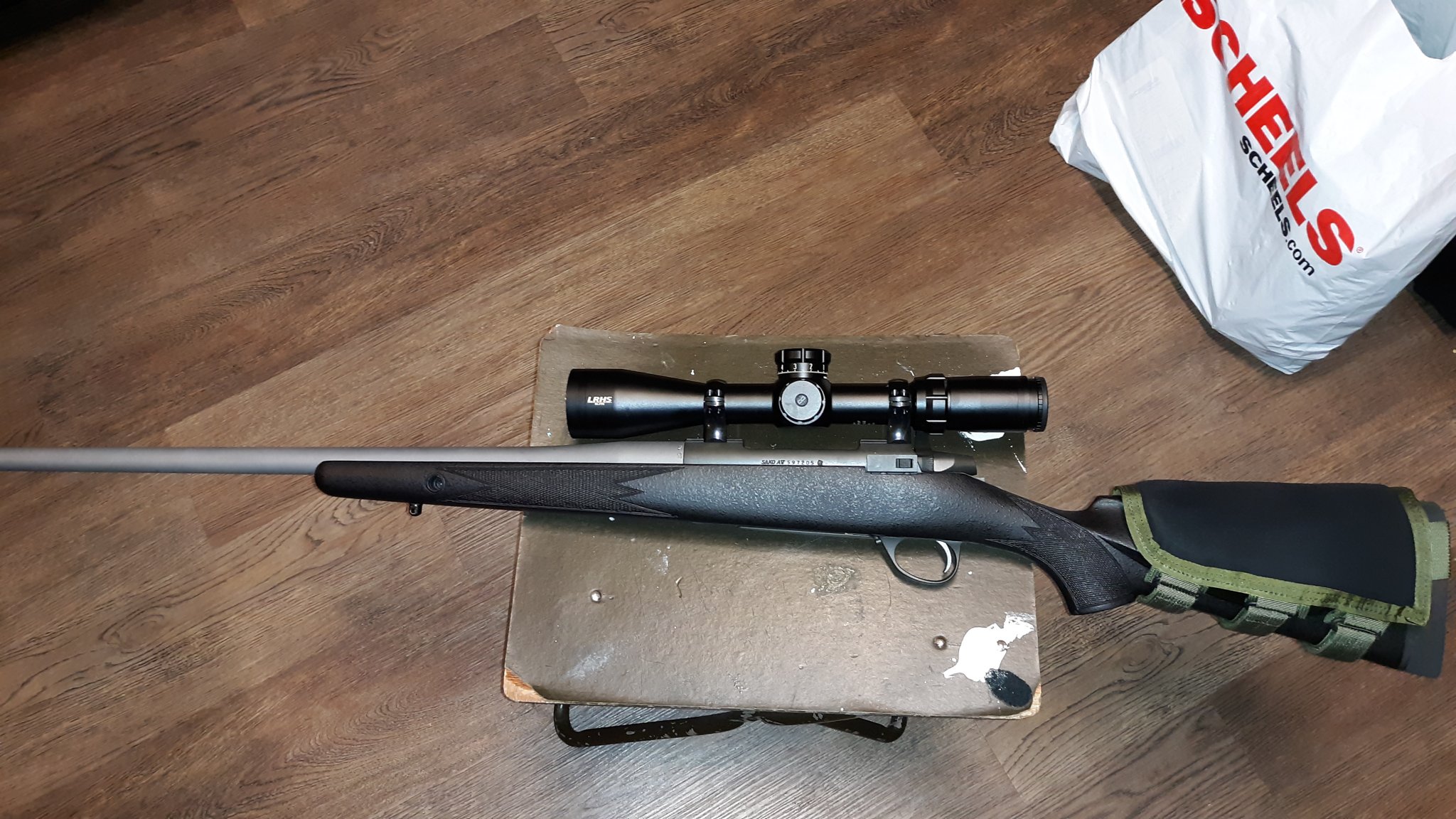

I bought a pair of Sako Optilock ring mounts, which are one piece, not two. Just got them today, thanks to a free trial of Amazon prime. $110...just mounted them up.
Not perfect, but I think they will work. They have the locating pin on the rear ringmount, but some guys grind that off to get some more leeway in ring placement, and I may end up doing that.
Could be a cunt hair lower...but not a big deal.
They use a polymer insert, that allows you to slide the front ring back and forth to get some windage adjustment.
They are also polished blue, while my rifle has been parkerized, and the Bartlien barrel was given a heavy bead blast finish.
Right now I'm fairly happy with them, if they shit the bed, I will revisit,
