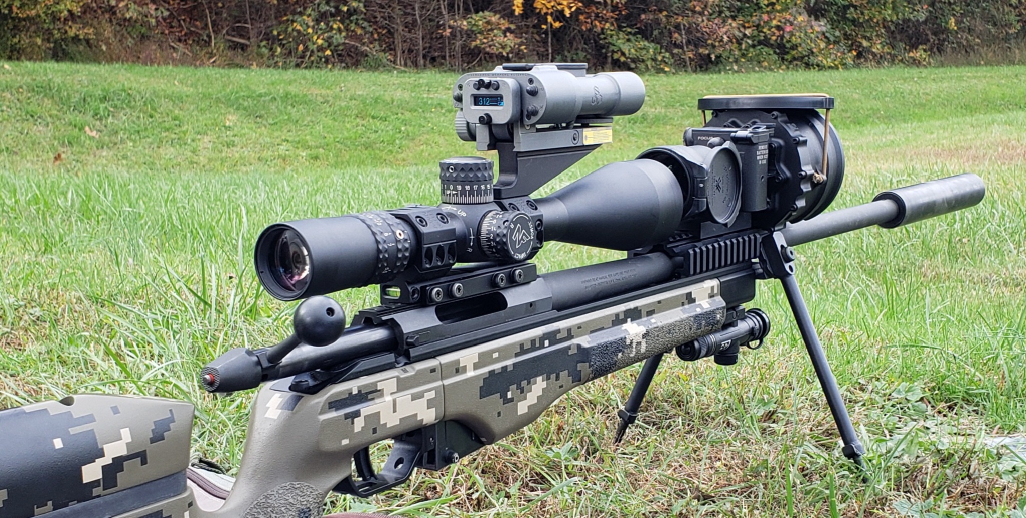

TRG-22 with integrated scope mount and extended ITRS
Spuhr receiver mounts (with a recoil lug) are very good. Pic rail gives more option for swapping scopes around, and not a lot of brands do TRG rail mounts. I tried one of the Sako 3 ring mounts and did not like. You need to twist/align the rings perfectly to prevent your scope from getting damaged.
ITRS works for mounting a Raduis LRF, but I found that I had to add a 1/8 inch "height" spacer to the side rail to be able to get it to lock into place, as otherwise the locking cam "toggle" would bind against stock forend. This was on a TRG-21, so may not be an issue with the -22 stock.
