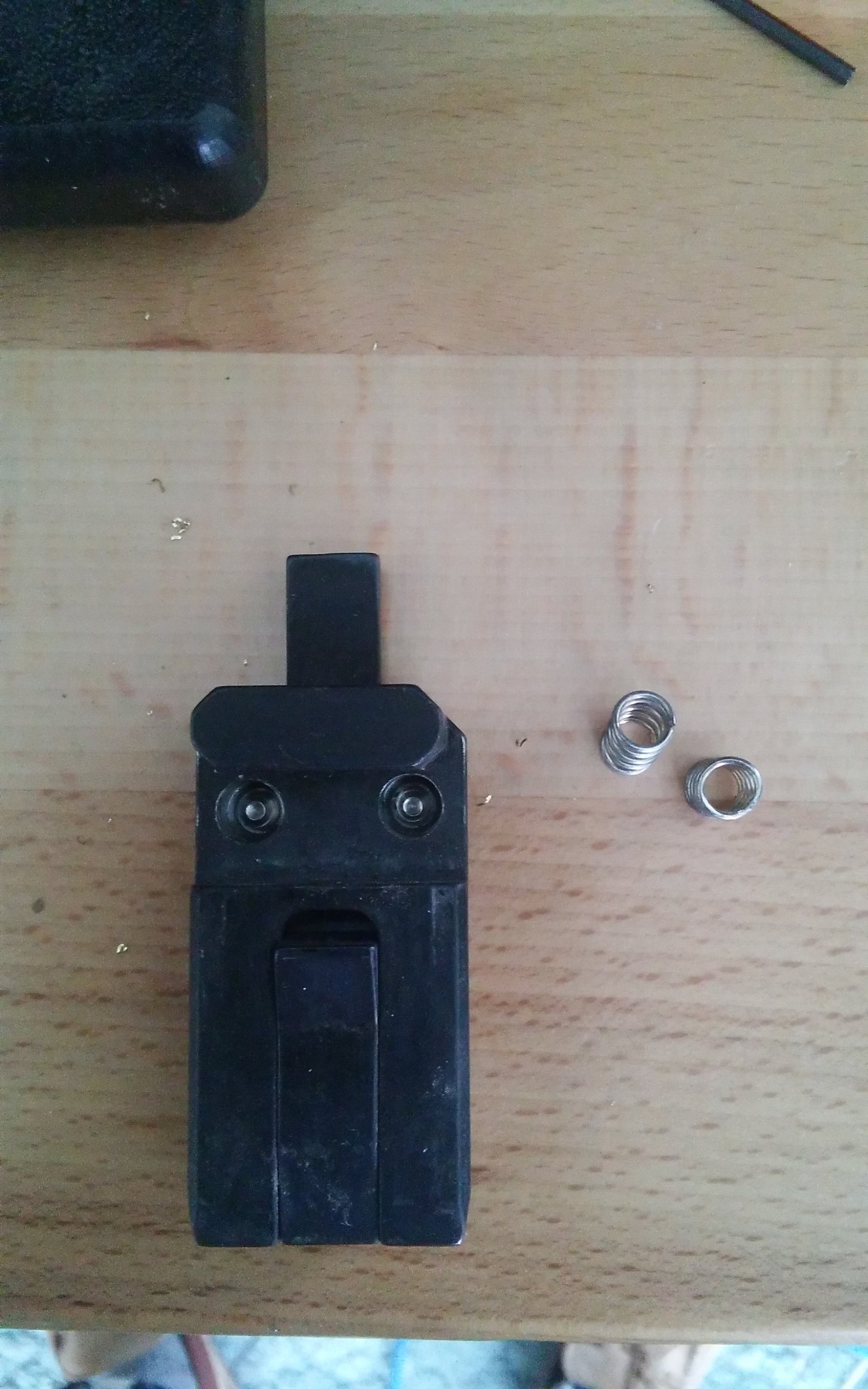

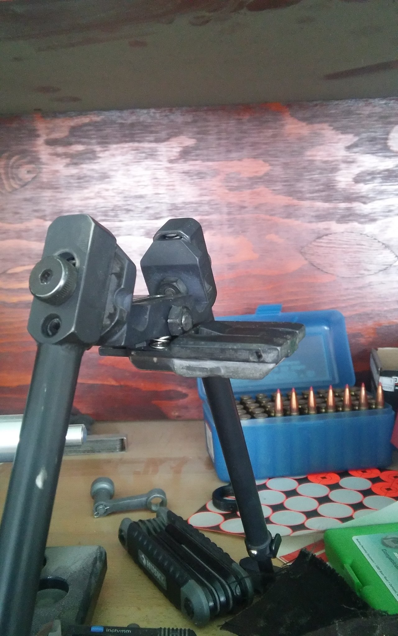

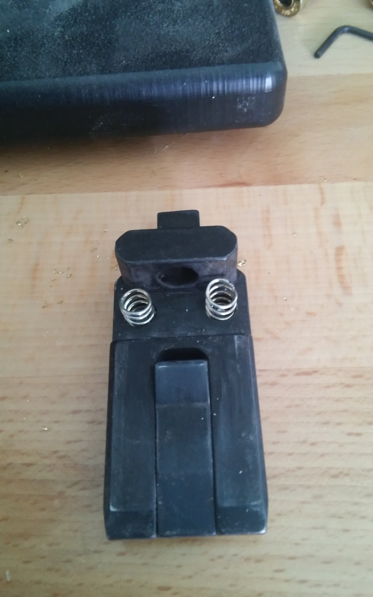

    I know exactly what your talking about. That floppy wobble drove me nuts so I took the bipod apart and drilled a recessed pocket on each side of the spickot and put short springs in the holes and reassembled. When you rotate it back and forth the leg body pushes against the spring and holds it rather snug. I actually used 2 springs per side, one smaller than the other and they nestle in together. I did this to get more spring restistance. Get the stiffest springs you can find. Works awesome and no range of motion loss. I also took liquid steel epoxy and built up the mating surfaces on the spickot and filed them down for a near precision fit when you plug it into the rifle. I spent many hours mulling over ideas to improve that bipod and I love the bipod now. I constantly tweak the trg to perfection. That was one of the best improvements.
    That’s a fantastic idea. Can you take pics of exactly where you drilled the holes by chance?
    Reactions: Bravo6
    That is a great idea. I'm going to see if a machinist mate of mine can do that.

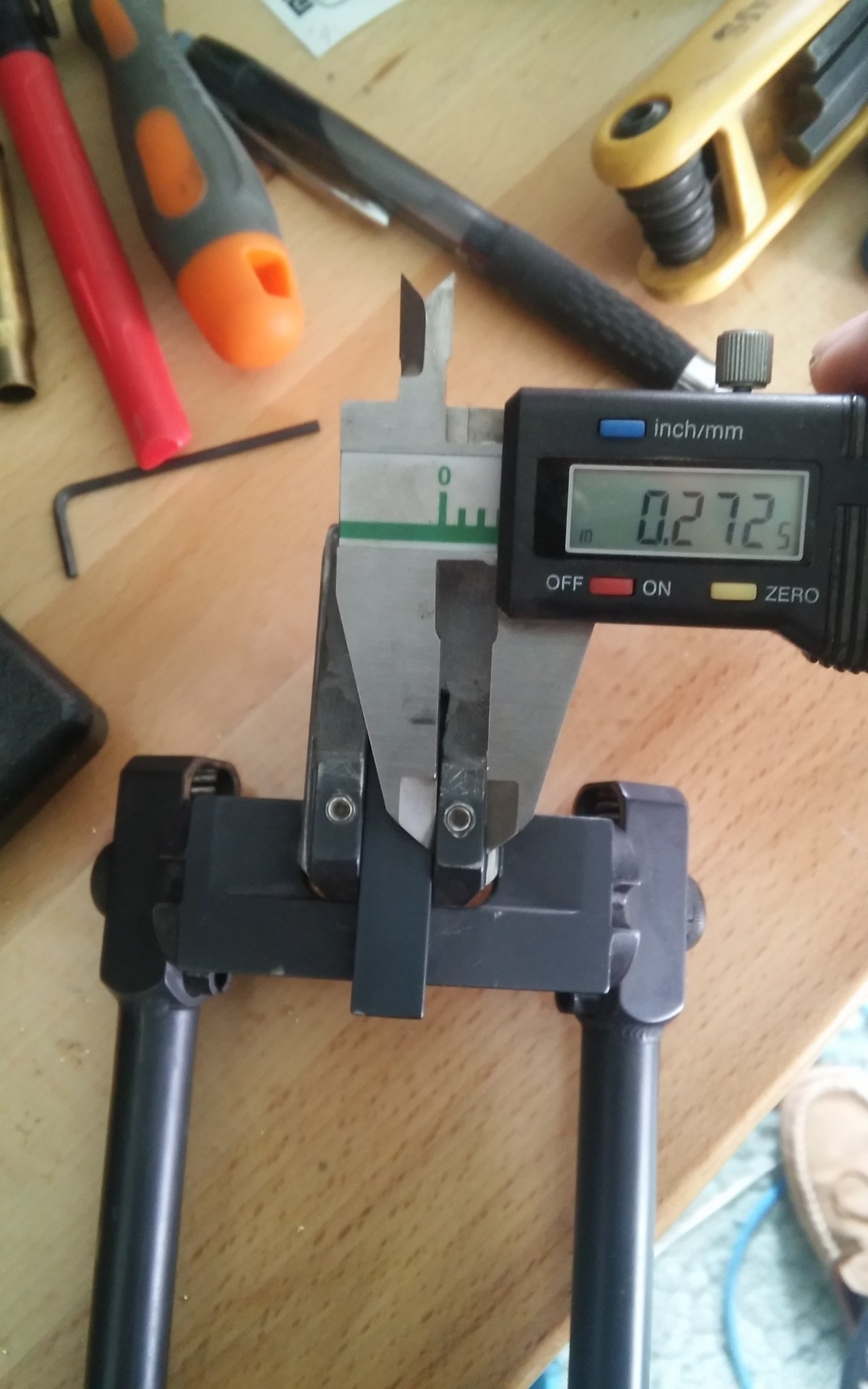

    Here you go. First I need to make a retraction, I only use one spring per side. I was remembering my first run at this. The springs are 1/4 diameter by 1/2 inch long. As thick a gauge as you can get. I started by drilling from the underside on the spickot so as to center the holes in those narrow rail guides shown at .27 of an inch. My initial holes were about a no.10 drill hole which I later tapped and put set screws in to fill the hole. These holes were for centering only. Then I came in from the top and drilled out 1/4 holes about 3/16 deep or so. I did this on a drill press so precision wasn't exact but very close. If I did it again, for piece of mind I'd do it on a mill and measure everything exact and just mill out 1/4" pockets from above. Make sure your pocket edges are just touching the pivot shank. It is imperative to get those holes centered left to right as you can see you only have .27" to drill a .25" hole. This by far was the simplest fix I came up with as well as extremely effective. Note the grey colored liquid steel I built up the spickot with to eliminate play when plugging into the rifle. This rifle is now extremely quiet. My next project will be some kind of spike to attach to the feet. They do like to slide.
