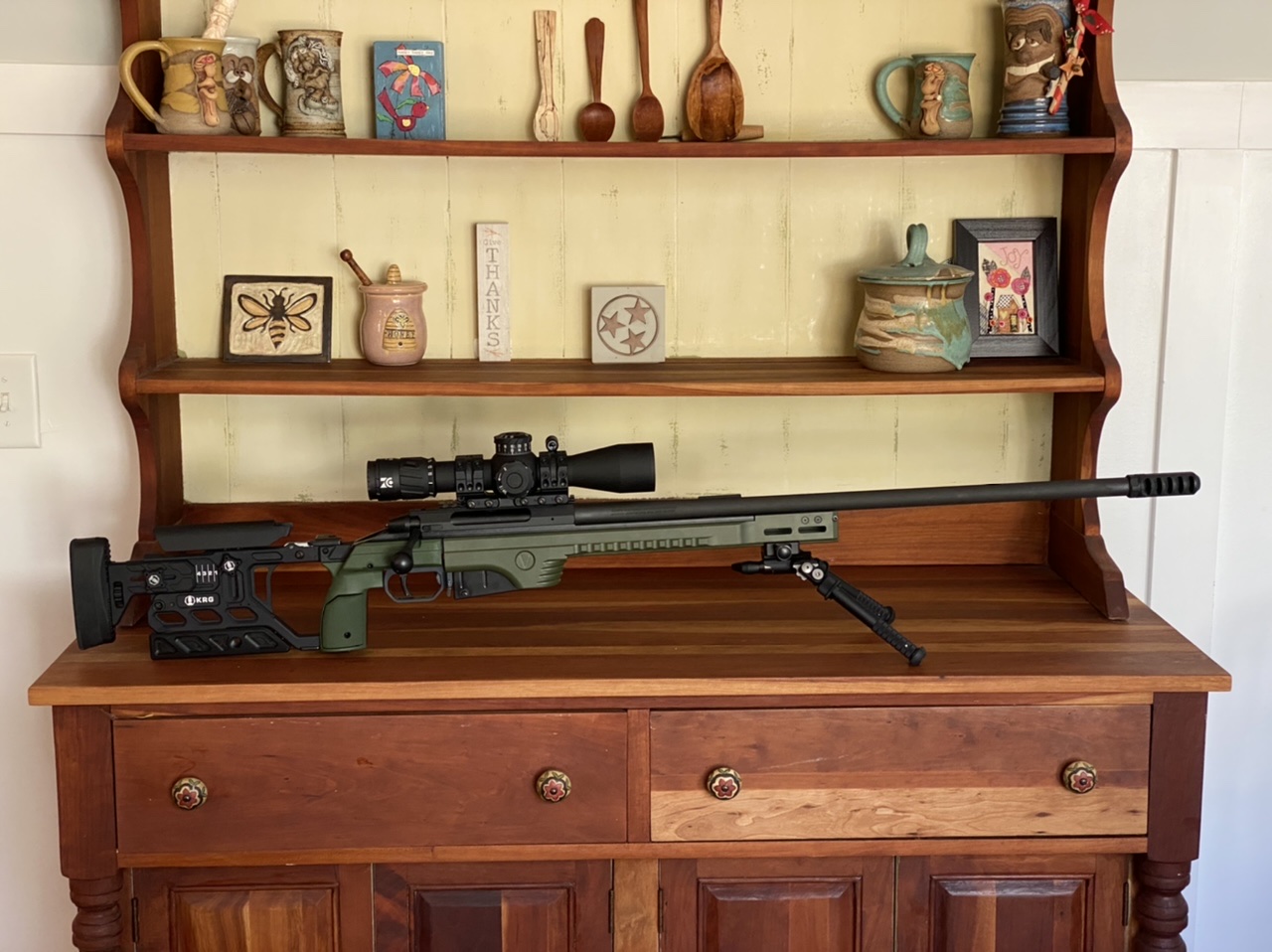

I put a Vision forend on my TRG 42 recently. I like the Arca capability. It seemed a little loose with the factory Sako TRG bipod. It clicked into the front mount but rocked more than I liked. It would probably work with some sort of shim.
I elected to use an Arca mount on an Atlas bipod. I still need to paint the plastic grip on the KRG folding stock for the TRG to match.
Reactions: VargmatII and CiPo
View attachment 7845878I put a Vision forend on my TRG 42 recently. I like the Arca capability. It seemed a little loose with the factory Sako TRG bipod. It clicked into the front mount but rocked more than I liked. It would probably work with some sort of shim.

There are three versions that I am aware off. The first version has the wider stance. The second is like the current version but without the cutout for the bushing that tensions the side to side cant.
I actually really like the looks and function of the vision forend. Unfortunately I was told they are not making them for the trg any more. You would have to buy the full chassis from them.
Like posted above you could just kill down the sides for the barrel for clearance.

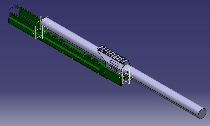

Rev 1.
I'll show only the bottom since i've not figured out how to machine the interior.
There will be a lot of weight reduction, final weight goal is near 800 grams.
Machined from 6082 T6, clear anodized and cerakoted.
Next steps:
- design review of bottom section for ease of machining
- final design of inner section
- still undecided for mlok on the sides, maybe i'll leave space for a couple of slots
- integrated front qd vs add on...

For two reasons. It will be difficult to create space for mlok interface without ergonomic compromises and there will be enough internal space for weights.
Mainly for the first reason.
In addiction mlok maximum thickness is a major limitation for stiffness.
