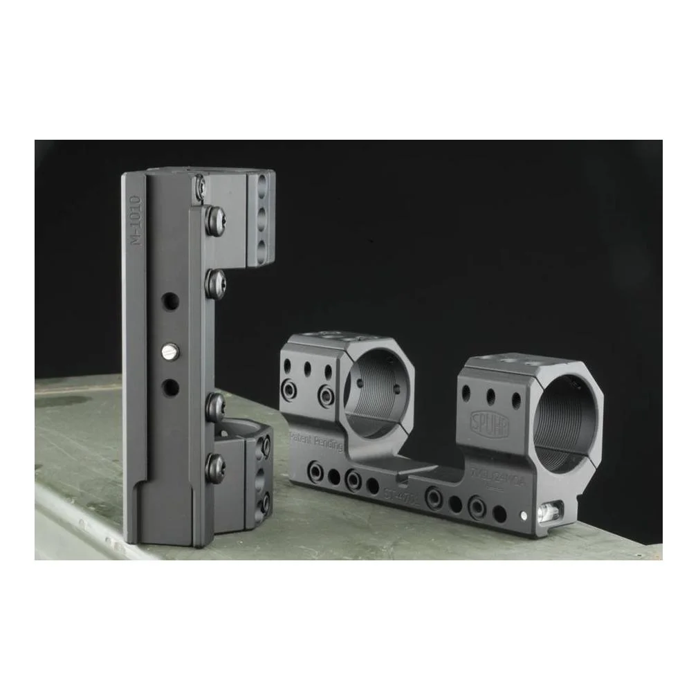

A direct mounted Spuhr 4701 that fits to the dovetail of the action is the way to go on the TRG.
I ran that setup for over 3 years and it never failed.
You dont use a cantilever mount for a TRG so forgett about that part.
If you decide to keep the picatinny you can run a Spuhr 4001 mount instead.
Oh so the dovetales locks to a single position? I thought it was a rail and so would require recalibration on each switch. If not - then that is what I will do, thanks!
Is that the KRG folding stock on the picture? That one is included in the package I got, what are your thoughts on it?
The mount has a recoilstop that is adjustable, the mount in the picture is an old generation but it works the same. It is 100% repeatable in my experience.
