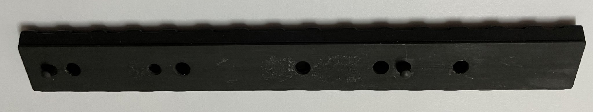

The factory rail on my TRG has two locating pins and was glued to the action, it took a fair amount of heat from a heat gun to remove it. The first pin in the picture below is aprox. 7.5 mm from the left end of the rail and the second is aprox. 107.5 mm from the left end (so aprox. 100 mm from the center of one pin to the center of the other)

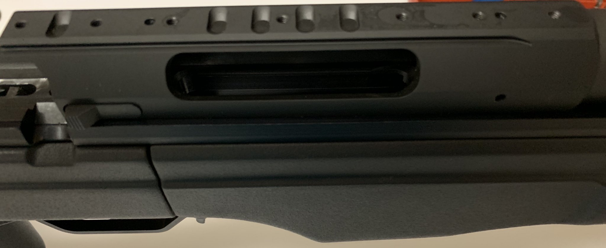

Here’s the rail and the top of the receiver.
