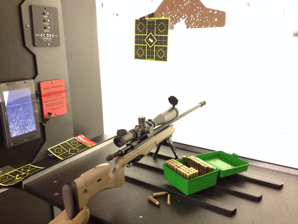

This is what we did with 24 boxes of Hornady, ogive sorted them and pointed them with Whidden's bullet pointer. We then weight sort them into groups and found them vary wider than the Berger or SMK. We have Marc Soulie of Spartan Precision Rifle chambered 2 barrels with Pacific Tool and Gauge 338 Lapua Magnum Tactical Match reamer. This have a slower entry and more flexible for our loading. The load development sessions were tedious, we started with CIP magazine length, but we settle with single loading length for we want max speed for the class. We start the testing from 92 grain Retumbo with bullet touching land and went up .5 grain till we found the speed we want. The two barrels shot 1/4" to 3/4" groups at 100 yards with just about anything we put through it. I wished I can do more testing with longer distance. We found that the most consistence and lowest SD seating length with 96.0 grain of Retumbo is between 3.049" to 3.051" cartridge base to ogive (0.330" gauge diameter). The heavy varmint profile barrels are 28" Bartlein 5R, 1 in 9.5" twist, and 30" Kreiger, 1 in 9" twist. The load give us 2930 fps for the 28" tube and 2980 fps for the 30" tube. Our original intension was to shoot the 300 grain Berger and have the faster twist for that bullet.
