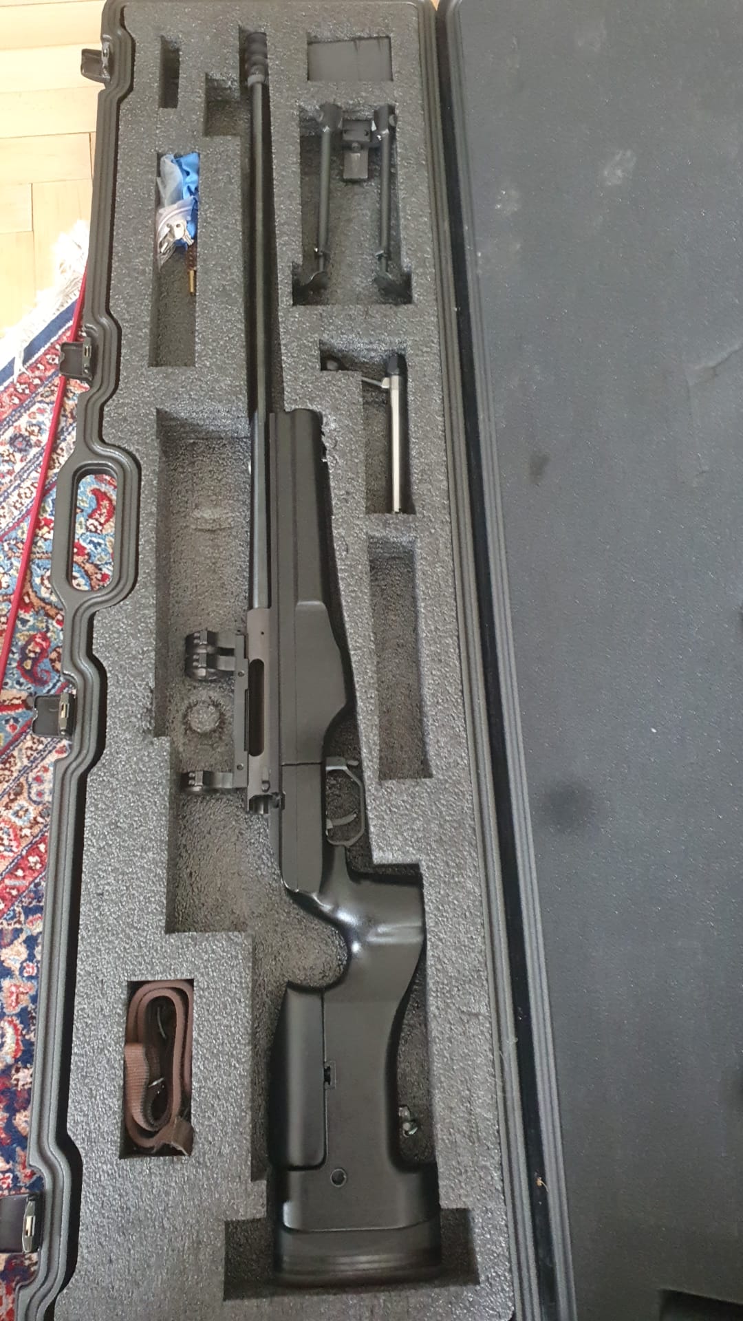

Hi guys,
I've got a possible deal on a used Sako TRG 42 in 338LM, coming with trg 30moa 34mm mount, trg bipod, trg muzzle break, sling and case like in the picture below. The rifle shot about 150 rounds. That's for the great part.
For the "short comings":
  • The riffle is a pre-2009 model, which means:
    • Barrel with 1:12 twist rate (so bullets are limited to 250 grains, it won't stabilize heavier ones) / changing the barrel would cost me approx $2500 USD at brownells
      EDIT: I'd especially like comment on this point, for people with much more experience than mine, how much is the inability to stabilize heavy weight bullet going to affect my goals? Is this point sufficient to make this riffle a pass, or should I take it anyway?
    • old trigger (here's what they changed in 2013: "This new mechanism ensures improved safety measures in case the rifle is accidentally dropped. It also features a new safety lever, which is ergonomically positioned and designed to make it faster and more convenient to use. The TRG 22/42 bolt handle attachment has been improved to withstand even the roughest handling")
    • single ejector on the action (change in 2013 : "The TRG 42 2013 update introduced new double plungers. These make frequent cartridge ejection even more seamless.")
    • Old recoil pads on the stock (change in 2013: "...2013 update introduced an improved recoil pad. This updated pad has refined material to reduce the feel of recoil, allowing for better control and recovery.")
  • The bipod doesn't hold very well (it seems like a known issue, I've found other thread where this happens brand new. I've checked the base rail and a little bit of paint gone but it's otherwise not damaged / used)
  • It's the black stock (non-stealth), blued barrel with no surface treatment on the stock version. My country's military use the green stock with phosphated metal finish (so the barrel and some other parts, such as the bolt) and blued action.
    Of course, I would have much preferred the green phosphated version, and so do most persons interested in a TRG 42 where I live, so if at some point I want to sell this one just the color will be a handicap.
The price for everything: the equivalent to $3025 USD tax included in local currency (the naked riffle, new with green stock phosphated metal parts, no accessories comes at about $6500 USD, tax included here)
The planned usage: long range shooting (from 800 yards to ideally, on occasion, past a mile, where the 300gr would have been very welcome), and on use for game where something bigger than 308 is usually advised, such as elk.
What do you guys think, should I take it, or should I pass and save up for a brand new one?
Regards

The pre -13 trigger is considered better than the post. Just don't adjust it too light.
The color is just paint.
The phosphated barrel is just only that and it has an notch for peep sights.
The action is phosphated on both.
The bolt handle should not be a problem unless you intend to break it.
The but pad is thicker, yes. But replacements are available as sako original part or from a Tikka Tac A1. Same shape. Same hole spacing.
Dual plunger is possible to install but IMHO not needed for civilian use.
So. Ceracote the things you want black and paint the stock green. The rifle will perform regardless.
As for price.
The scope mount is kind of meh compared to a Spuhr, but good enough. Brake and bipod is worth about $400 used where I live (I'm not in the US). If it is a Sako case it is quite pricey too.
You will use a lot of money on ammo so what you pay for the rifle is kind of secondary.

It's the same as my rifle except I have green plastic.
I'd say that's a VERY fair price considering the entire package and such little use. I think I bought mine off this sight maybe 15 years ago.
I typically shoot Lapua and Sierra 250s (by choice) but have also shot 300-grain Sierra, Berger, and Lapua Scenars with no problem.
Balance how much you're going to shoot it by how much you want to spend.
BLUF: I would buy that.
I have a TRG-42 in .338L and a TRG-22 in .308.
You could put a Bartlein or Krieger barrel in there for roughly $1000 it might be more now but not by much.
You can paint or have it painted and it doesn't cost that much.
The trigger isn't an issue or I have not had any issues with it and I have used it packing in Alaska TRG-42. Only issue I can think of is that the factory did not Loctite the trigger set screws. On my TRG-22 those walked a little and I lost my 1st stage. I reset the trigger and haven't had any issues.
Both my TRG-22 and 42 have the old triggers and some people do not like the newer triggers.
I have no extraction problems on my TRG-42, the TRG-22 is a little light but works just fine and at the range drops the brass on the table so I am not looking everywhere to find my brass.
I really like the factory bipod, I bought an improved role pin (I believe the heat treat was off on the factory bipod role pin) to replace the factory one which is what broke with my TRG-42 use. Cost me about $5 with shipping and a giant baggy of role pins. If you are in need I can try to find my big ass bag of role pins and send you one or two.
