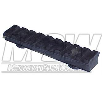

Looks like it just mounts in the T slot groove on the bottom. Could really attach any pic rail down there then with some screws and t nuts and it would be cheaper than that!
There’s the option of Sako’s S151F926 Forend Accessory Rail for non-Sako Bipods, it isn’t cheap (what from Sako is) but works great.
No. This is the right solution...
Standard MOE rail. Pick one up wherever or order the aluminum one.
